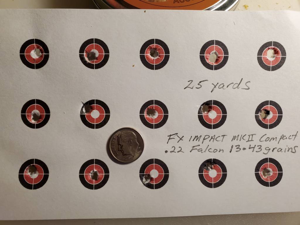

13.43g Pellet Results in my FX Impact Compact

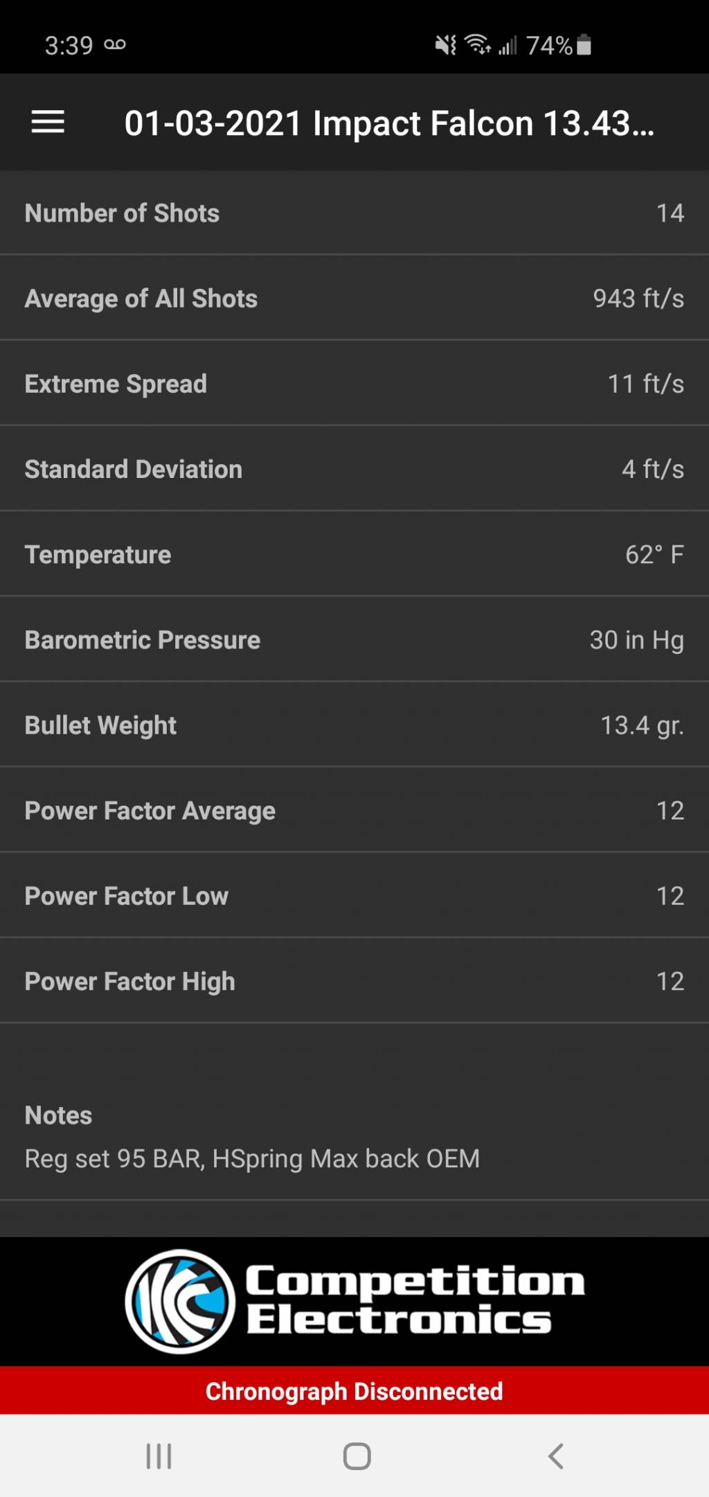

I wanted a lightweight pellet that would perform in my .22 Impact MKII Compact without adjusting any of the gun's settings. I mostly shoot in my back yard at ranges under 30 yards. This pellet was outstanding.
  • Falcon 13.4 grains caliber .22
  • 14 shots
  • 943 fps average velocity
  • 11 fps extreme spread
  • 4 fps standard deviation
  • under 1/4" center to center at 25 yards
  • (for reference my Impact shoots JSB 18.3g at 830 fps and Hades at 888 fps at same settings)
  • .22 FX Impact MKII Compact, 500mm barrel, Ronin moderator

That looks really good! Hot lead at 940fps and accuracy to boot.
I’m curious, what do you like about them over the 18.1gr? Are they giving you better accuracy at this modest distance?

Whats your reg pressure? and how many shots do you get per full fill?
  • 95 PSI on the reg
  • 4 magazines or about 110 shots

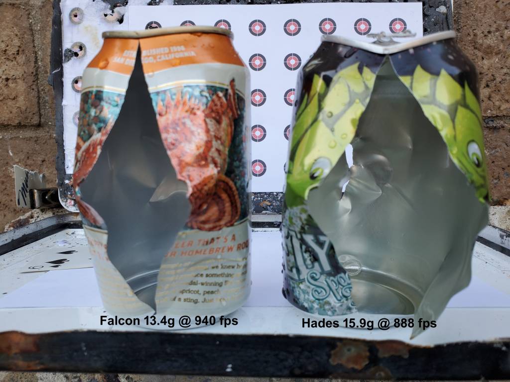

I did compare the Falcon 13.4g pellet to a pellet with a different shape, the Hades 15.9g. In my observations the Hades at 888 fps popped fruit and water cans with more authority than the lighter, domed pellet. Pictured below is one test (very unscientific but fun) I conducted using two beer cans filled with water. The one on the right was hit by the Hades and "exploded" more loudly and deformed much more that the other hit by the Falcon.

Okay thanks for the pictures. Looking at the water can example, it makes sense that the Hades may perform better because of its blunt head profile.

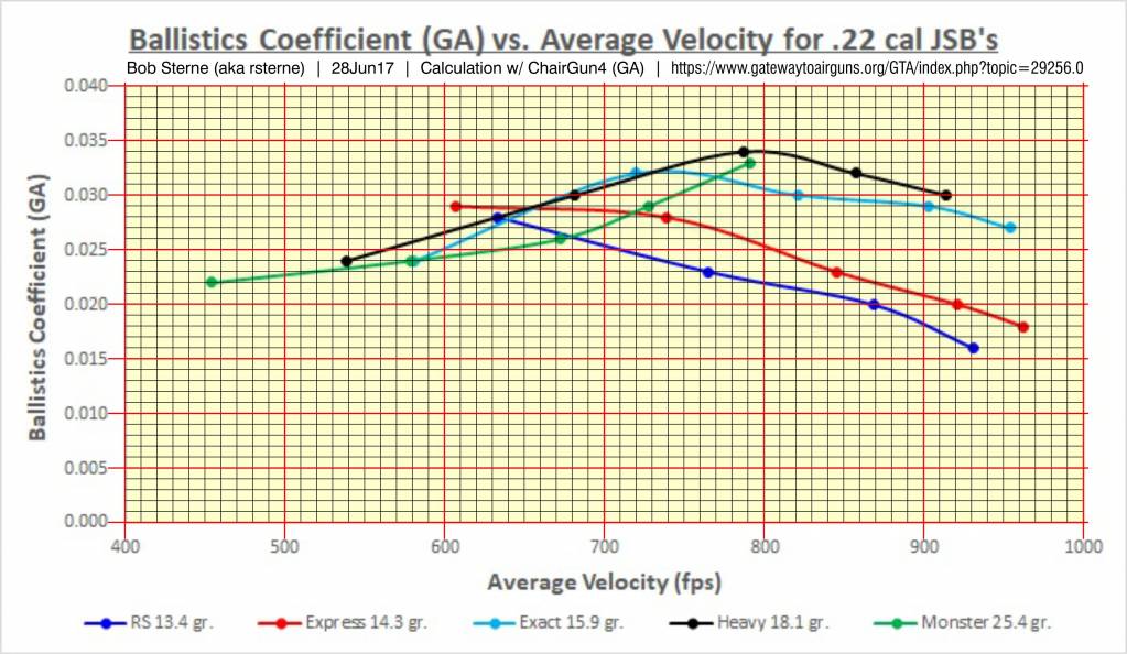

Find attached another BC test, done by Bob Sterne over at GTA — showing how BC is not constant with velocity.
And how lighter pellets have a higher BC at lower velocities, and heavier at higher velocities — all valid for JSB domed pellets .22cal under the test conditions.
I keep going back to this chart frequently, it has huge implications. 😊👍🏼

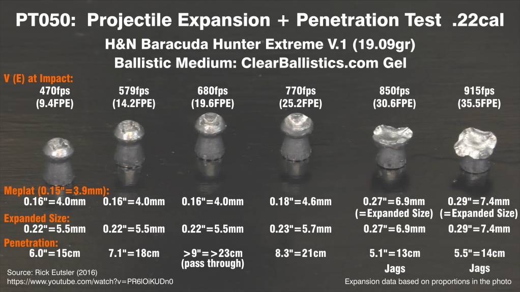

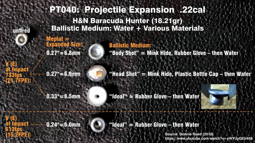

I promise I will turn your .22cal data into a pic like the one below, and put it on the forum — so we have a better idea of the true hollow point expansion of the Hades at different impact velocities. 😊
Matthias
Projectile Tests. PT040.  Donnie Reed 2018. -Water, also with Mink Hide  with Bottle Cap.- 17,...jpg
Projectile Tests. PT050.  Rick Eutsler AirGunWeb 2016. -ClearBallistics.com Gel.- 936FPE. Bc H...jpg

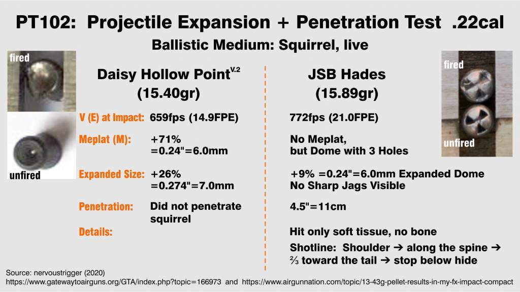

I take it that the range of the Hades and the Daisy HP in the pic above were both at 30y?
🔶About the Daisy HP expansion
Comparing hollow points with similar shape and/or weight I estimate the Daisy HP has a BC of about 0.018. Wished I had some firmer data for it, but for good reliable BC data it seems at least about 15 chrono velocities at range are needed (besides a reliable MV). A Labradar would be nice.... 😊
Anyhow: At a 22FPE ME the pellet must have hit your quarry at around 650 (14.5FPE). Now that's a marginally slow impact velocity for HP expansion.
Nevertheless, you still got the Daisy HP to expand by 0.052" (=1.4mm). I would consider that quite good, especially since the HP cup also expanded making the meplat larger ➔ which crushes more tissue in its way through the quarry. 👍🏼
