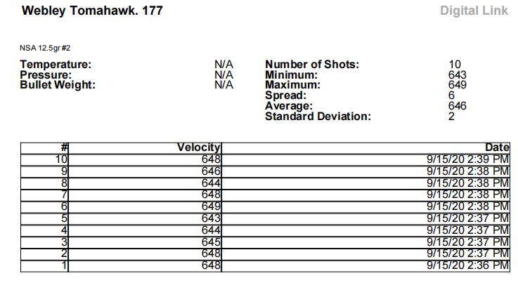

Slugs in question were the new NSA 12.5gr 178's. I figured ok, 4 grains heavier, should park fps in the low to mid 700's. Here's the chrony numbers. Upper target was trying to sight in, lower target was about 15 shots.

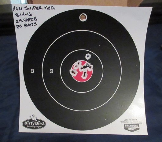

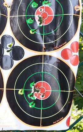

Compare that to the target shot with the Sniper Mediums, 5 yards farther out and 20 shots. Your mileage may vary depending on the rifle used but at l
east with the Tommy, I think I'll stick with the Snipers although it also shoots the RWS R10 Match Heavy pellets very well too.
Tommy with the Sniper Mediums:
Tommy with the R10 Match Heavies:
