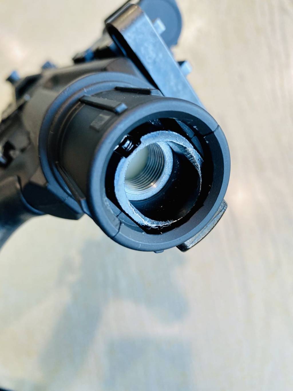

I got the Umarex one for mine. Think it is no longer available but just as well. The threads are a little to short and required slight modification to gun to fit. I seen a couple months ago there is one made to exact fit the MPX but can't remember where I saw it.

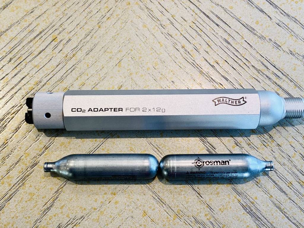

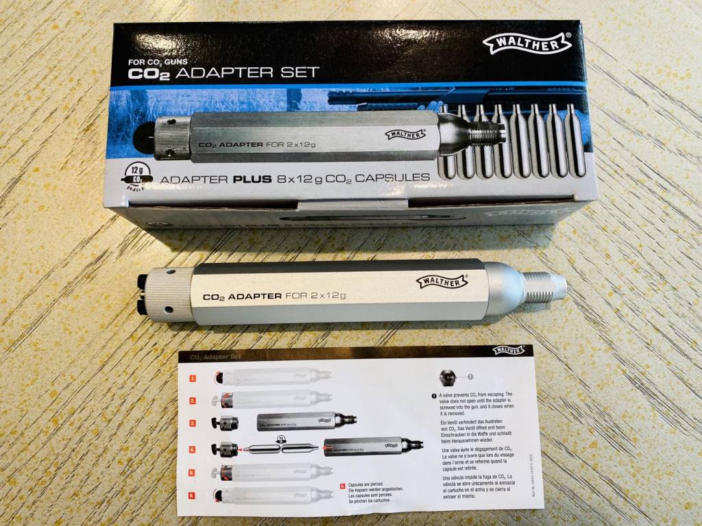

Try to search Co2 Adaptor Walther or Umarex CO2 Adapter. As shoot44 said it needs some modification to fit MPX/MCX. With 2 12g cartridges I can go two mags, that's 60 shots no problems. Using the small loading tool which comes with MPX can almost eliminate jamming. I just fund a link looks like still in stock(Canada): Umarex 2X12-Gram CO2 Adapter For Air Rifles
How does it work with two cartridges? I having trouble picturing it
That would work. How do they install? I can't picture how to in-line cartridges function.
The second picture in post #3. They insert with each cartridge end facing outward. When the cap is tightened each end of the adapter pierces one cartridge.
Edit: zoom the first picture. It has instructions as well.
