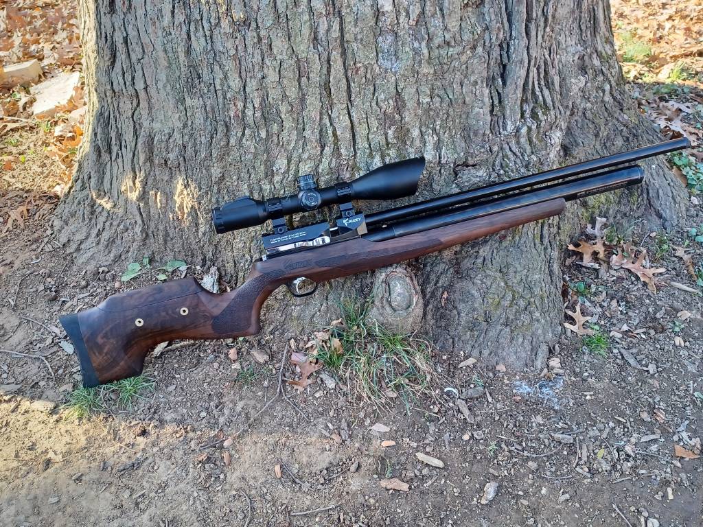

My Kuzey guns should do that. 330cc tube. Pop in a reg and a little tuning and should be there all day. Gorgeous walnut wood. Thebestairgun.com

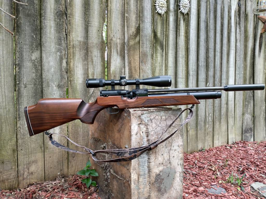

Thats the kind if beautiful gun I'm talking about!!!
Thats a really early HW100 from 2004. Rifle length tube, and a 12fpe spec-length 410mm barrel. The current FAC guns will have the same cylinder, but longer 500mm barrel. If you buy new, it would be worth it to buy a dedicated 12fpe gun from Krale to get the shorter barrel.
Thats a Ratworks aluminum cylinder to save weight, and a Lothar Walther barrel with a modified barrel band.
