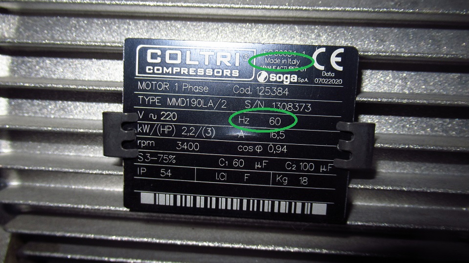

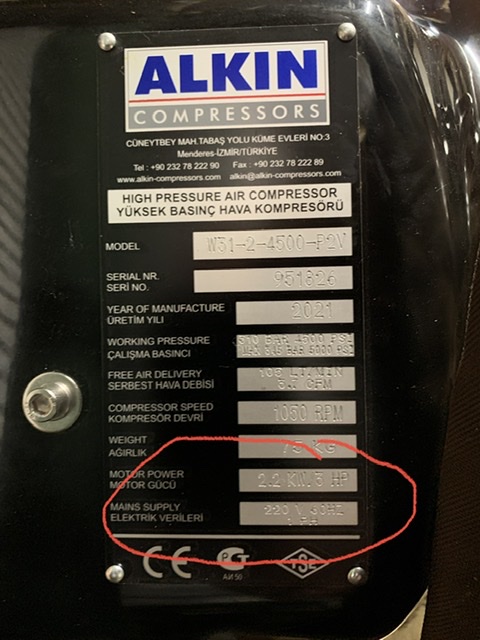

You don't want to buy a device meant for use in Europe and use it in the U. S. (or vice versa). US power is 60 Hz and Europe is 50 Hz. Any synchronous motor will not run properly and may not run at all just due to the frequency difference. European 230V power is single phase, line to ground, like US 120V. US 220V power is line to line power - two hots, typically black and red, not line to ground. So the voltage is more different than it might appear.
