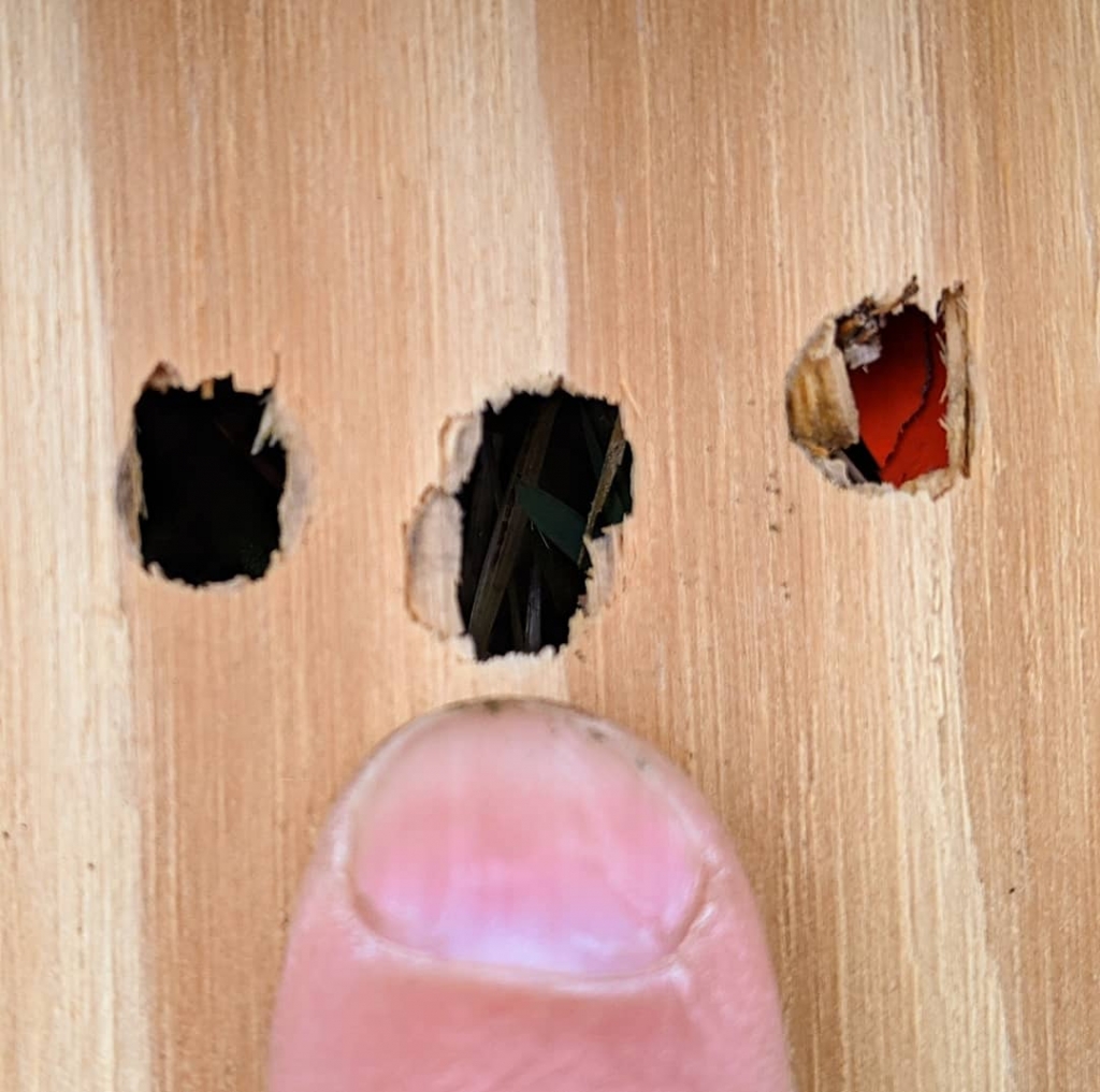

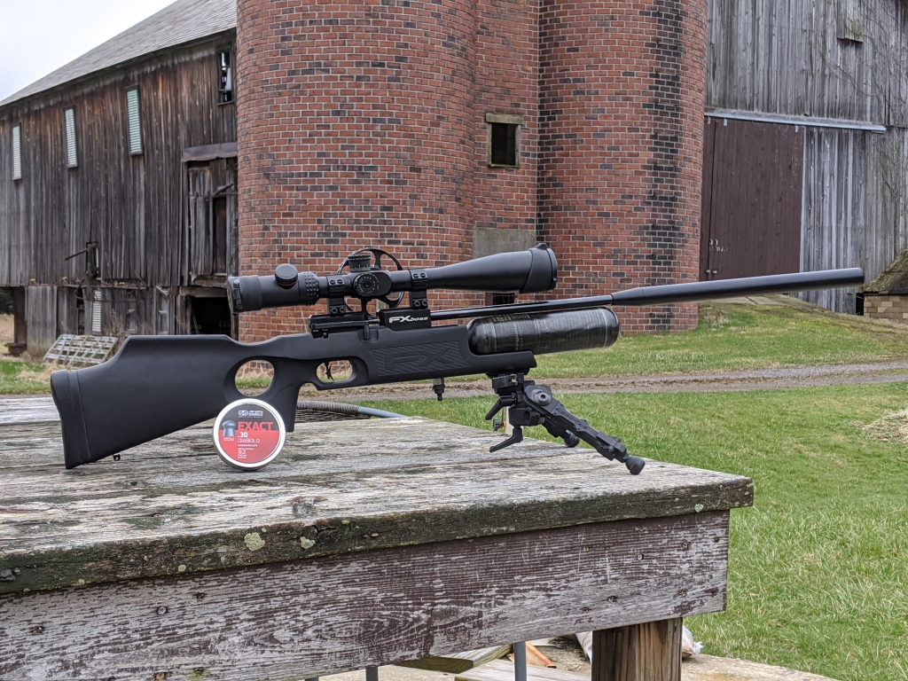

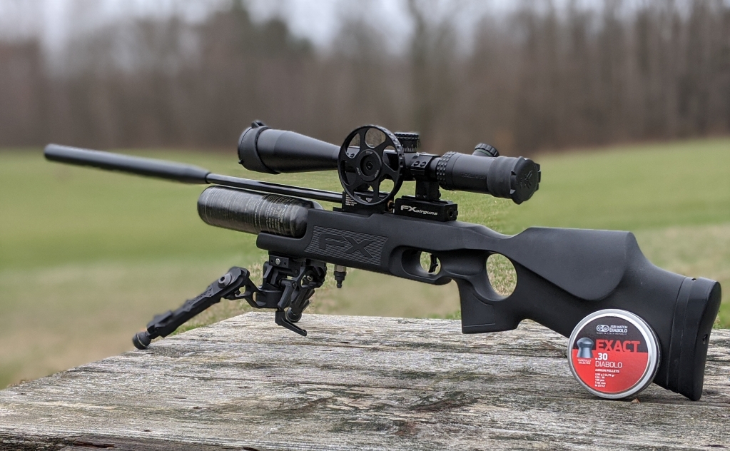

Here's a 4 shot group from my FX Boss yesterday at 100 yds.
I think most importantly is having a rangefinder and knowing how far your target is and having a good dope sheet
@kdog Keith, what happened to the 5th shot? ;) Nice shooting... Those Boss/Bobcat platforms are timeless, and as good as anything currently produced...
@likkitysplyt Everyone would like to have hole in hole at 100 yards, but that's pretty much an unreasonable expectation unless you're shooting indoors with your rifle clamped in a heavy rest.  I'd say generally MOA is about as good as it gets on average from the very best of guns... IMHO
I knew that was coming lol. Actually I had it sighted in at 50yds. On about a 12"x12" piece of paper....I moved it out to 100yds and just figured my holdover would be about 2 mil at 10x on my scope. So I start shooting at 100yds useing 2 mil holdover a d couldn't hit the paper and had no idea where I was hitting. Well I was running out of air and didn't bring my tank so I found a big piece of plywood and shot at that and found out I needed to be at 4 mil holdover at 100yds. These 4 shots were on that plywood as I was trying to find where I was hitting. After these 4 shots I was at about 125bar a d starting to drop every shot. So that's kinda why it's.a.4 shot group. Didn't plan on shooting it alot that day.
