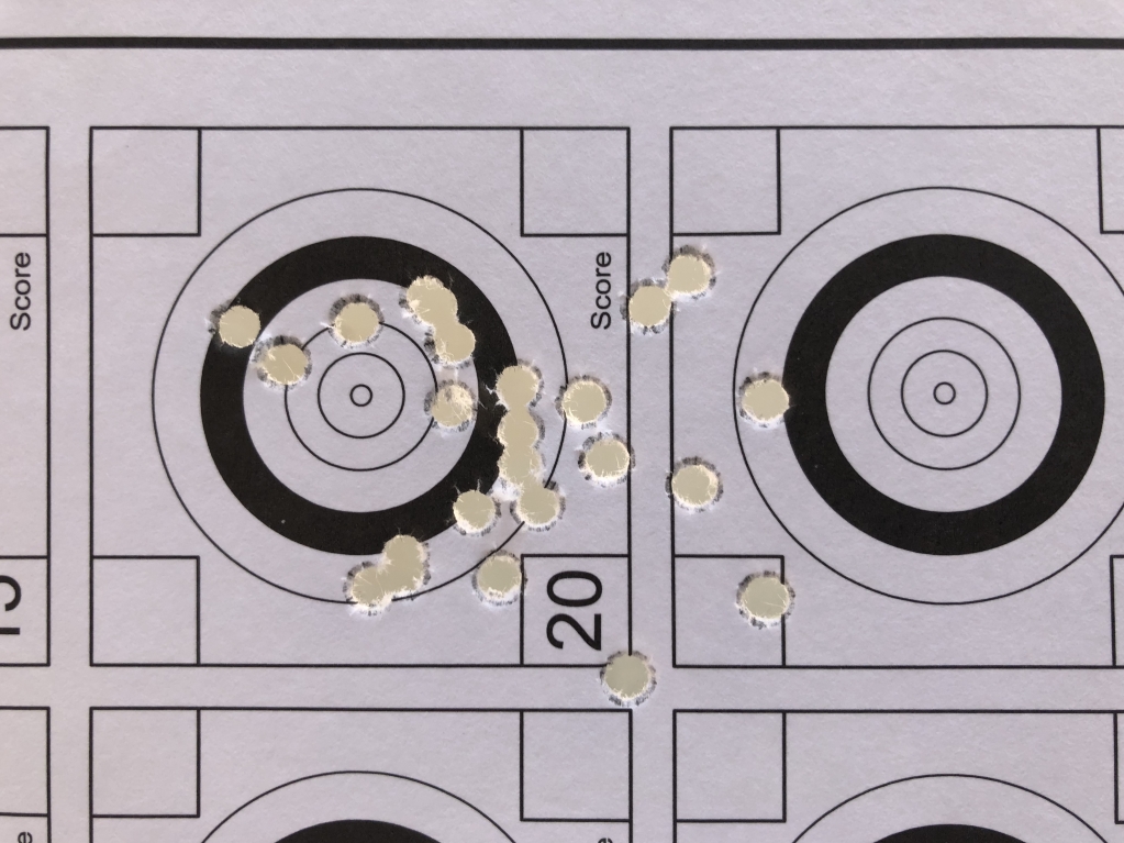

Here is the same 22 barrel shooting some 24.8 Nielsen slugs at 910. The first thing I noticed was the really clean holes these things leave. Would be nice to score those vs pellets. The outside of the black ring is about 1.175”. It was 16-22mph wind...so they are not too bad. The 20.2 gr shot similar groups. I didn’t shoot that many as it was 93 degrees out and the heavy wind was playing hell with my shade umbrella. This was at 100y.
