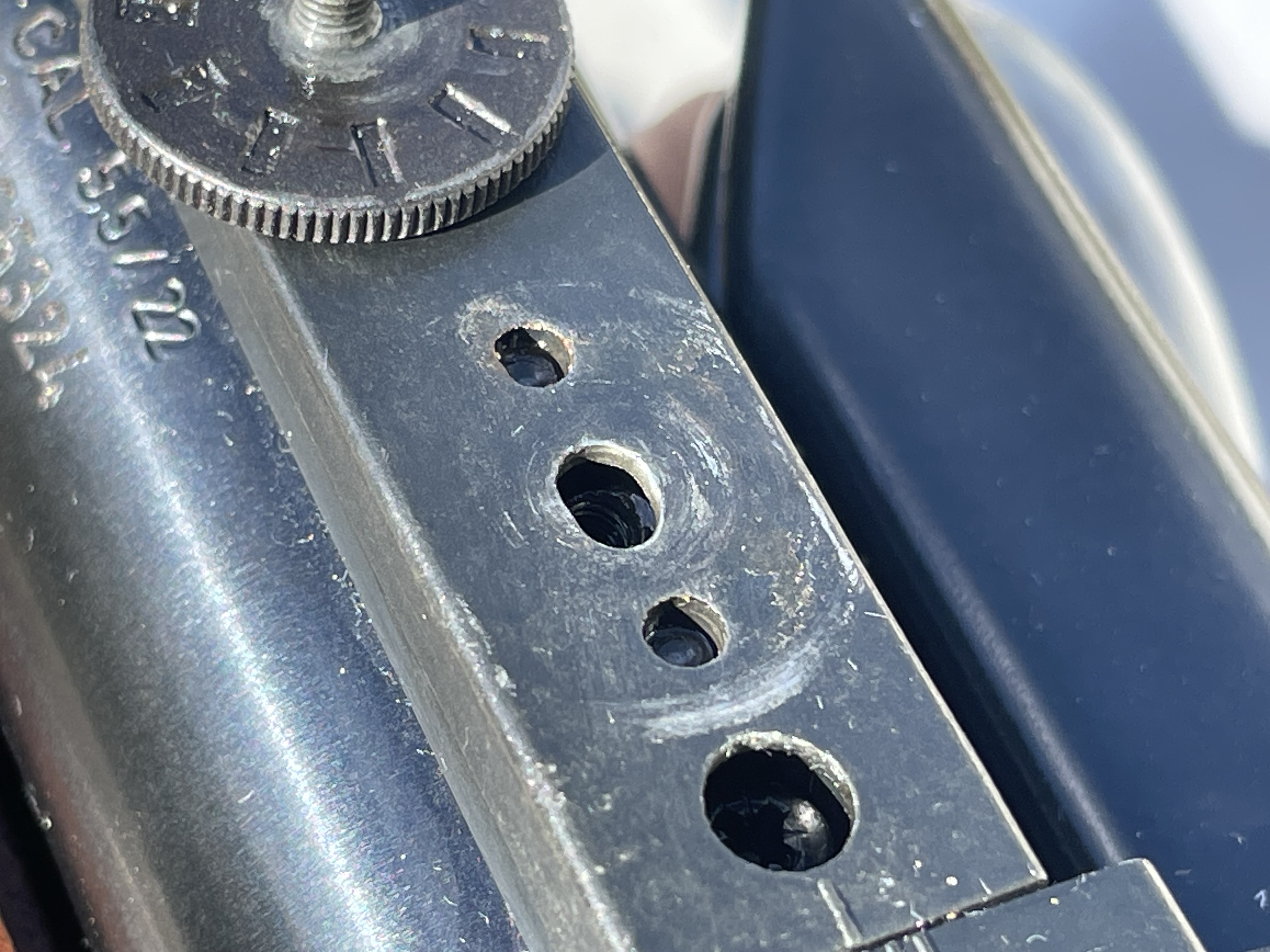

Well maybe not, I just discovered why the rear sight adjustment knob keep falling off.

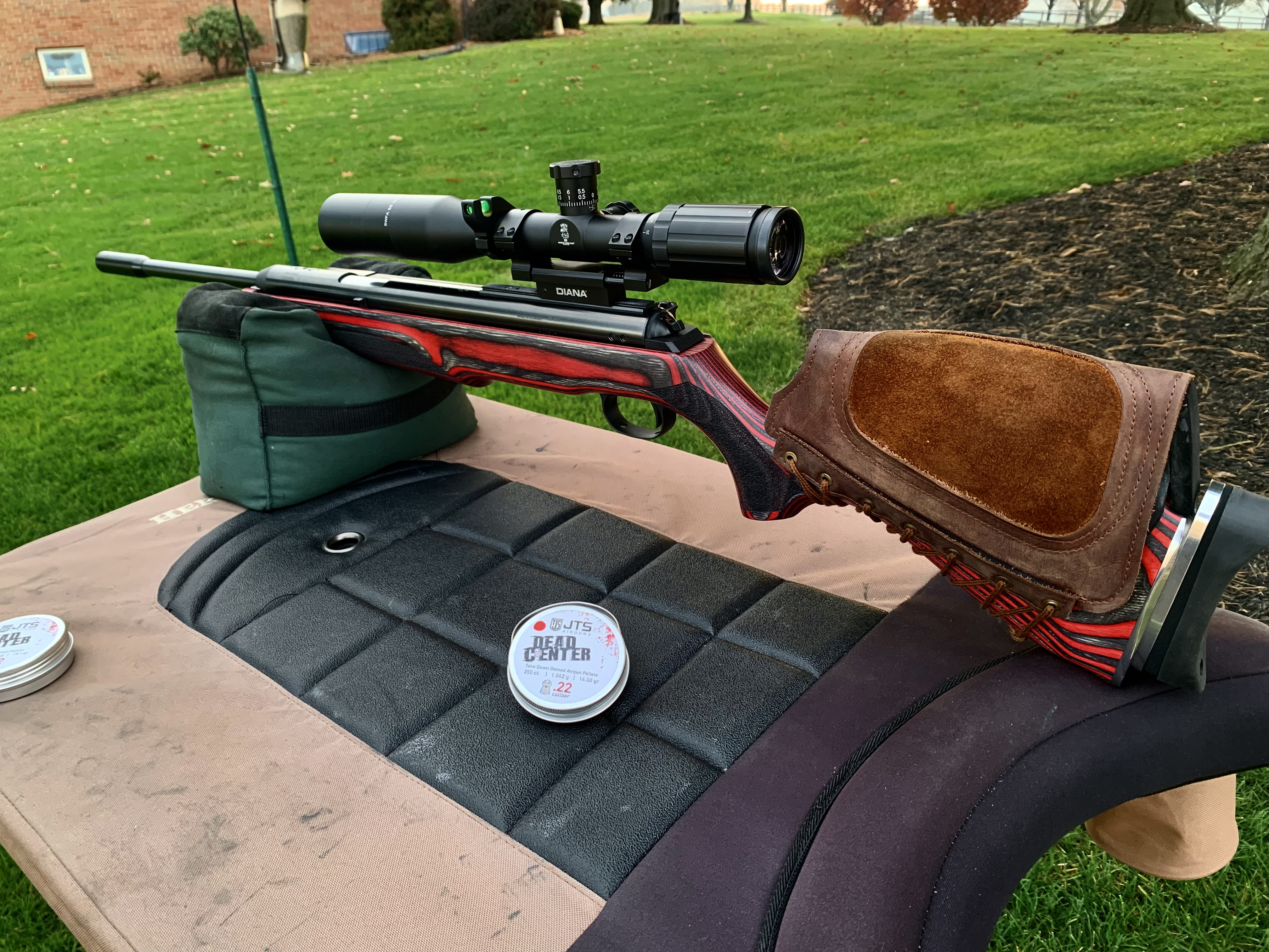

As Jeff mentioned, the Tuner from Hector Medina really helps. Same tuner as you see here on my D54 Pro.
Jeff got me moving on the 100-yard shooting. This was my first attempt. JTS 16gr with very slight breeze. It doesn’t take much of a breeze to take the skirted pellets off course. 3 in a 1/2” cluster, then the couple carried by the breeze. 4 within 1.25”, and the 5th making it 1.75” overall.
SWFA 12x and a Diana ZR compensated and accurized mount.
I like the idea of zeroing at 50.
Steve
Steve

Hector Medina sells the Tuners.
Compensated - Droop compensation built into the mount
Accurized - Custom work performed by Hector medina on the ZR mounts. Hector drills and taps holes in the top of the base, above the back end of each rail. He then inserts tiny plugs of PTFE (I think), and puts a set screw above the plugs for tension adjustment. This allows you to snug up just enough to remove some of the slop between the rails and the base.
Steve
One thing about those muzzle tuners mentioned earlier I'd like to add, they are gun, current tune and pellet specific.
I think, but could be wrong, that after everything has been sorted to the best one can, then go to apply the tuner to further improve accuracy. It's not guaranteed to improve things drastically, but can help under certain conditions... Or even hinder if poorly adjusted. Found it helped on my .22 Air King Pro, but on my .177 54 it didn't help, so I just stayed with the OEM front sight. One thing to keep in mind, with the HPM device (tuner) you will need o-rings if you need to adjust off the barrel sleeve/shroud (false outer barrel). Owners of 48/54 and similar models will know what I'm talking about, Lol.
Limbsaver had a barrel harmonic tuner, really inexpensive. It was kind of ugly, but some said it worked well. Wouldn't be nearly as good looking as one meant for the 54, but if one wanted to experiment with harmonic tuning it's one way to go that shouldn't damage the barrel in any way and is only $10 give or take... Just a thought, but know tuning can take quite a bit of adjusting to get just right.

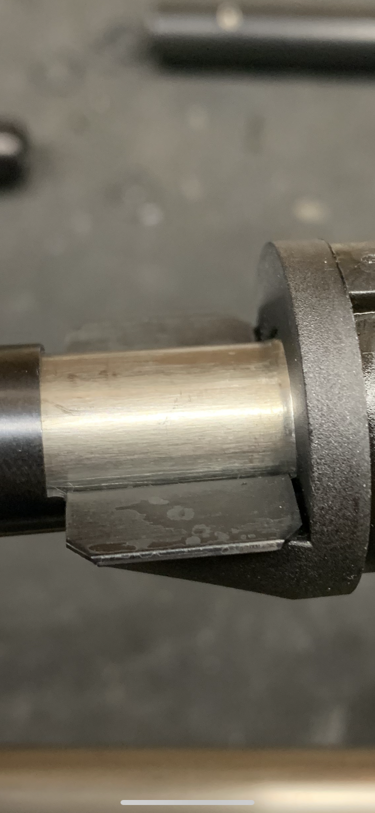

The shroud should be tight. It's only held in place by compression of the front sight, just loosen the grub screw of the front sight, press it back to shroud (false barrel) then snug that screw again. You just might find that keeping all that tight will have far greater effect than adding a harmonic tuner.
The actual barrel O.D. measures 15mm, possibly a hair over (15.2mm-15.3mm max). I believe that shroud is mostly cosmetic, could be wrong on that also. Knowing barrel diameter opens up options for sleeving and possibly adding a custom brake or such things... Most folks that own 54 Air King (& Pro's) seem to dismiss doing such, as it leaves potential to ruin accuracy, but I'm a firm believer in tailoring tools to the operators needs and not the other way around. If nothing else, you know the actual barrel O.D. now.

Your first paragraph......that is the whole idea of a tuner. It is getting the best accuracy possible out of a given set up.
Your second paragraph.......I have been using tuners for about 20 years, never saw an incidence of hindering accuracy. The orings needed come with Hectors tuner.
It takes a little time and patience, maybe some folks don't have that.
Years ago I was most often the only shooter at a PB benchrest match with a tuner. I heard many snide and stupid comments. Funny, most of those guys are out of the sport because they could not compete, or are now using a tuner.
With one pellet I found the tuner installed with no outings shot extremely well.
You will find as you make adjustments your point of aim will vary, that is normal as your changing the exit point of your pellet within the barrel harmonics.
No, they are not for everyone. They are an added cost and they require some effort but if you want to get everything your rifle has to offer, they are with it.

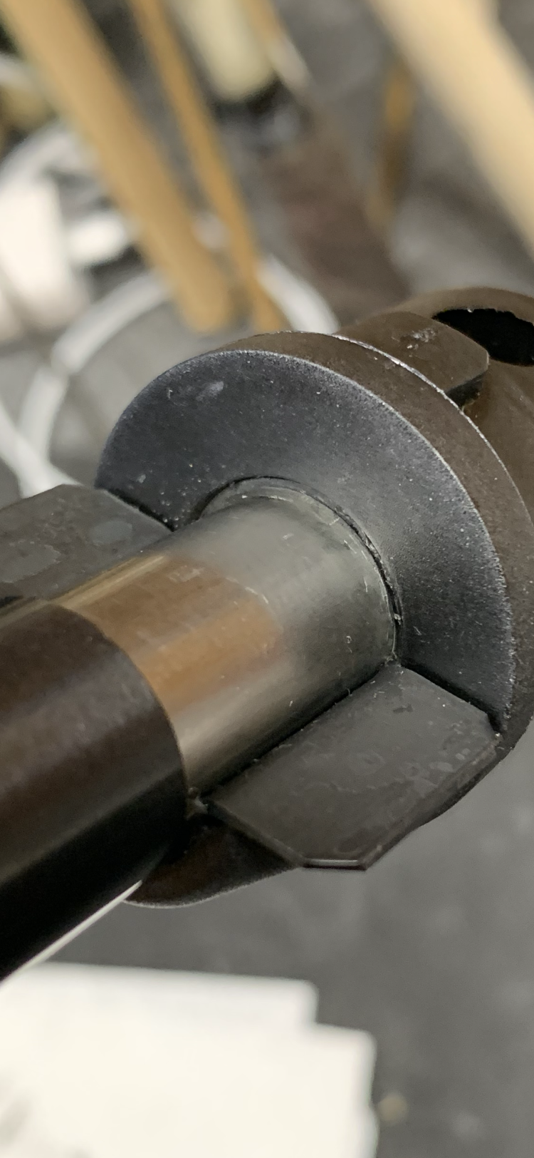

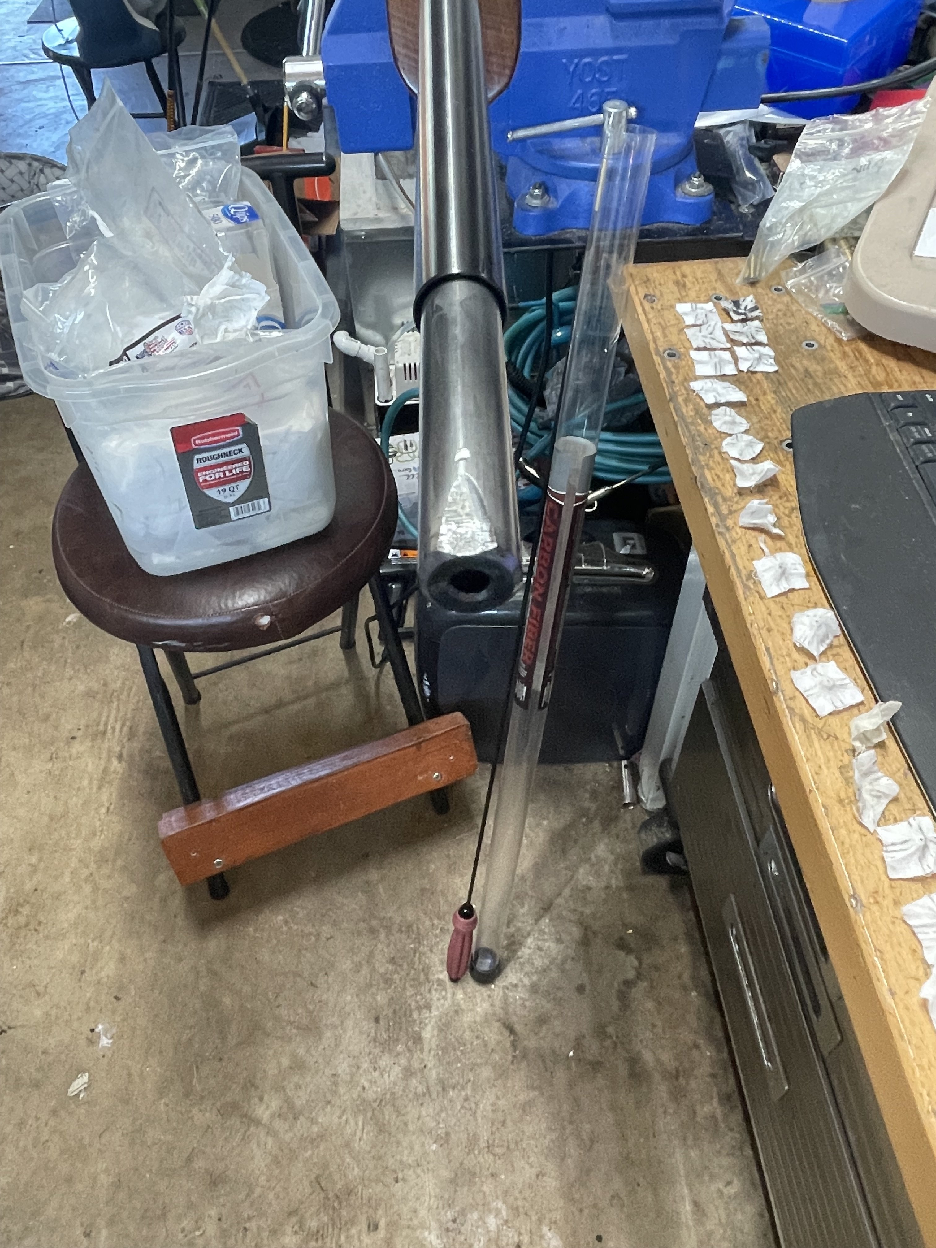

The barrel is thicker than I thought it would be. When I first saw the grind mark I freaked out, LOL. Sleeve now tight, O-ring looked good. Work in progress.

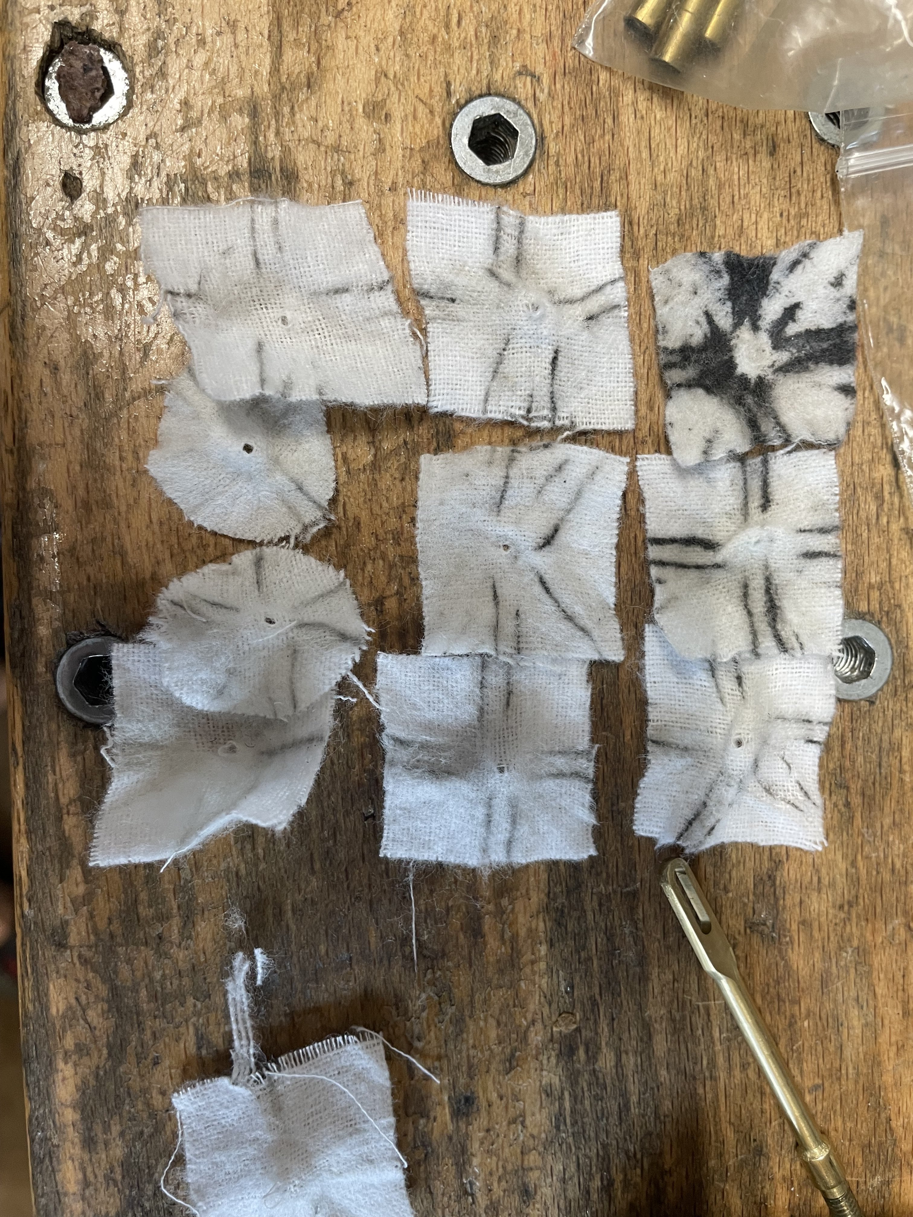

Gave the bore a good cleaning.

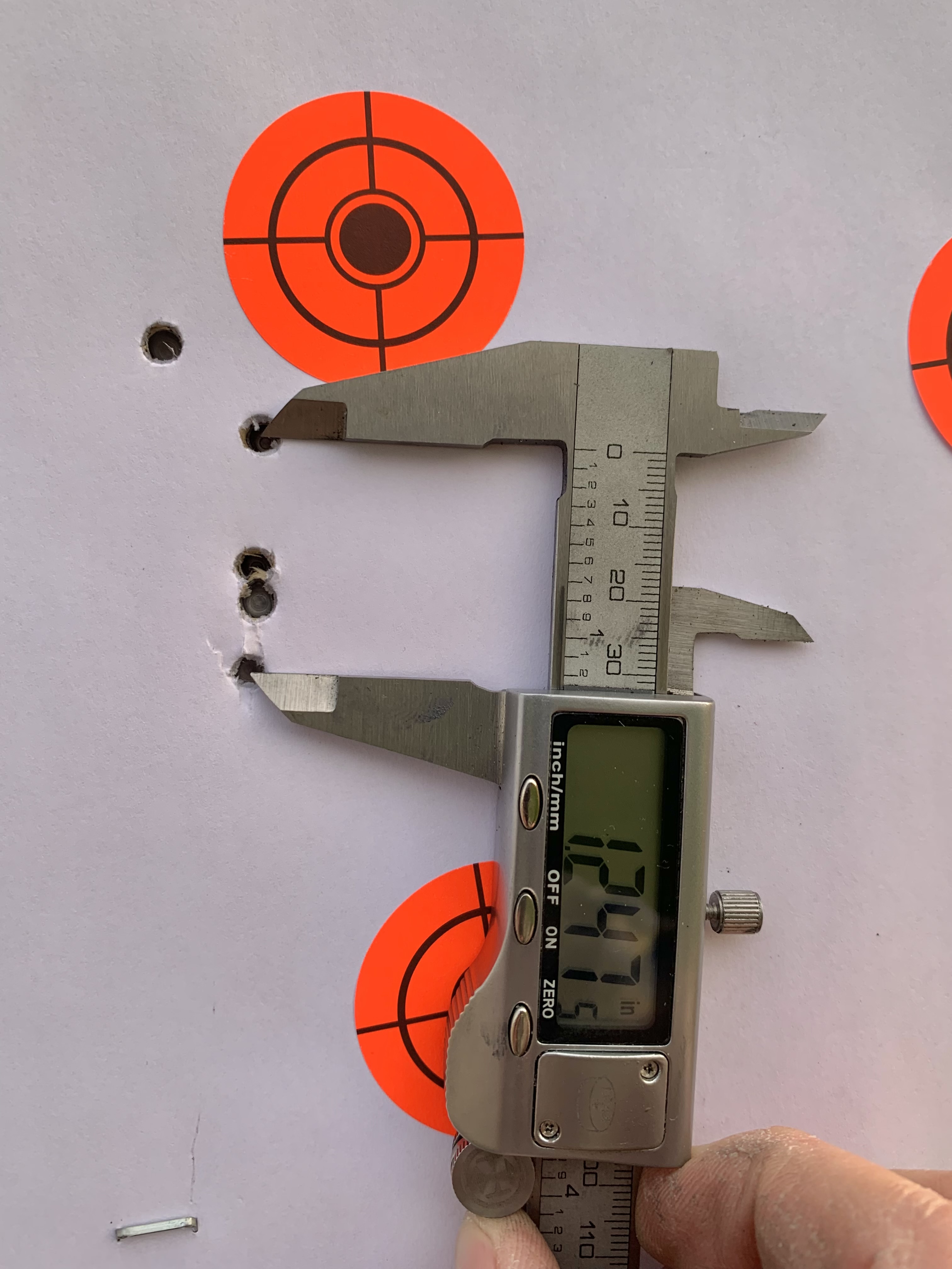

How about these 5 shot one ragged holes yesterday at 25 yards using Crossman Premier $6 for a box of 500? Got 2 out of 18 targets. Maybe it's me losing my shooting abilities? LOL
Keep an eye on the inner sleeve as well. I’ve had several 54’s that had the inner sleeve shifting back inside that plastic insert. If you see the sleeve shifting back, adding a very slight flare to the end of that inner sleeve will keep this from happening.

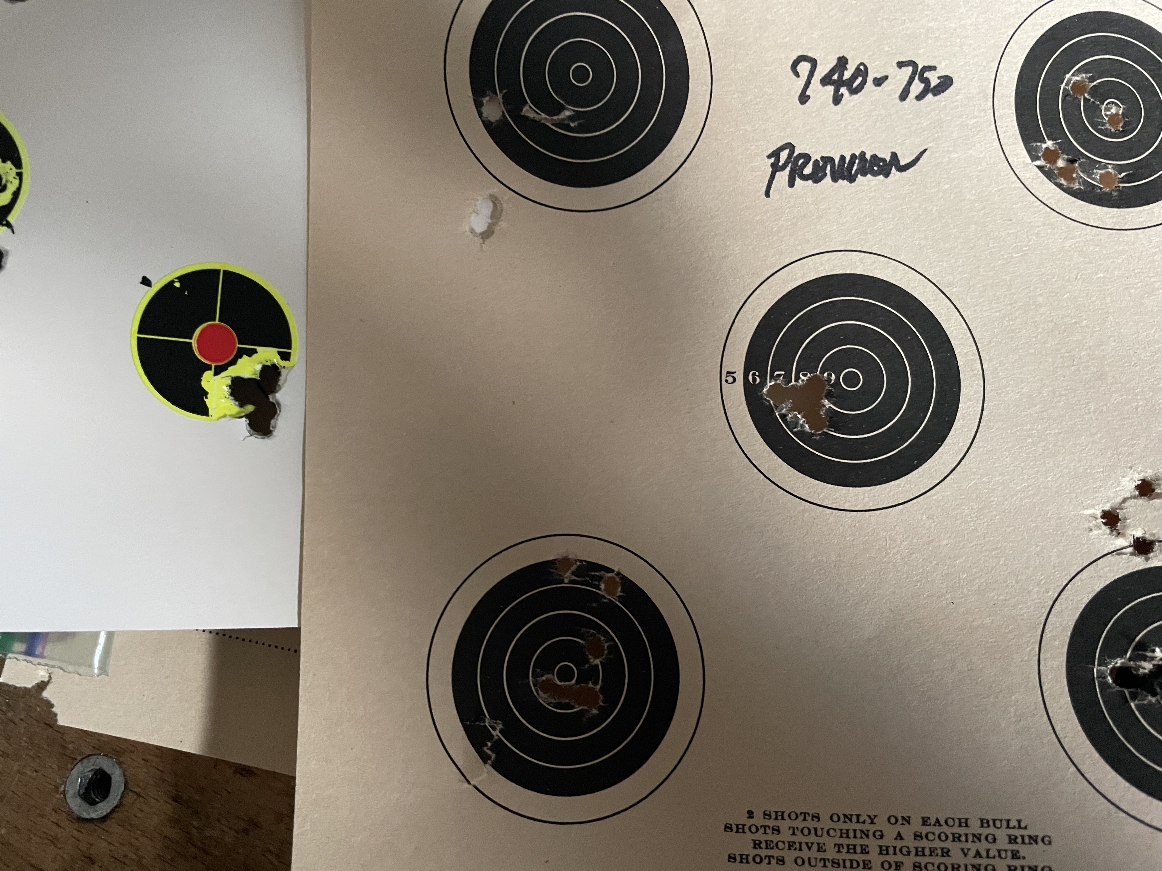

Update conclusion and solution:
Being not so happy with having a 17 FPE Diana 54 I re-installed the original Diana piston seal to compare to the JM seal I worked on. FPS rose from 750 to 760. I must have had the new seal almost there. I couldn't get either JM spring to get over 760 FPS even with the original piston seal. WTF springs did I buy? I now see Vortek sells a 33 coil spring like the original.
I reinstalled the original Diana spring and it is back to 835-849 FPS with Crossman 14.3 pellets. I guess the shotgun approach of replacing parts was a waste of money but I did learn how to work on this rifle.

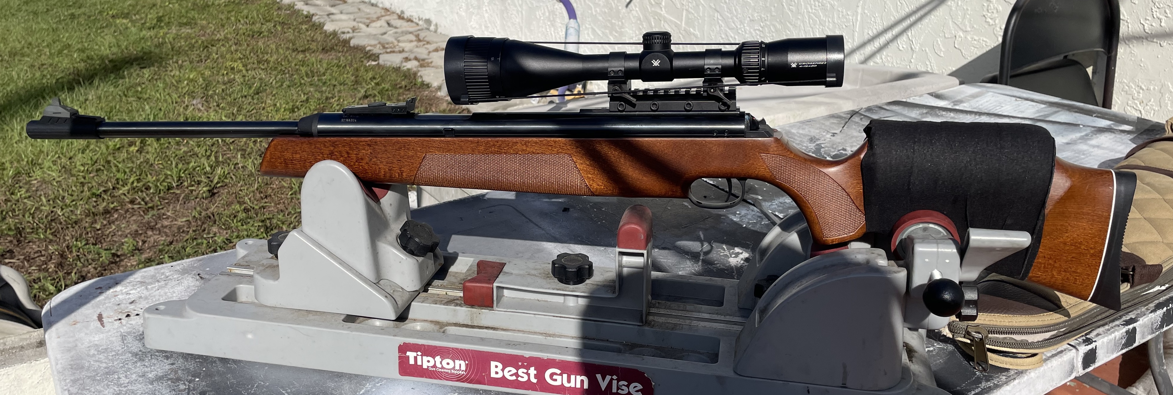

I tried shooting at 100 yards for the first time with a .22 cal springer. Last week I shot at 50 yards and was happy with the results.
I was shooting my RWS Diana 54 with a Bullseye scope mount and a Vortex Crossfire II 4X12X50 scope.
Going from 50 to 100 yards I had to hold at least 40 MOA higher. Using the impacts on the sand berm as a referance I adjusted the scope to max elevation and it still needed another 25-30 MOA to reach center target.
Going from my usual 25 yards out to 50 yards wasn't too bad in scope adjustment but 50 to 100 yards was unobtainable with my setup.
Once I made POI reference I was able to make 5 of 5 hits on the cardboard but aiming 30+ MOA high was not even fun for grouping.
Any tips from the pro's? Maybe shims on the mount or forget about it?
