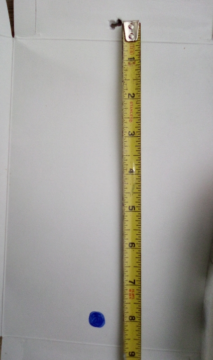

i quick set up this at 30y . The gamos scoped is zeroed at 100y. Using cphp .22. It's 8 inches
So zeroed at 100y. I'm 8" high at 30y using .22 cphp @ 780fps+/-
The same test the R9 .177 cphp was 6"

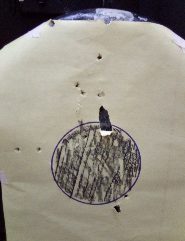

I used to have a video of me shooting one of the lone ranger golf balls at 150 yards with my d460... I think it took about 8 or 10 shots. I was holding a group that was maybe a foot in diameter. I had to aim at a spot a lot higher than the ball. I still got the patch around here somewhere.

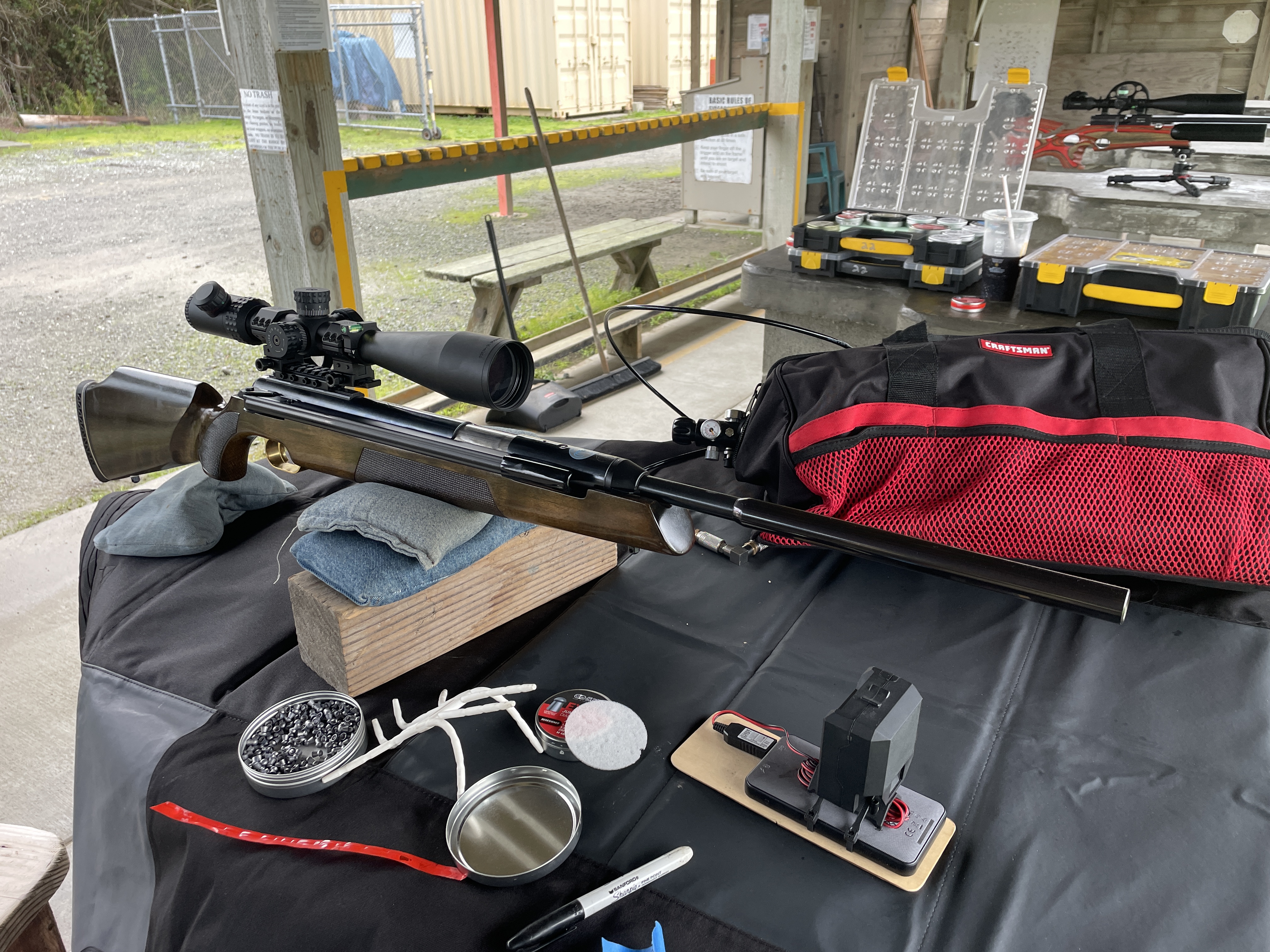

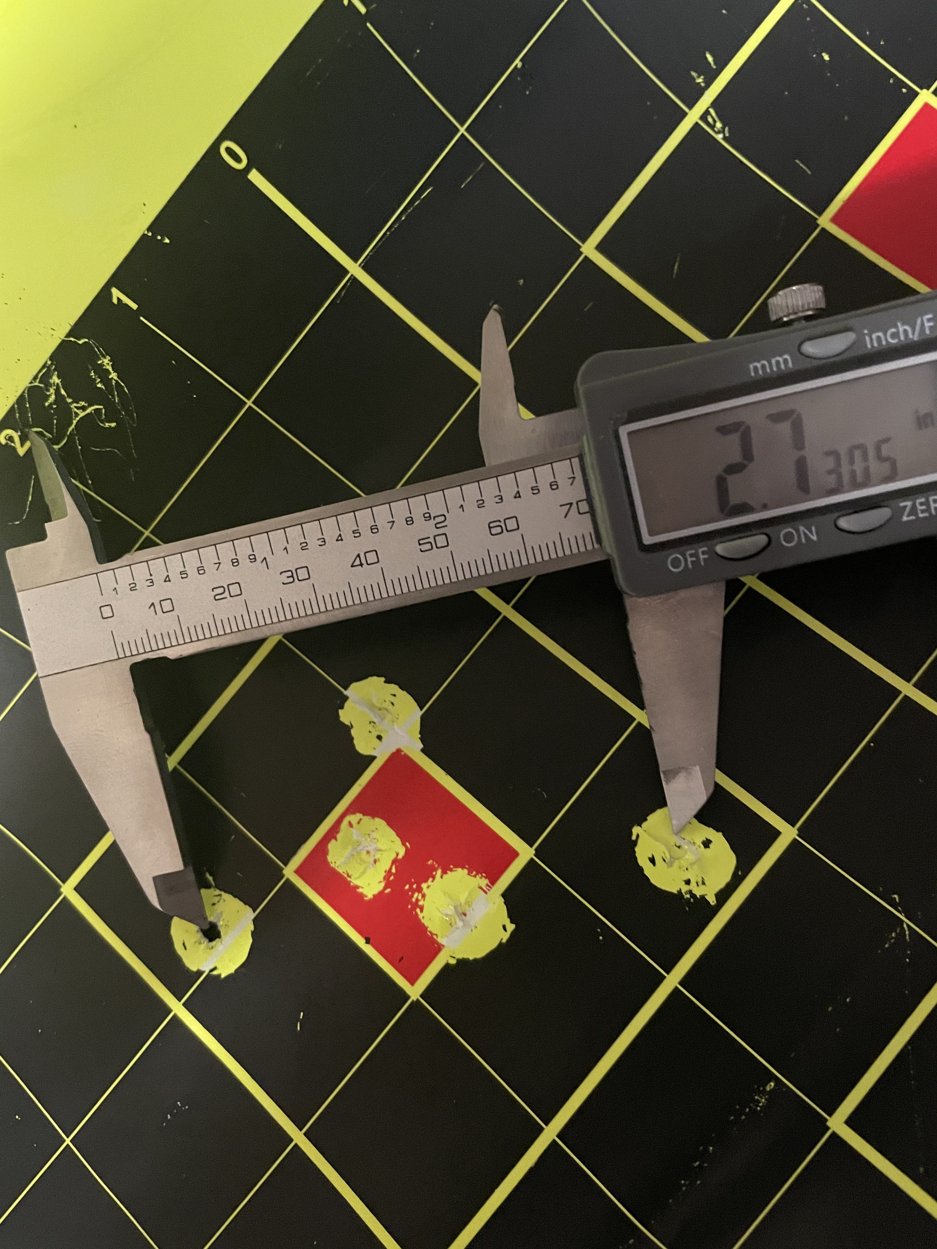

I have shot as small as 1.3 for a 5 shot group at 100. Several times I have had the first 3 pellets make a tight cloverleaf under .4. You need really dead conditions. I zero at 50, usually will do .5 at 50 or a bit under. For 100 I use the line below my cross hair. My single smallest group was with JTS 18.01 in my Diana 54 .22. If you do not have Hector Medina tuner he makes for the 54, you should. You can tune the harmonics of your barrel to the pellet. It cut my groups in half.

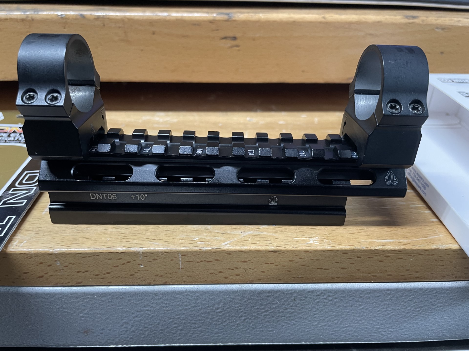

Low 1" rings mounted on a 20 MOA UTG picatinny mounted on the UTG DN T06. Only slightly higher than the Bullseye mount.
The DN T06 advertises 10 inch at 30 yards so that would make it a 30 MOA mount right?
From the specs: "Decreases barrel droop with 10" upward compensation at 30 yds"
So both would be 50 MOA. That should do 100 yards easily.
