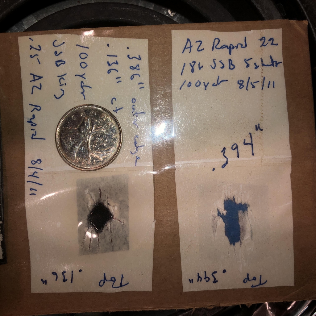

Until the JSB King became available, there was no 25 caliber pellet that could do much of anything past 75 yards. Even the king, in my extremely accurate 25 rapid, did not hold up past 150 yards. At 200 I was shooting basketball size groups. Oddly enough, my 22 rapid would hold up at 200 yards on a calm day.

mike
