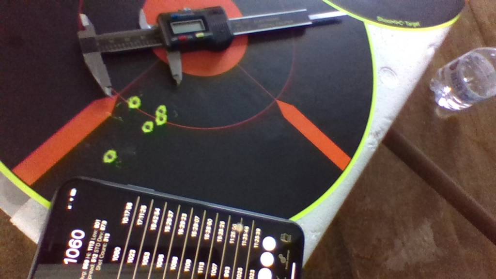

Tuning 100 yard group 15 inch BARREL p12 1100 fps 177 with slugs
To me this is no good Its on video but reshootin today .It was windy yesturday and i didnt wash and lube the slugs 4 shots in .821 of an inch. Wih the flier 1.552.So today i reshoot.And with little wind and clean ammo they will be tight and fast. Speeds were fron 1109 to the last at 1053 the flier .that one tripped over a piece of lead causing it to slow and spiral. Check out my post on washing your ammo.This is why posted it for you guys
 pics and video coming tonite
