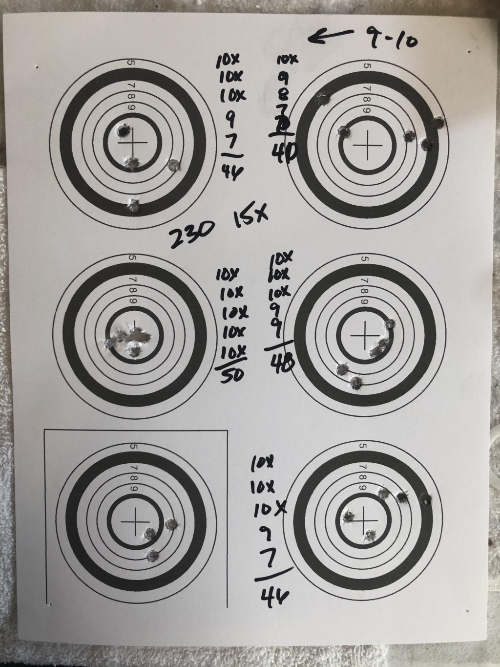

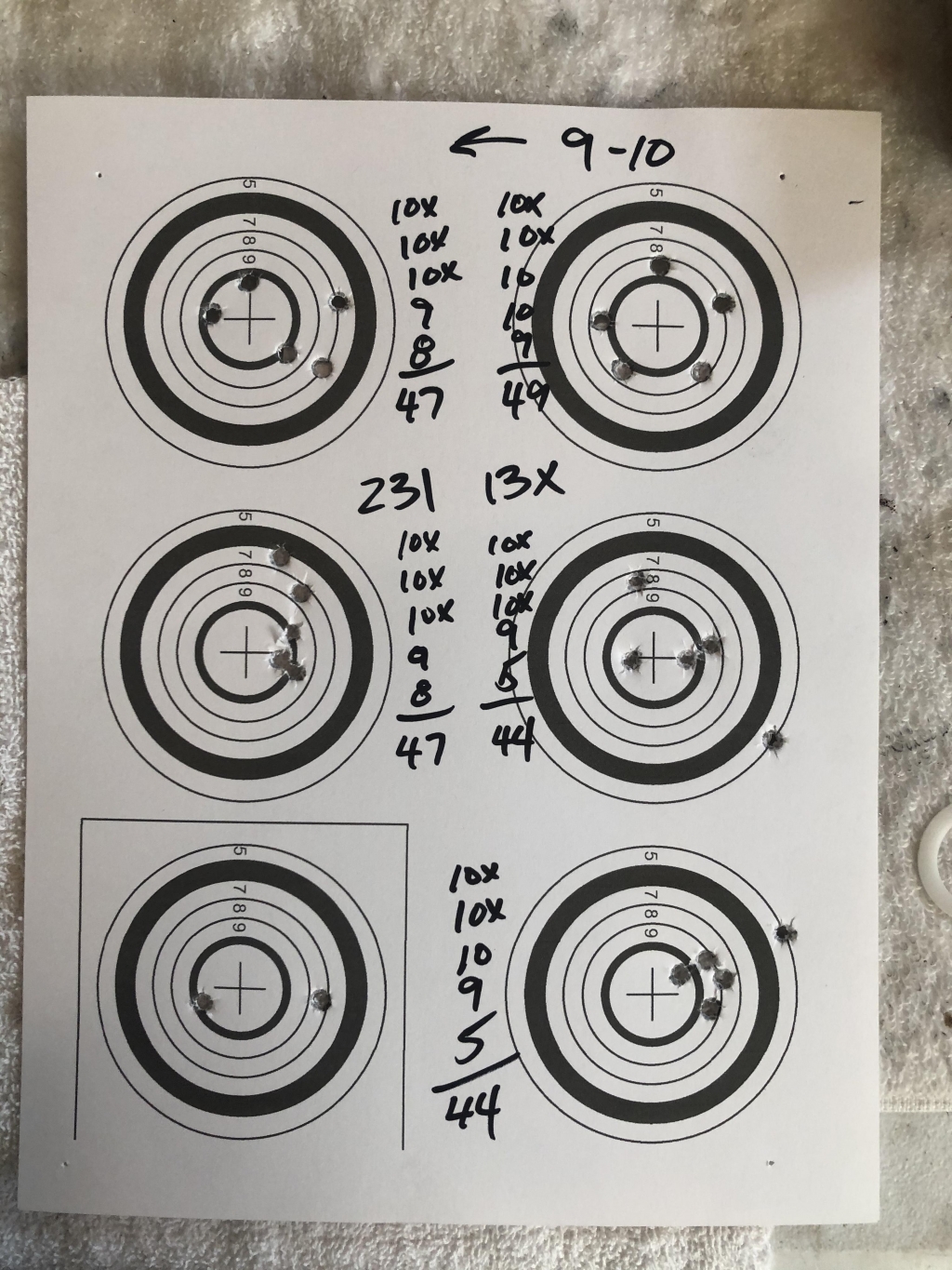

First cards on test target. Scored with .350 plug. 9-10 West wind...but not too bad to shoot in. The tighter rings keep the score reigned in despite hitting more 10s. X counts are high...but I’m not sure that is a bad thing.
Mike
It could be too big, Jimmy. I’m not sure that it hurts anything though. It seems like an oddly high x count...but that’s probably just because we are used to it being lower.
