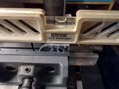

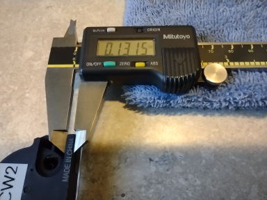

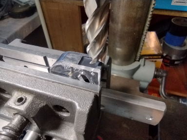

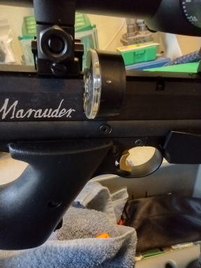

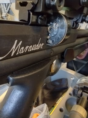

I don't know if anyone has tried this or done this in the past, but I have done a number of these with great success. I have done this with both Benjamin and Umarex 10 round magazines with no issues. Every single magazine I have done this mod on (≈ a dozen) has been extensively tested and performed flawlessly. By milling off approximately .025" from the bottom of the 10 round magazine they will then fit nicely in your Prod. As they say 'a picture is worth a thousand words'...
You want the bottom (floor) of the magazine to be somewhere between .130" and .135" for a nice fit in the Prod. Hope this helps out some of you guys that hunt with your Prods.
View attachment 195606 View attachment 195610 View attachment 195615 View attachment 195617 View attachment 195618
