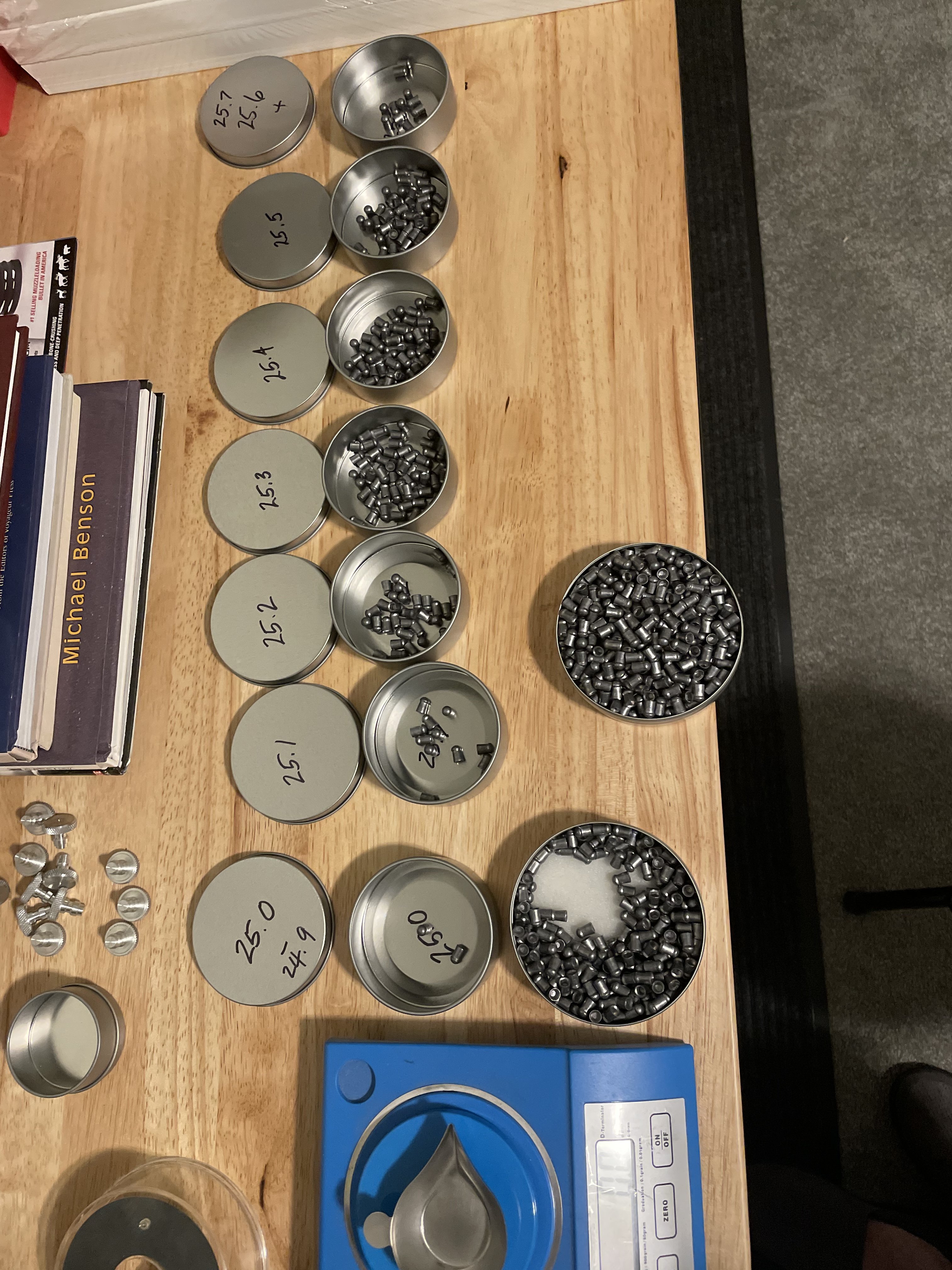

I just bought a bunch of these on sale - I hope this one tin is the worst of the bunch. I don't like weighing pellets and I don't shoot competition but at 35 yards I was getting 1" fliers with this new batch which prompted me to weigh them out. My older tins from November last had about a 1/2 grain spread on 350 rounds and very few outliers with most being within 0.30 grains of each other. I didn't sort them as they grouped nicely.
24.7 - 1 The skirt on this one was seriously bent. I didn't see any others with bad skirts.
24.8 - 1
24.9 - 3
25.0. - About 20
25.1 - 20+
25.2 - Maybe 30?
25.3 and 25.4 the two biggest groups fairly equal piles
25.5 maybe 30+
25.6 - 16
25.8 - 2
I didn't count every one but if can live with the 25.3 through 25.5 as all shootable as a lot that leaves at about 90 REJECTS. I am going to re-weigh the 25.2 grainers just to double check as that quantity seems pretty big - probably some 25.3s in there.

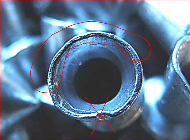

- uneven skirt bottom edge - check with a high power jewellery loope, you need to polish the skirt bottom for a same reason you polished the barrel Crown.
