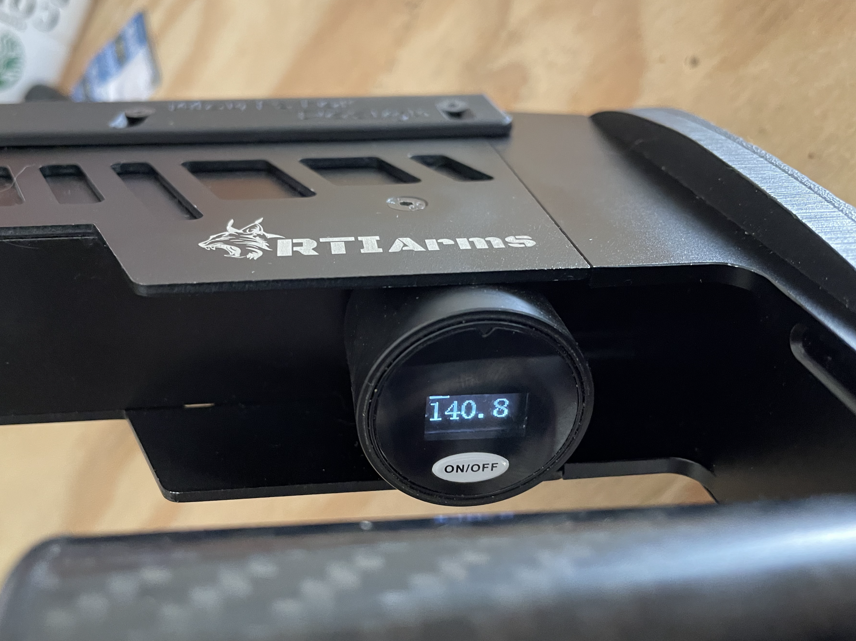

I saw that too. The one in my video was definitely PSI. Looks like these newer ones are Bar. But it really doesn't matter, just like looking at your speedometer in MPH or KPH, they both tell the same thing just in different "languages". Just know the language a little bit and you're gtg
Yeah, for the bottle pressure gauge no problemo. But for the HP reg pressure, which controls speed of the pellet, steps of 15 psi (1 bar) is a little wide... IMHO
Unless the gauge in bar goes in 0.1 bar increments then no problem.
I'd prefer PSI for literally everything, don't get me wrong, but in my experimentation with the SKOUT 15psi made very little difference. Ours would shoot the same velocity at like 1020-1060 PSI. Bar would be OK, and definitely better than the cheap analog gauges that come with the SKOUT.
I tried to set SKOUT up with the vendor to include the digi gauges as an OEM component but I am not sure where that conversation ended up between them. Shame because I was gonna get a small royalty per gauge! :confused: Honestly, though, this gun should 100% come with at least 1 digital gauge (for the HPR).

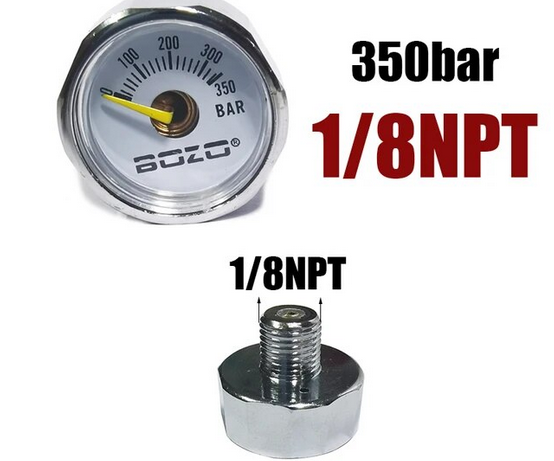

1/8 NPT 300 bar
@Bigragu these look kinda nice actually for the low cost of about 6$. The 340/350 cut off is meh though. Love the name haha Bozo.

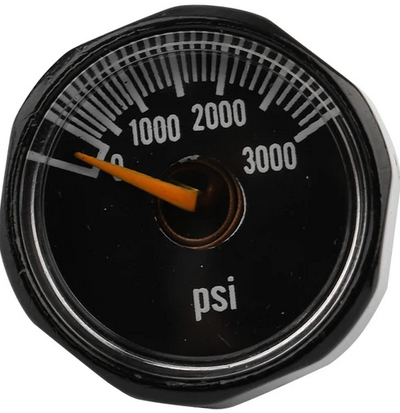

Such a cheap gauge belongs nowhere near a high end airgun. Please repent now for posting this...
If it weren't for the last hash mark, it would be a mighty fine gauge. All the micro gauges are generally cheap (7-15$) and grade C or grade D. Lol
Just for this comment alone I went and found a cheaper one, that has amazing hash marks in 1/8" NPT / PSI. Thanks, bought a bunch!
4$ 1/8" NPT 0-3000 fine hash mark gauge
-Matt

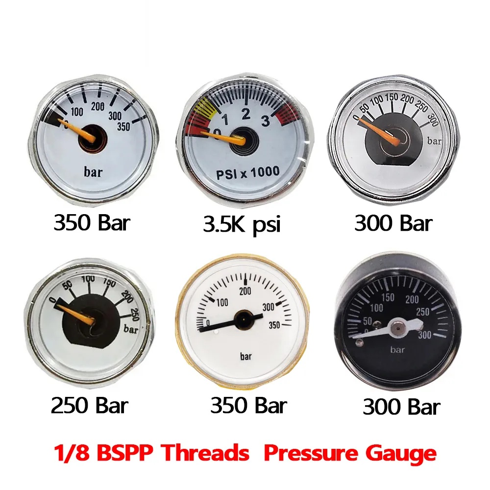

All those gauges with the orange hands that look attached to a spring all come from the same place and are super-unreliable. They drift by as much as 20% over time, and in as little as 20 PCP charging cycles (judging by the difference with what the gauge on the pump/compressor says).
Pick an "FX style" gauge that have proper axles for the hand, like the last 2 on this pic. They can be found here (link).
