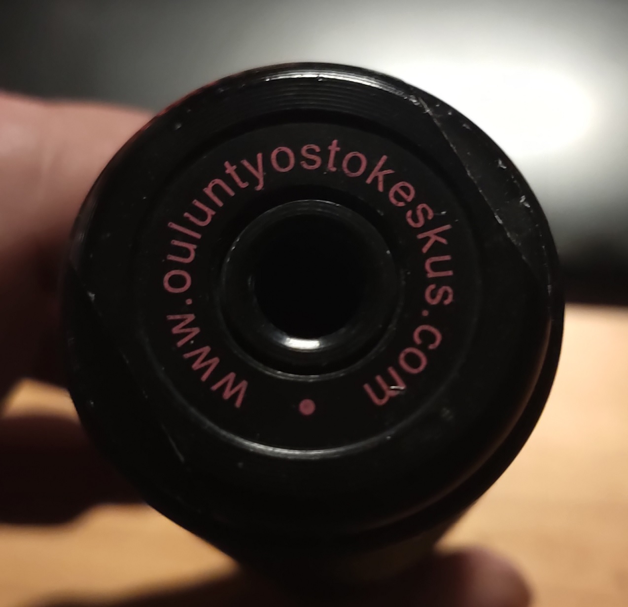

I have been using a old moderator on my rifles for a while ( unknown brand ), but i will get a new one soon, and i am looking forward to see if that give any change in grouping.

Seem like my old moderator are from Finland, the home of Sako and other nice things.
