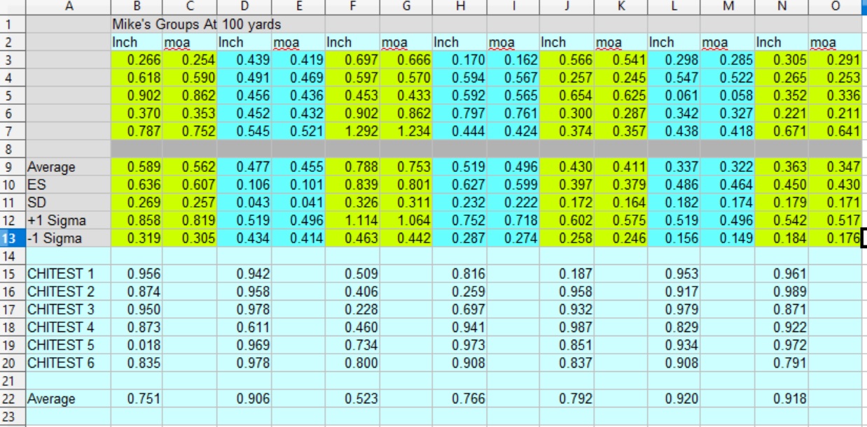

Spread sheet is attached if anyone wants to check the math.
World class shooting there.
In case anyone is wondering, that CHITEST supports the assertion that something caused the larger groups which was not normal (wind got you Mike) the rifle was shooting so much better than those big groups that it shows up on the CHI Square test as unusual. That is to say there is a high probability that those groups are not normal for the other groups you shot (again the wind got you on the big groups) the rifle did not throw filers. Statistically that rifle with that ammo under those conditions is a half minute rifle +/- a quarter minute. Indoors it would likely be better than a half minute. CHITEST suggests indoors it would be doing a quarter minute +/- an eight, unless ammo is throwing you off more than it looks. Still ugly though 😜😁
Old spook…I don’t know what that means, to be honest. I don’t get too deep into analysis, though. After tuning for the best groups I can get…I go on to shooting for score. The scores show me what I need to know.
