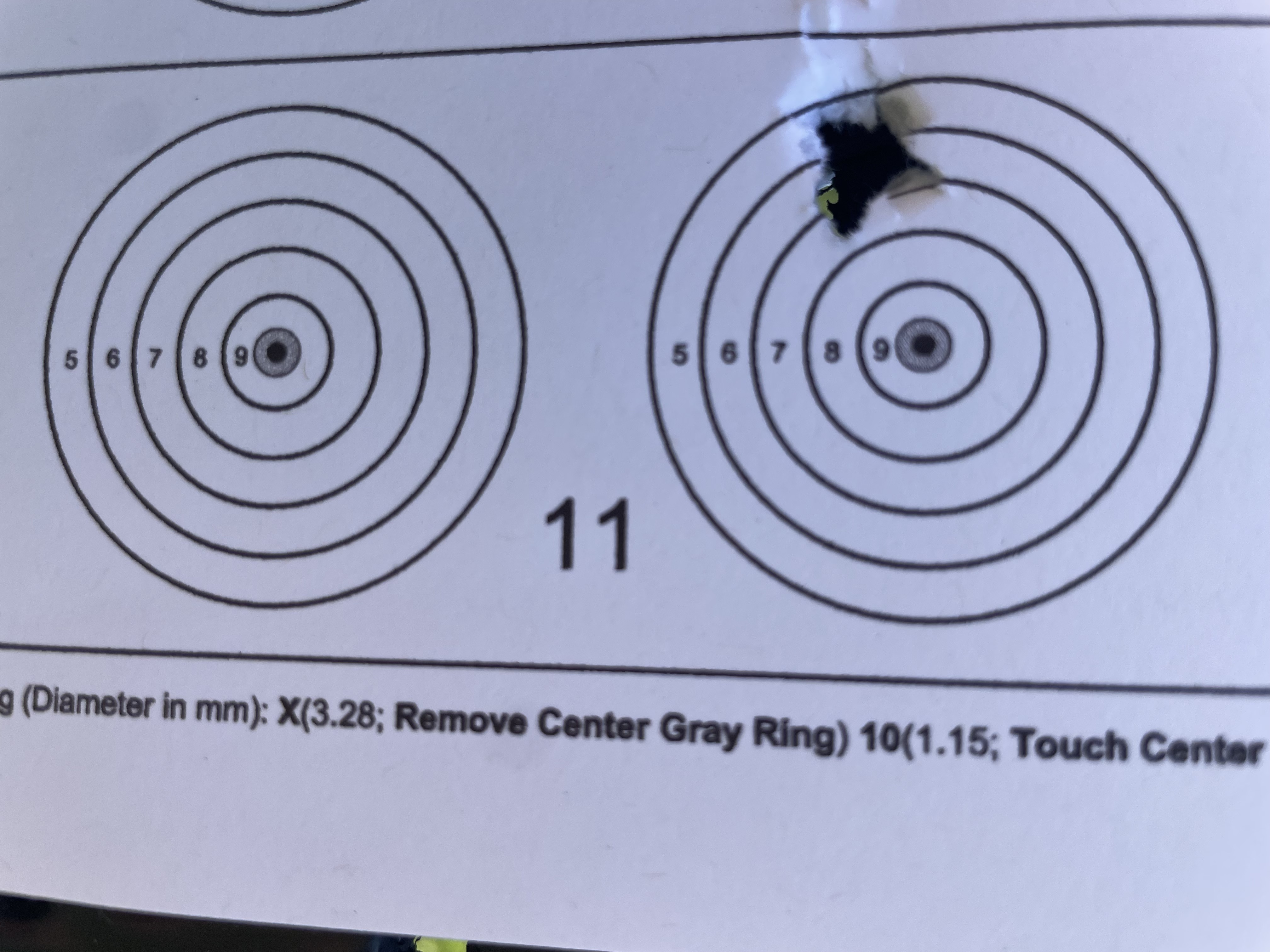

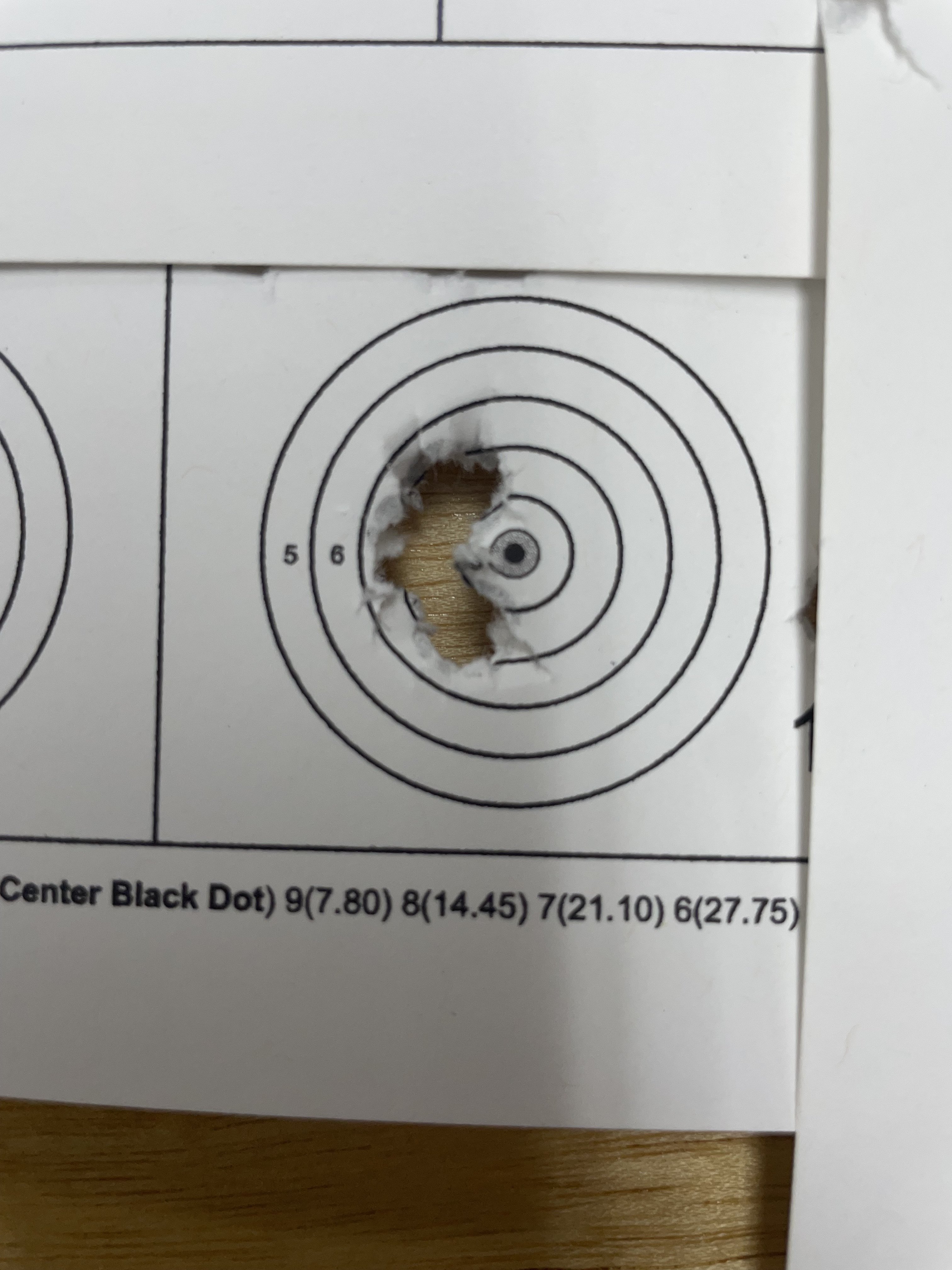

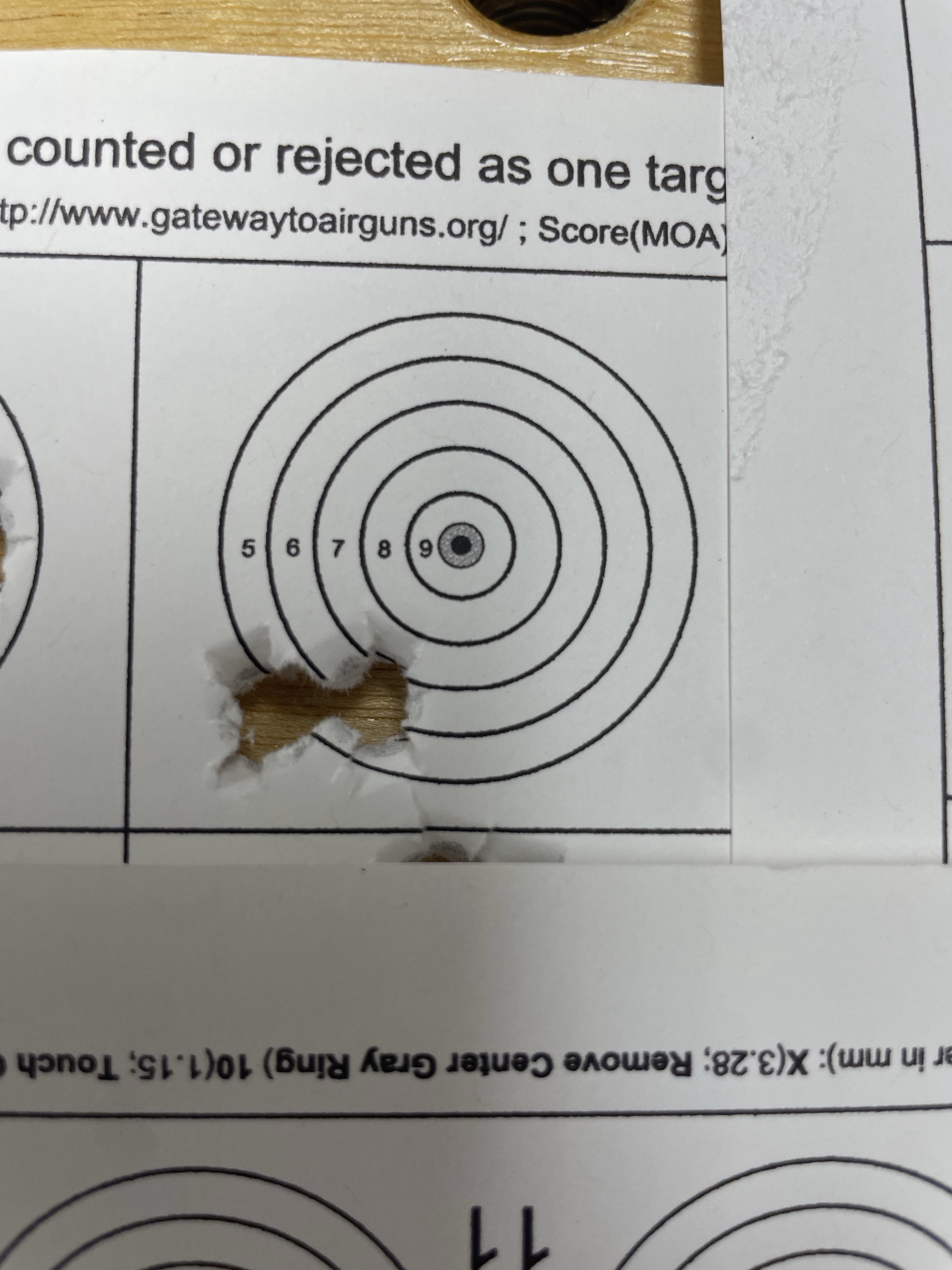

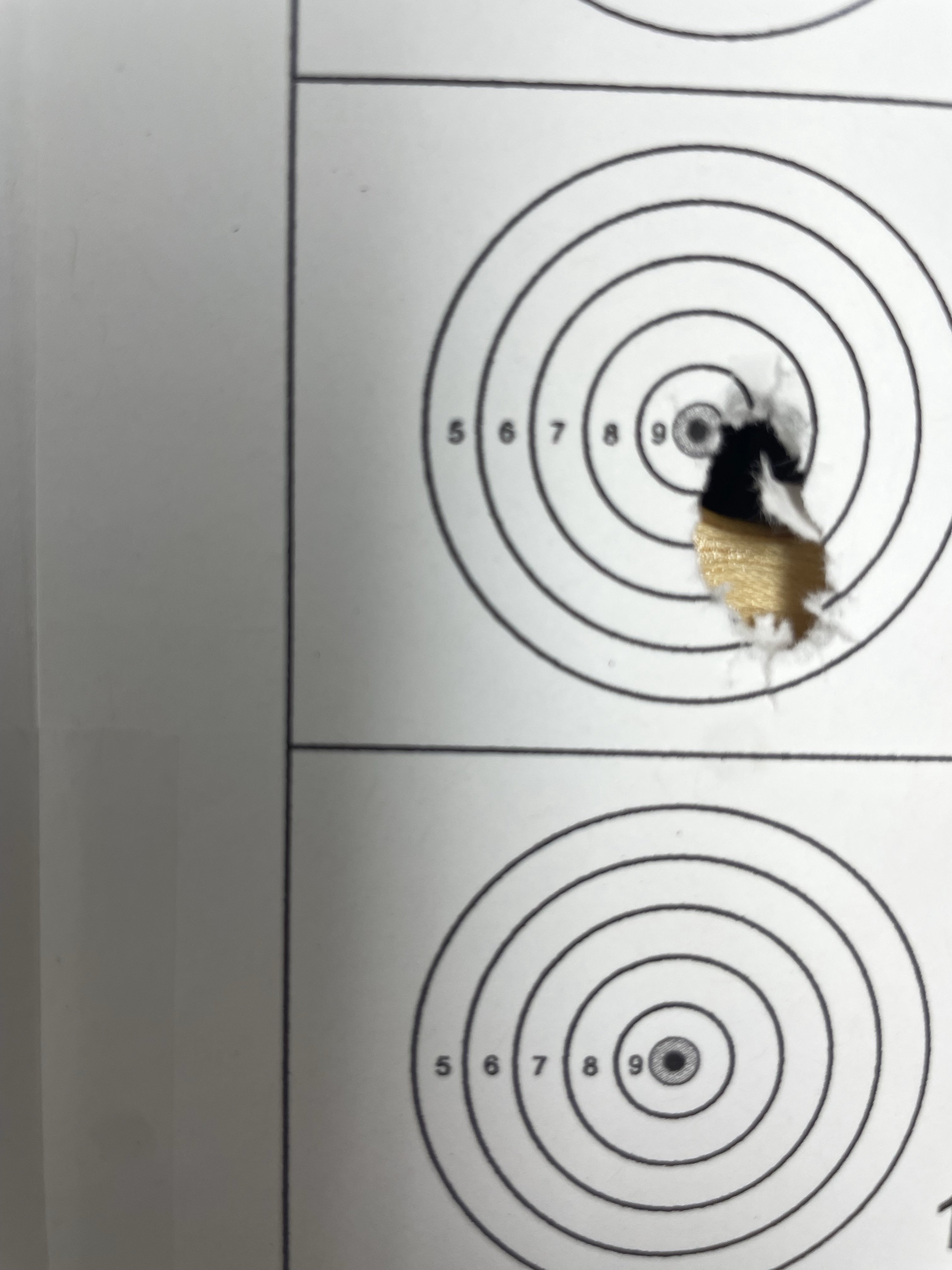

I took one of my .30’s HM100X’s to the range today. Pretty mild conditions 4-6 winds. I was experimenting with a FX tuner on the end of the barrel but didn’t have much success. I would show the whole target but it looks like it’s been hit multiple times with a 12 gage and would not make much sense to anyone but me. RAW’s are certainly capable if the nut behind the trigger can get a handle on reading the wind? Here are a few cherry picked 5 shot groups @100Y without the tuner.
View attachment 583907View attachment 583908View attachment 583909
This may be my smallest group ever shot at 100Y?
I would be happy with those groups for sure.
