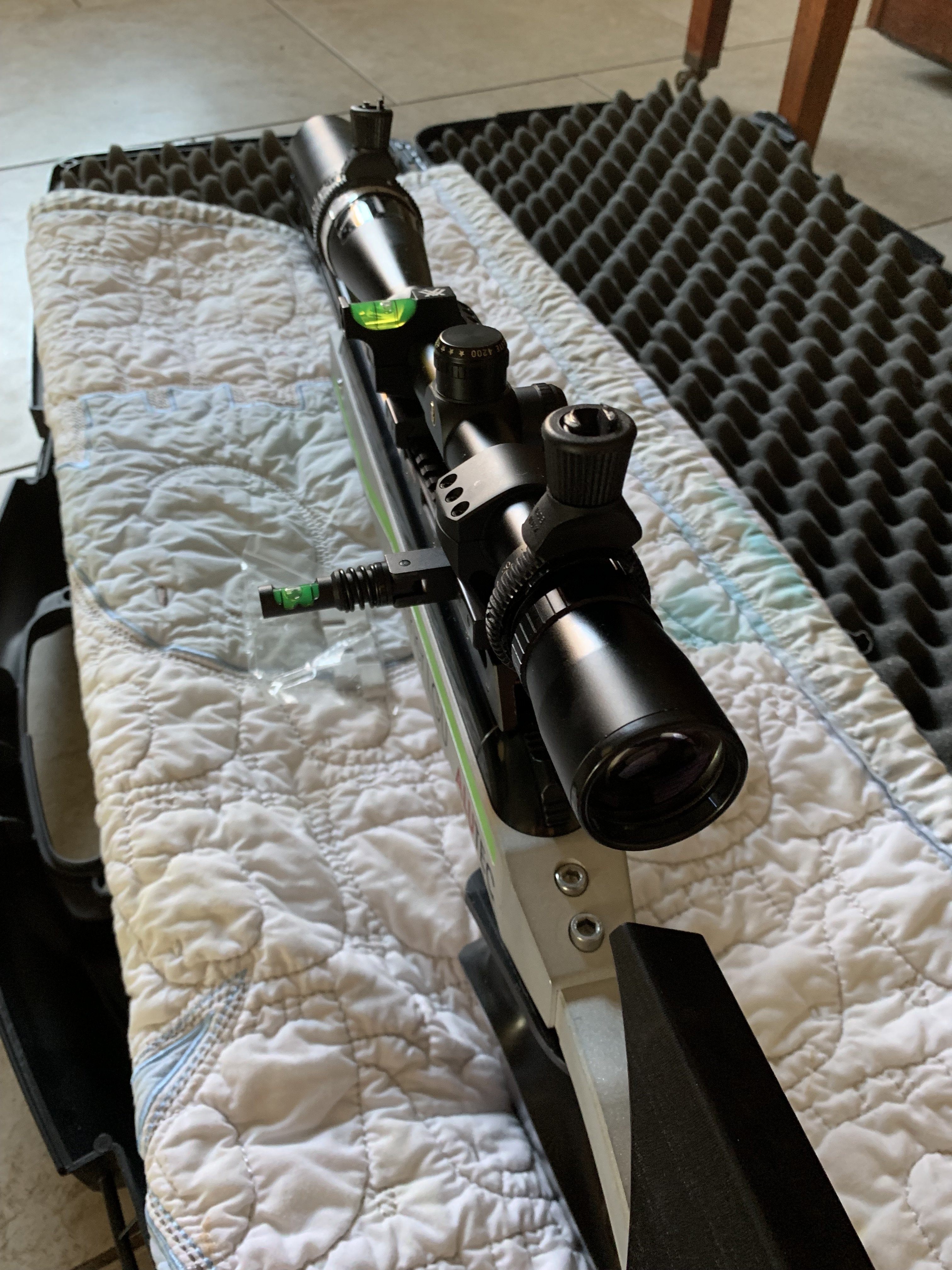

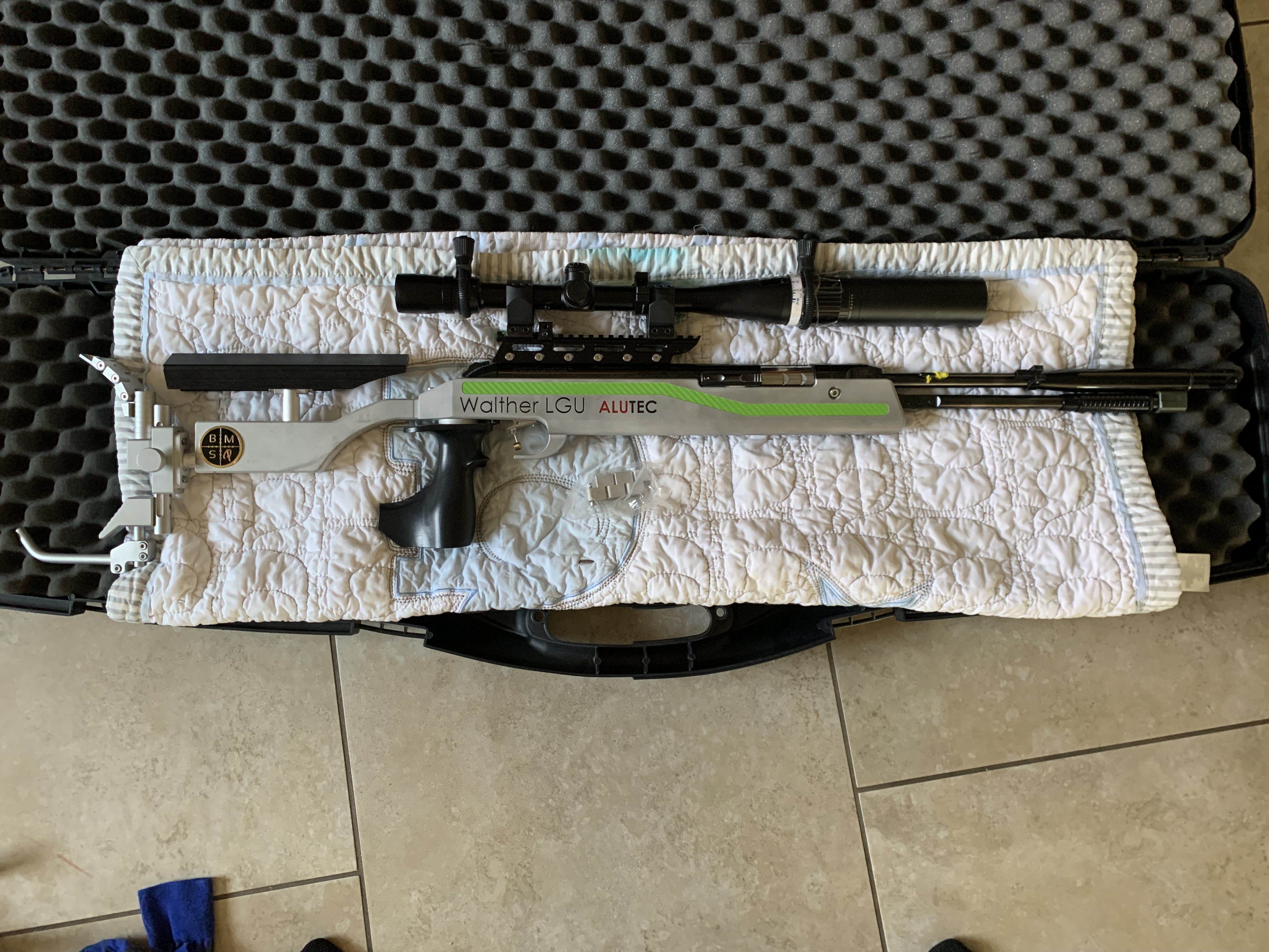

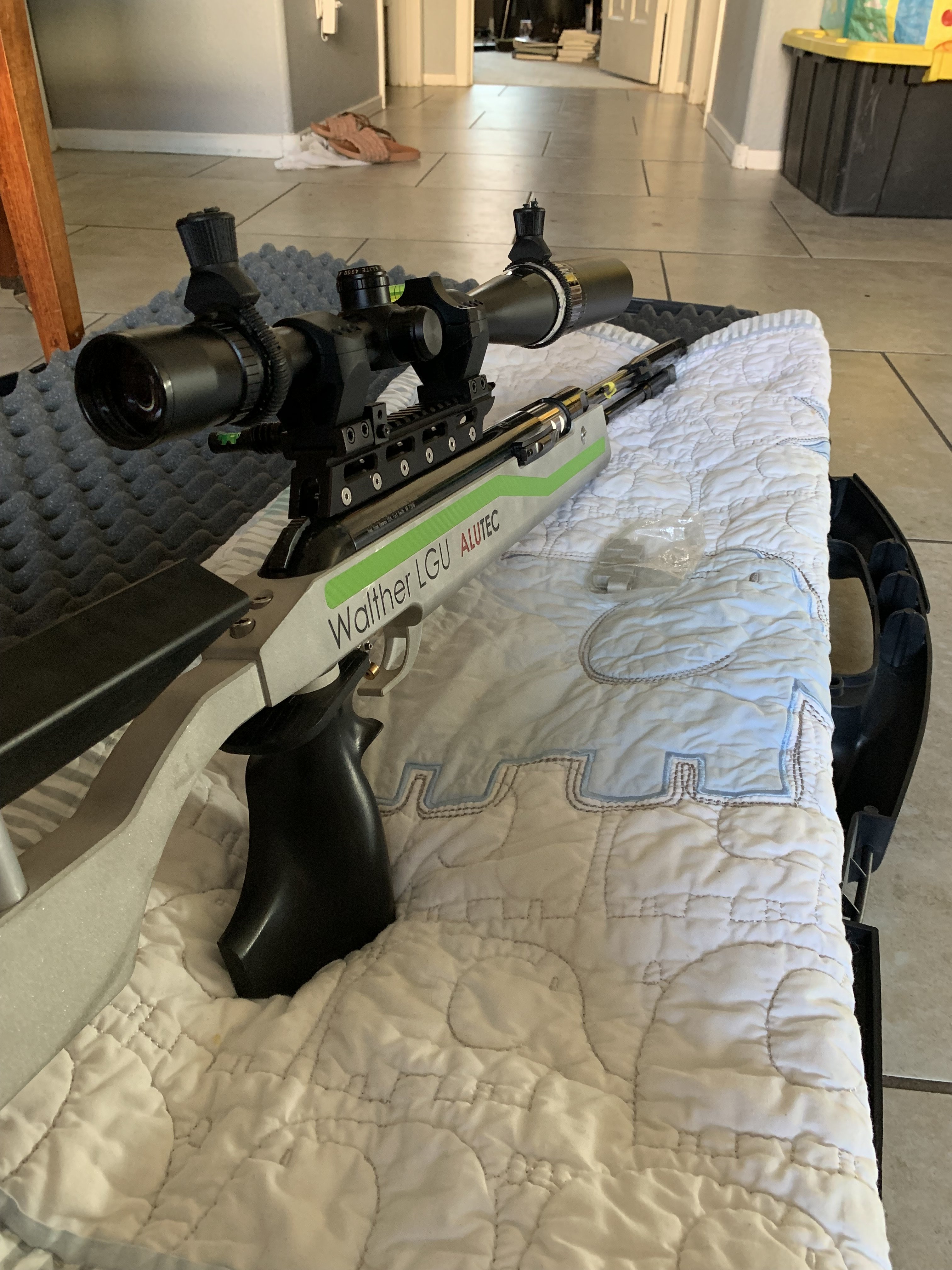

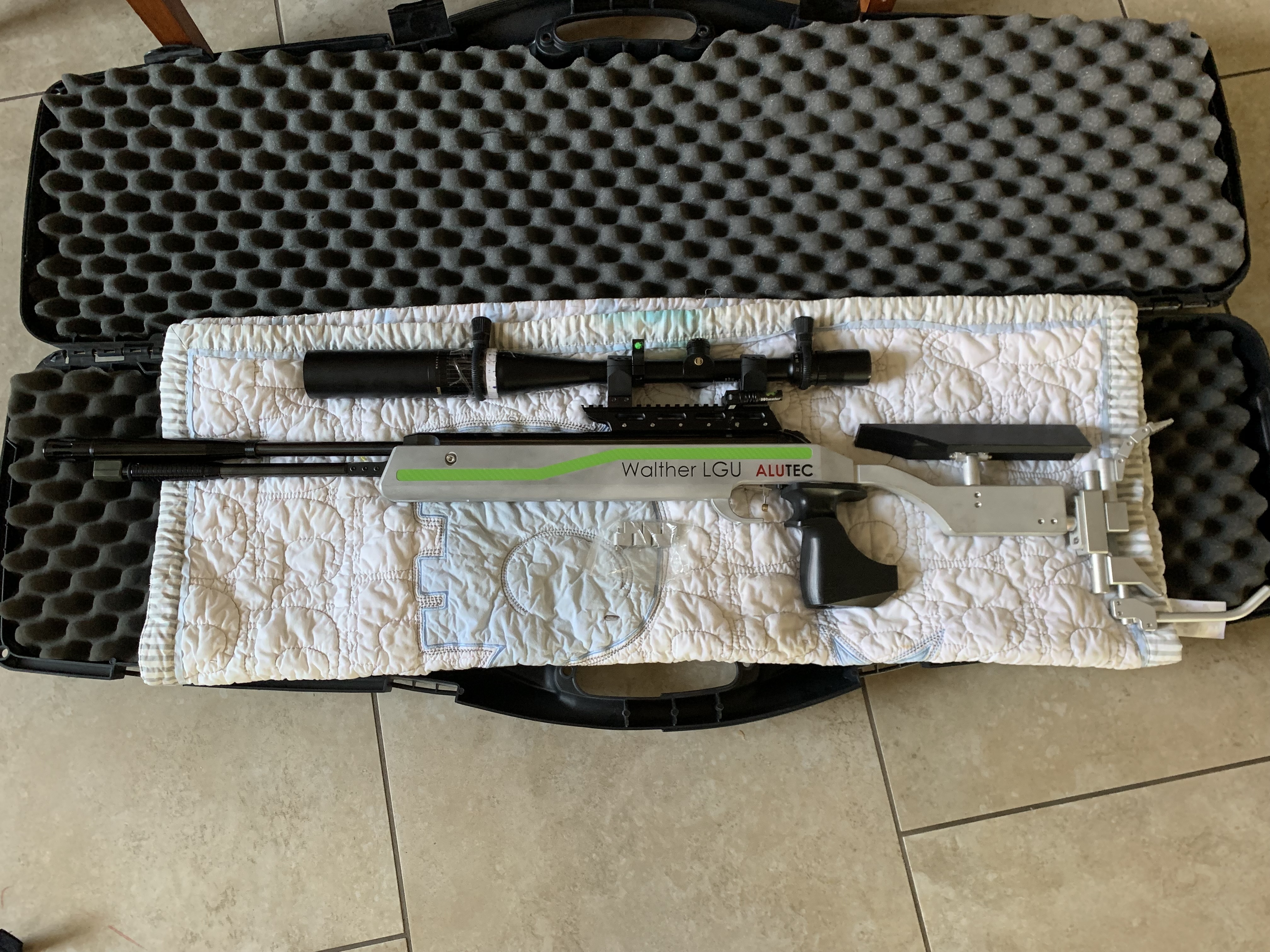

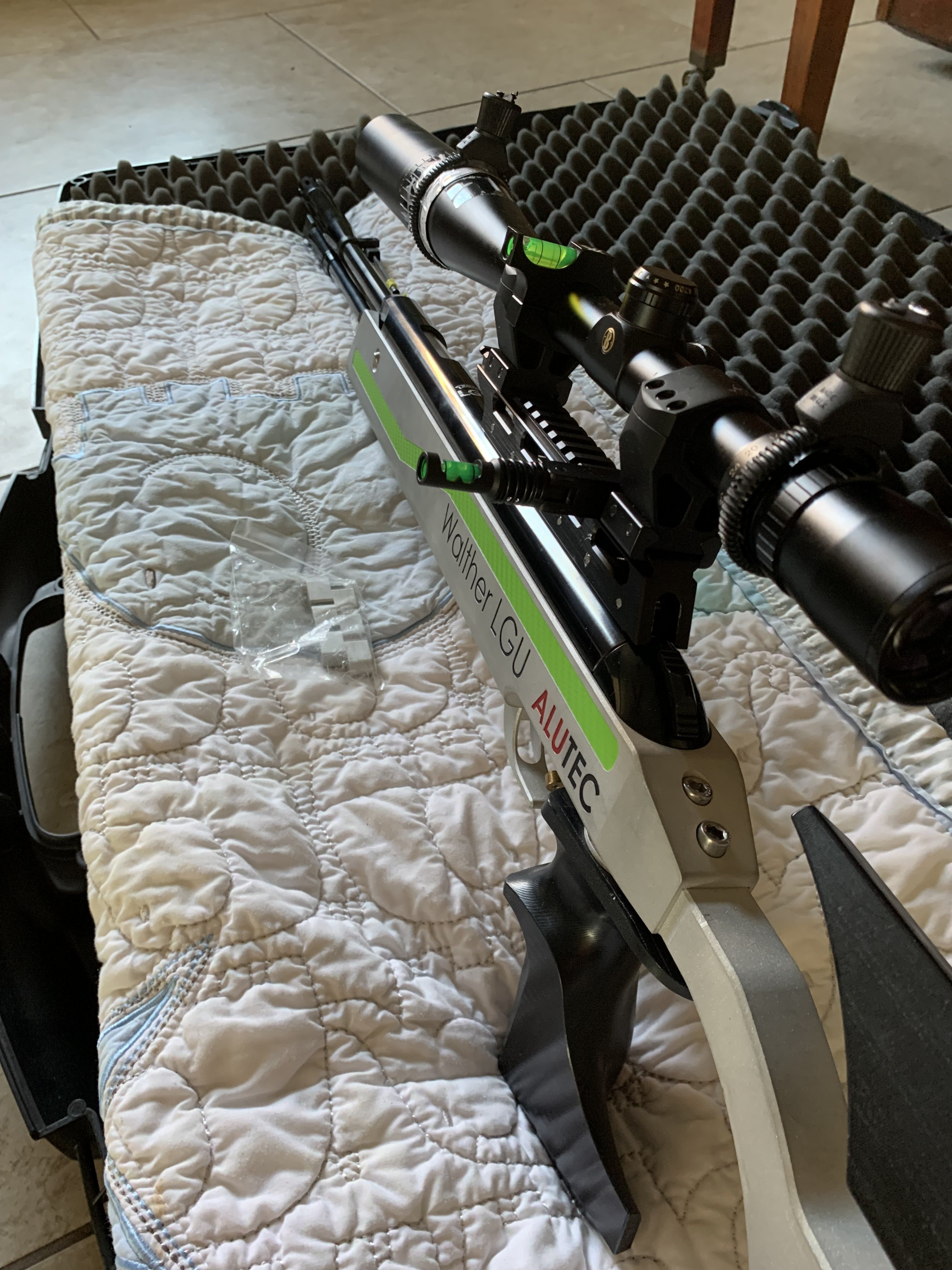

I have for sale a modified LGU for WFTF competition. The kit comes with everything pictured. The only thing you will need is a knee riser for the T slot system.
It comes with:
-Walther LGU .177
-picatinny riser rail
-Bruno Silva skirtless, lightweight piston
-Air stripper (Rowan Engineering using a muzzle thread adapter)
-button match trigger
-windicator
-Rowan engineering cocking aid
-Bushnell Elite 8-32x40
-Wheeler and Vortex bubble level
-Burris XTR scope mounts
-Bruno Silva Alutec stock

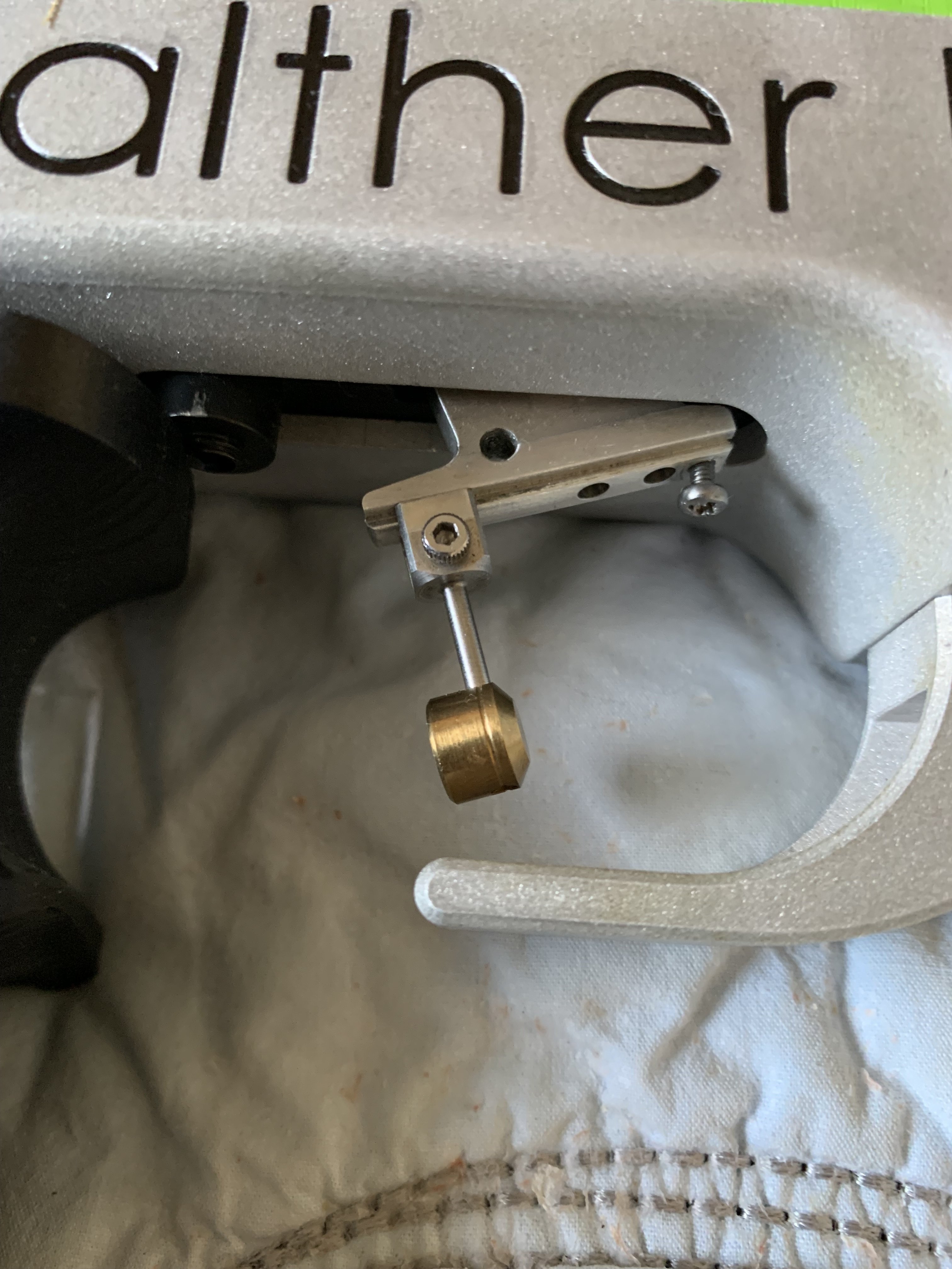

The rifle is an amazing shot. It has approximately 2 lbs of felt recoil. The only issue is the anti bear trap pin tends to loosen out, so I put a thin layer of plastic to hold it in place (as noted in pictures) and I have not had any issue with it for years.
This rifle prefers the AA 7.9 grains but it shoots any of the AA or JSB 8.4s very well also. The shot strings for JSB 8.44 (4.52) are as follows: 752, 752, 746, 752, 746.
Also note that the safety mechanism is disabled due to an aftermarket trigger install. Please be aware of this.
The reason I am selling is because I already have 4 fully built WFTF rigs and I just don’t have time to give each one the attention they deserve. So I will be selling some of them off in the upcoming months.
I will be sending the rifle $2,500 + 100 for shipping conus. I will be using usps. I have PayPal FF or Zelle. Let me know if you have any questions. Thank you!
