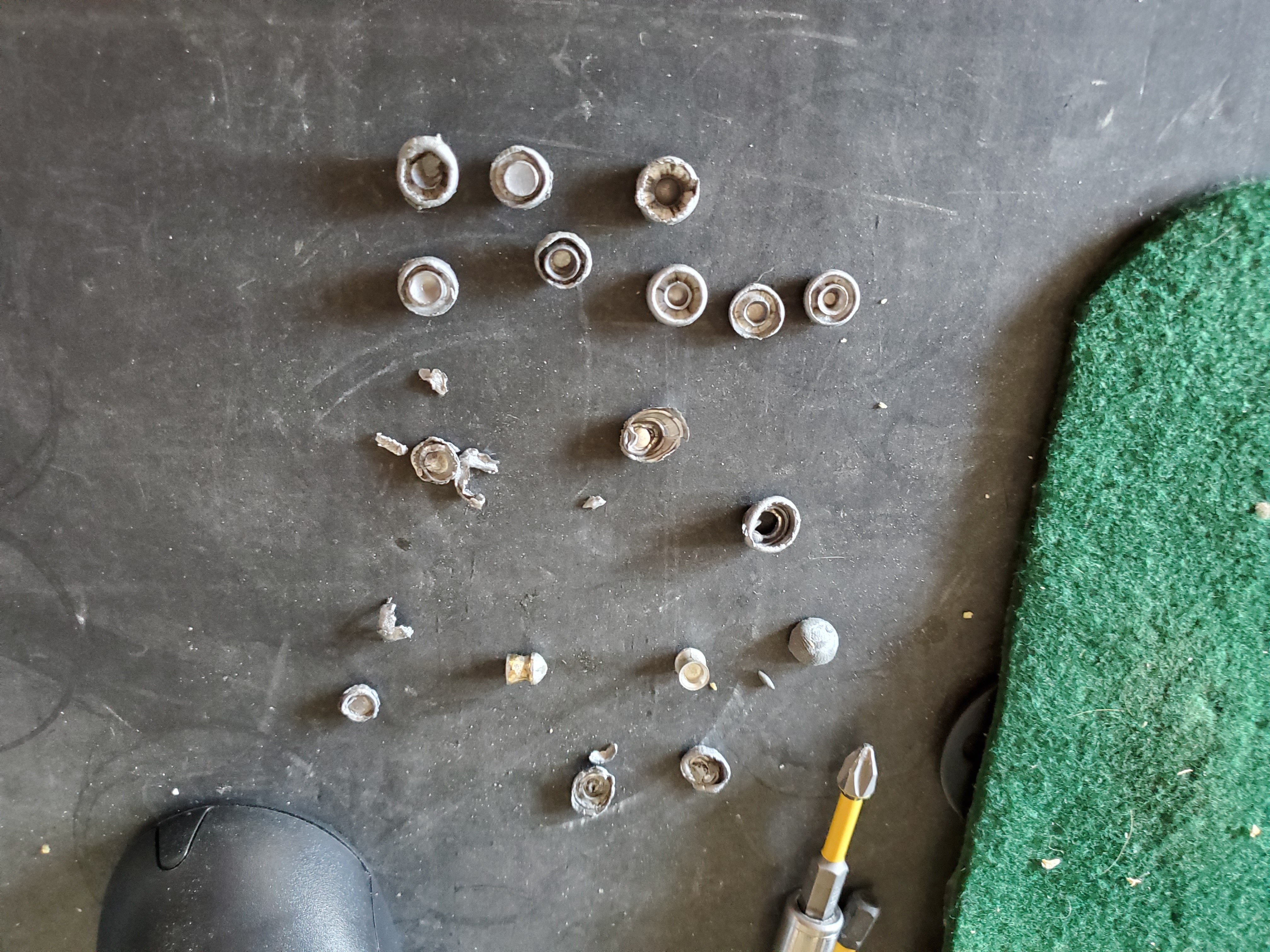

.22 FX Hybrid Slugs
Guns either love hybrids or hate them. I'm glad yours likes them. They should expand like crazy if they're stabilized. Take notes of your current tune and see how fast you can send them. The accuracy is nice, maybe shoot a water bottle full of water in front of the clay? I was sending mine a 930 into clay (plumbers putty) and it was blowing the back of the slug out, right side of Pic.
Thanks, yeah I'll set up a couple of 2ltr bottles of water to see if a more fluid target will get them to expand.
