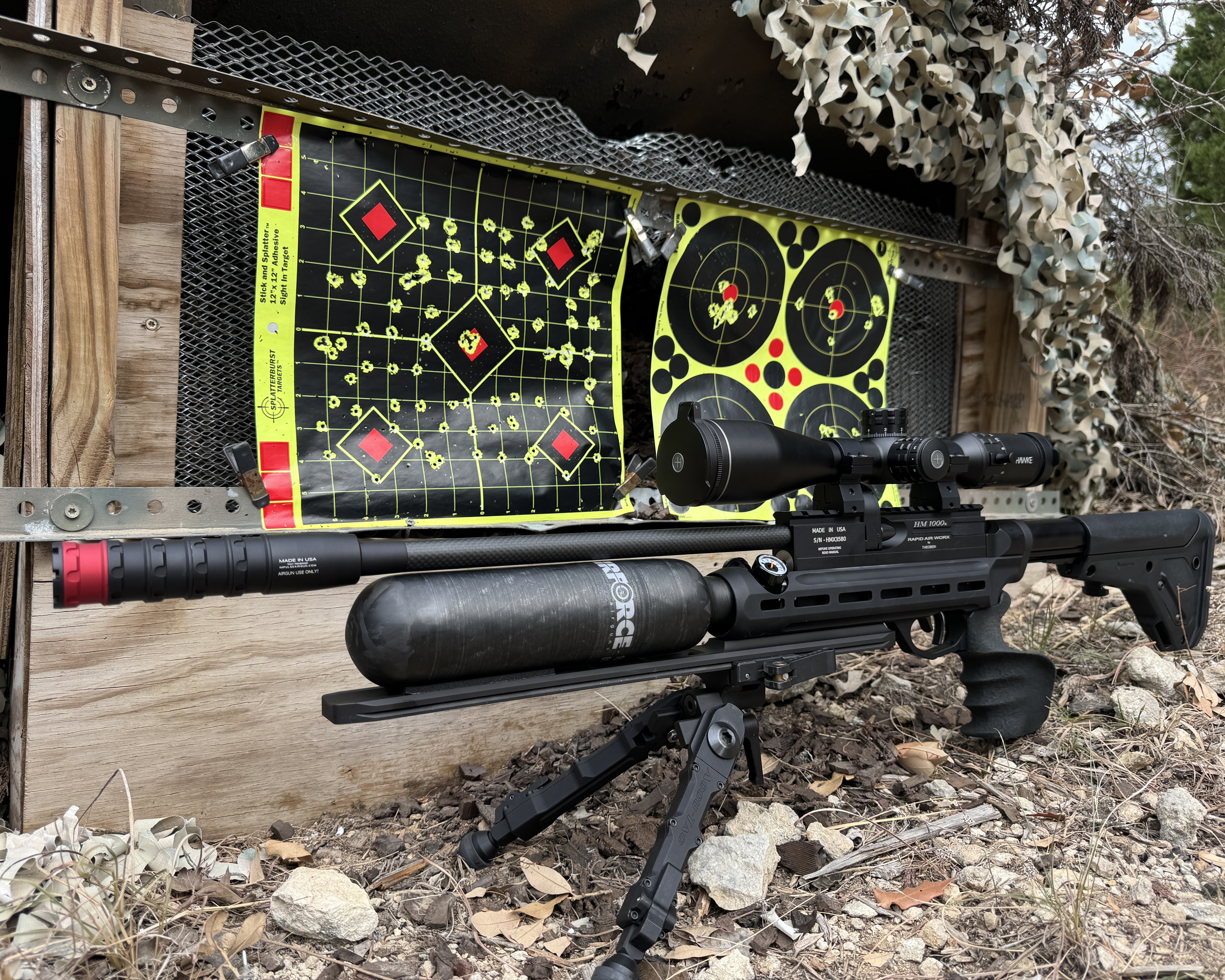

Update on new unit.. Chrono numbers at 51ftlbs stock with 30cal 44.75gr fx pellets 725fps. Venom booster regulator set to just under 150bar from factory. It seems I'm getting 3 mags from 285bar fill to about 150bar (36 shots). Id like to get Chrono strings to get an exact shot count from 300bar. It seems pretty loud with the 0db compact moderator. A little better with the Donnyfl tanto 30. Donnyfl shogun makes it backyard friendly. Probably going to turn it down to 690fps to see how that helps the report of this short barrel. I'll try to do a follow up post this weekend with a video. So far I'm liking it.
