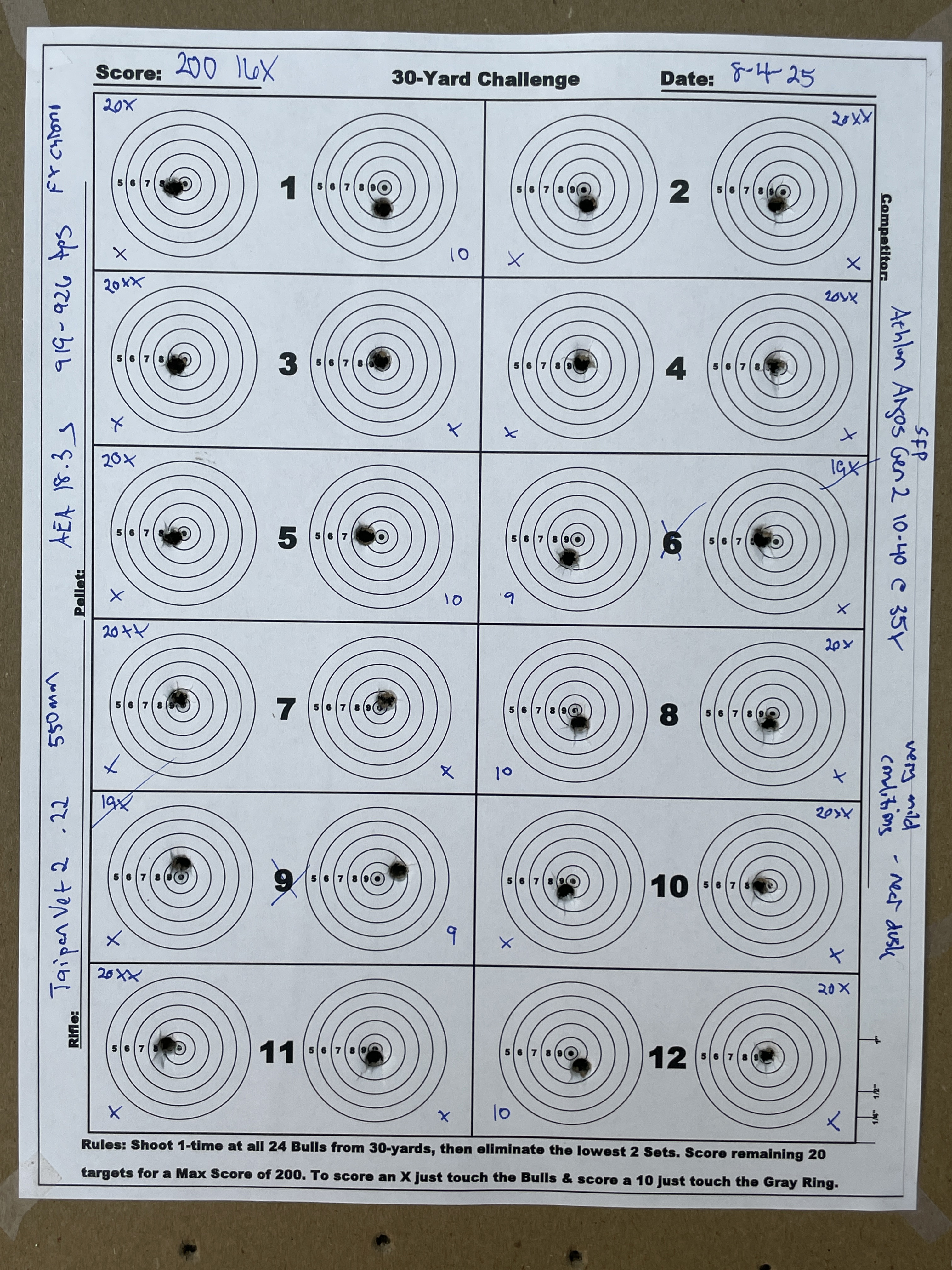

30-Yard Challenge
Date: 8/4/25
Target: 30-Challenge 200 16X
Rifle: Taipan Veteran 2 Standard (550mm)
Pellet: AEA 18.3g @ 919-926fps (FX Chrono)
Scope: Athlon Argos Gen2 SFP 10-40 @ 35X
The Taipan Vet 2 has been so accurate (and quieter) since I dropped reg pressure from 150bar to 128bar. This 200 tops the 199 that I had on the leaderboard.
It was the only card I shot with the Taipan yesterday. I was sad - needed a boost. Somebody hit my car while parked at a store lot yesterday - and took off. Quite a bit of damage - I love this Mazda3 and she is in great shape, I keep her very clean. Some people are just jerks - will cost me at least $500 (insurance deductible) if I decide to file a claim. Probably well over $1,000 if I decide to pay out of pocket.

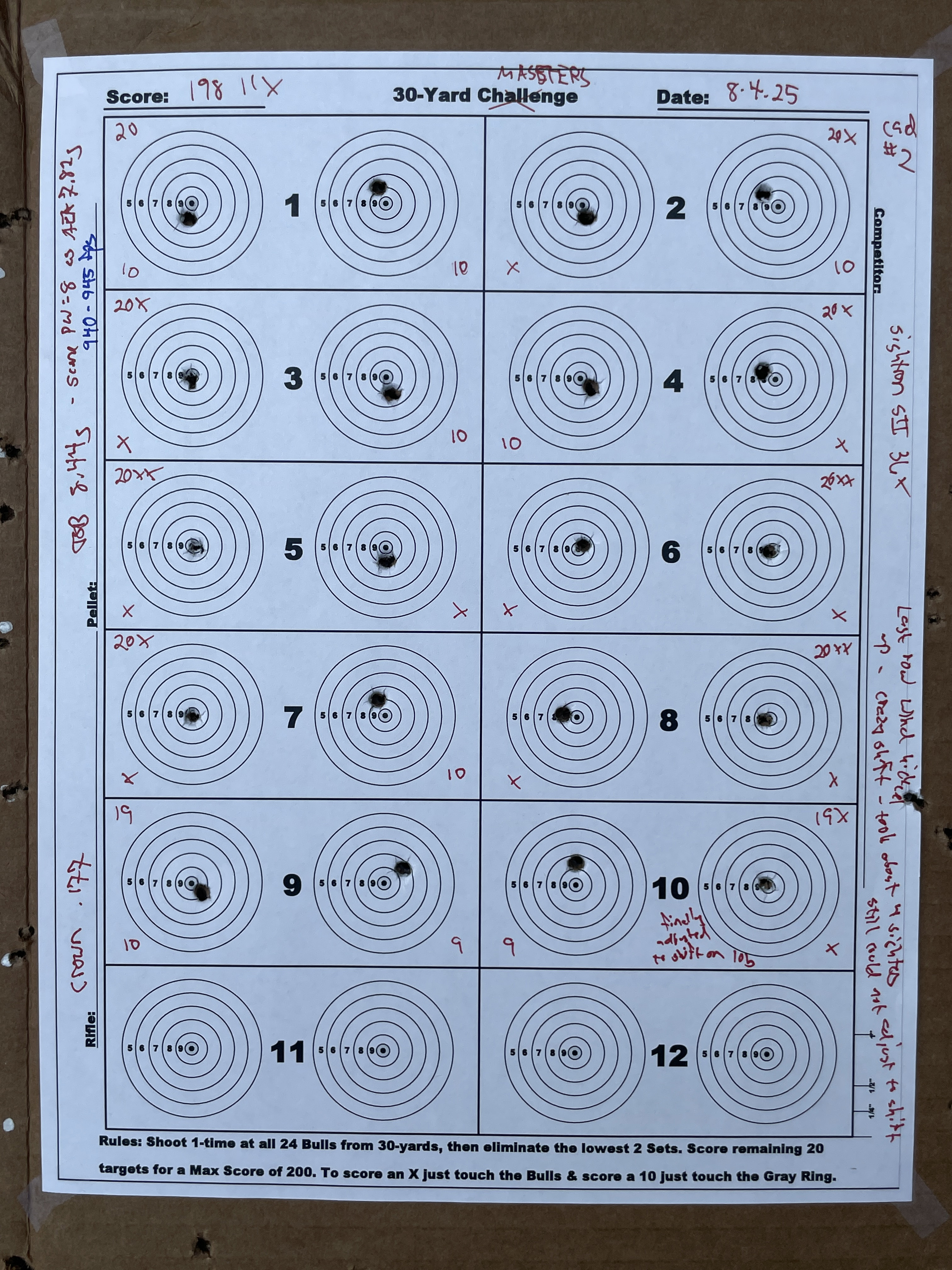

I also did some pellet testing with Greg's @NAProf .177 380mm FX Crown barrel. I found a tin of JSB 8.44 - so I gave them a try at 30-Masters - 1st card was a "baseline" using the AEA 8.72s I've had much success with in this barrel. The stunning thing was that the JSBs had a higher velocity than the AEAs - even though the JSBs were HEAVIER. I did a lot of chronoing - the AEAs are longer than the JSBs, might have something to do with the increased drag/friction. In any case, the 8.44s did really well - Greg take note...
195 10X (AEA 8.72 @ 915-922fps)
198 11X (JSB 8.44 @ 940-945fps)
197 10X (JSB 8.44 @ 942fps)
196 11X (JSB 8.44 @ 922-932) dialed down the power wheel a click or two
The 198 tied my 30-Masters high with the .177 Crown this year.
-Ed
