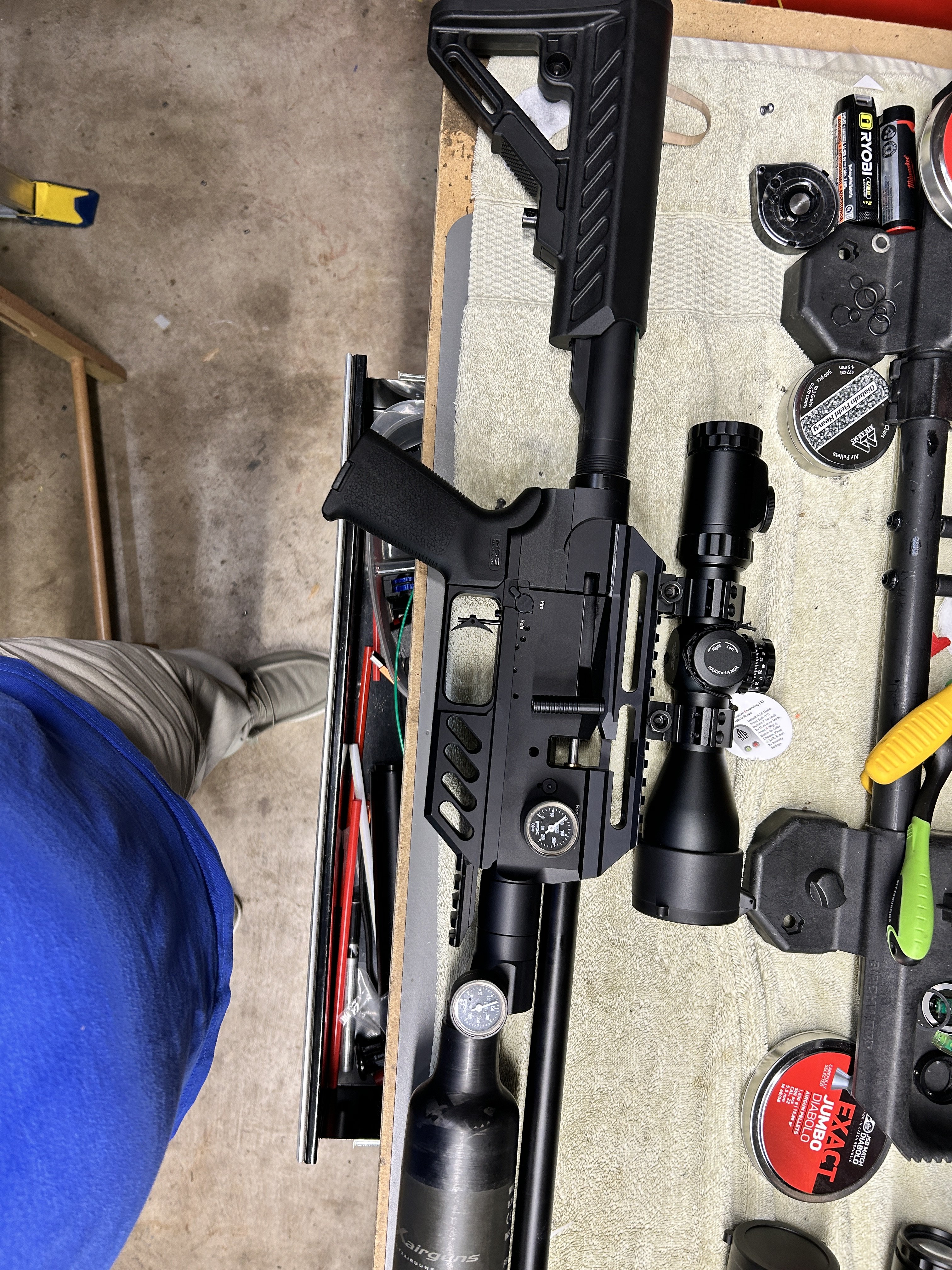

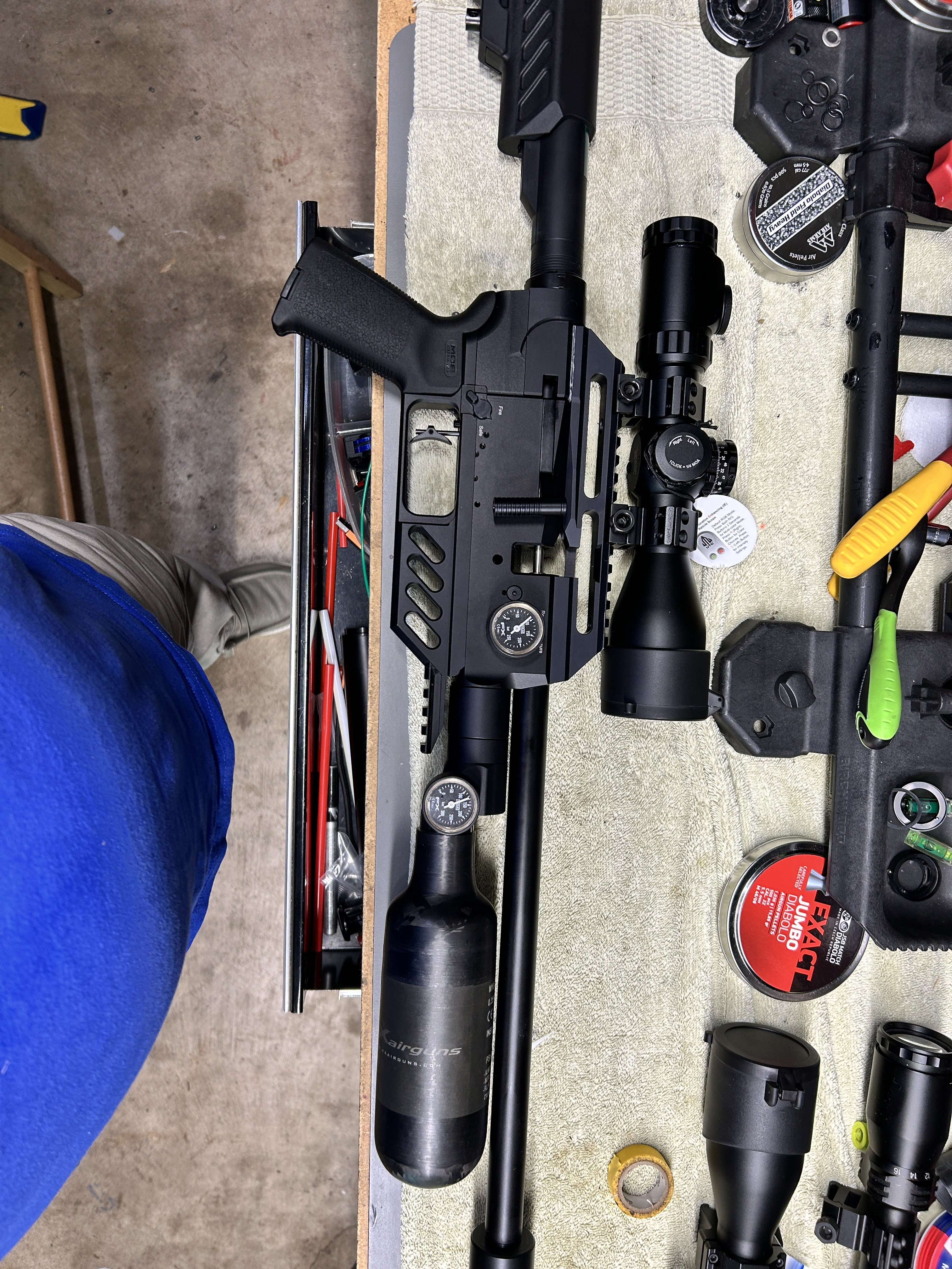

here is an interesting diagram from Skout about the lower frame and the air path from the bottle.
it “appears“ that there are a number of small allen screws along the frame. it’s possible that one or many of them could leak.
I believe that they used Red lock tight.
unfortunately, the only way to check them is to take the whole upper half of the gun off. 😳
I’ve done it before, but the three screws are a little awkward to get at if you don’t want to take your scope off.
