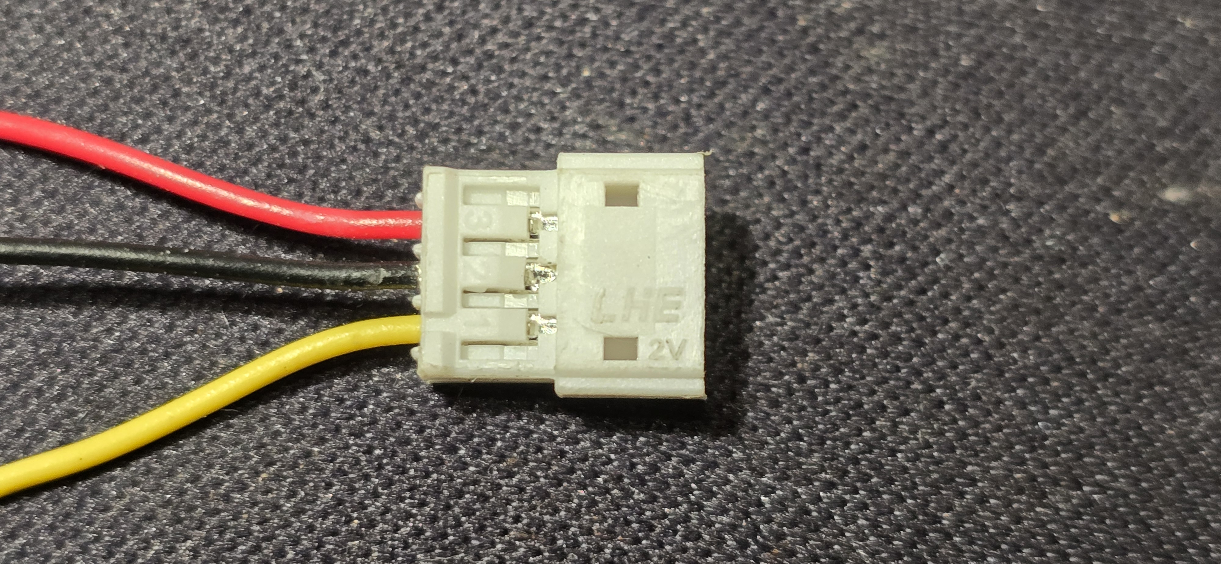

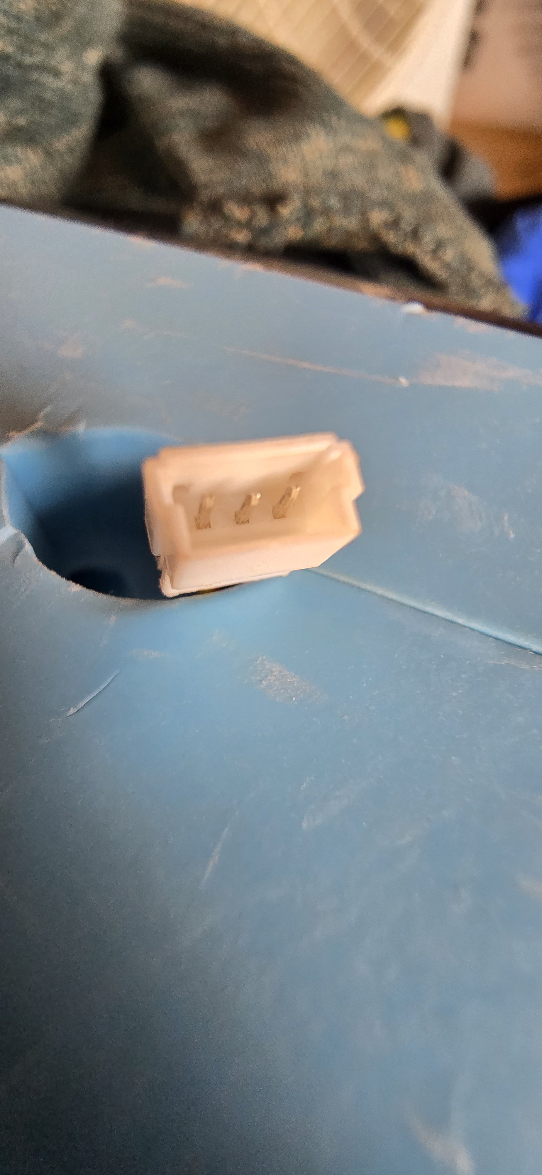

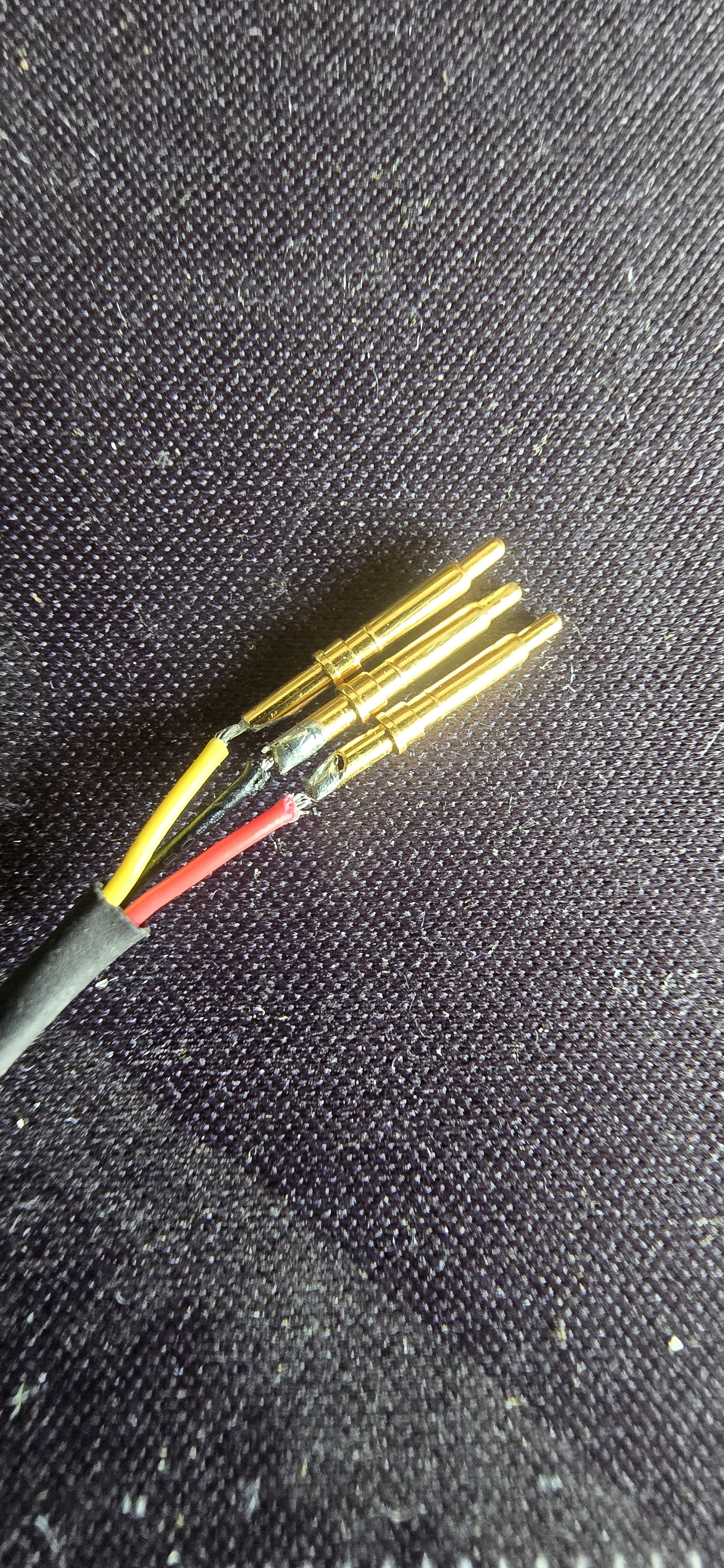

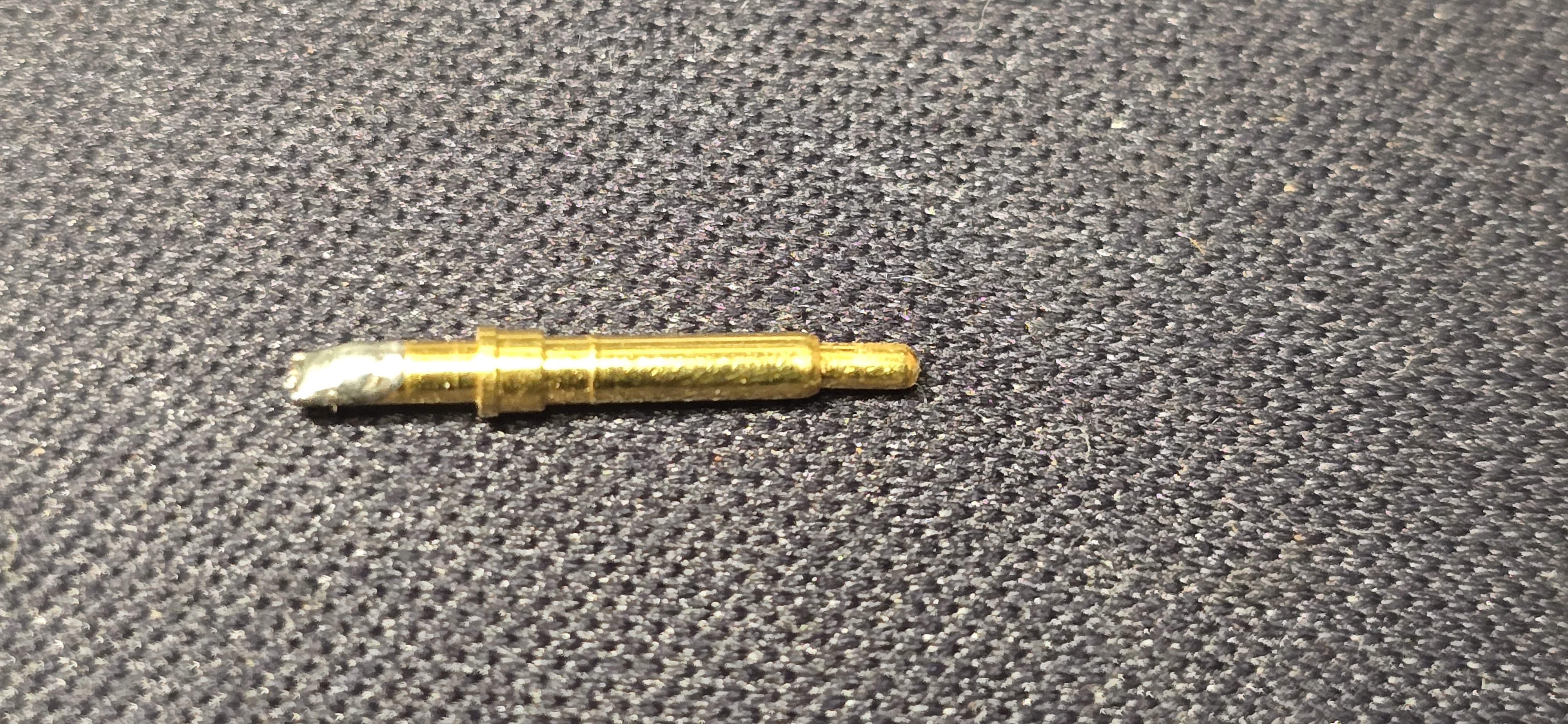

Hello everyone. One month ago, I bought the barrel tensioner for the Alpha Wolf from Daystate. To my surprise, when I connected it, the chronograph was not recognized. The original one works perfectly, so something must be wrong with the cable on this accessory—maybe a bad connection, poor soldering... I’m not sure.
Returning it is not an option because customs is a slow and cumbersome process. I’ve decided to rebuild the cable myself, but I have no idea what connectors are used. If anyone could help me by identifying their name, I’d really appreciate it.
Photos attached.
