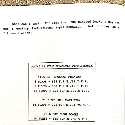

The Steroids produce more power at every pump stroke than stock pumpers. However, and the reason my post above is so confident in its predictions, EACH pump stroke is comparably more difficult than a stock gun. So assuming you (conservatively) imagine every stroke is 15% more difficult, you're not imagining hundreds of pump stokes 15% more difficult. 🥵
BTW, in most of my testing 14.3 JSBs produce more velocity and accuracy than Crosman 14.3s.
The image below is the last page of a chapter titled Benjamin PUMP! in my second book (copyright 2001), the chapter about my testing of a Steroid Benjamin 342, That chapter originally appeared in American Airgujnnner magazine. That rifle averaged 3/4" groups at 25 yards with peep sights. The reason the Crosmans are posted as 14.5 grains is because that's what they weighed on my reloading scales. Notice the last phrase in the chapter.
Reactions: Wadcutter

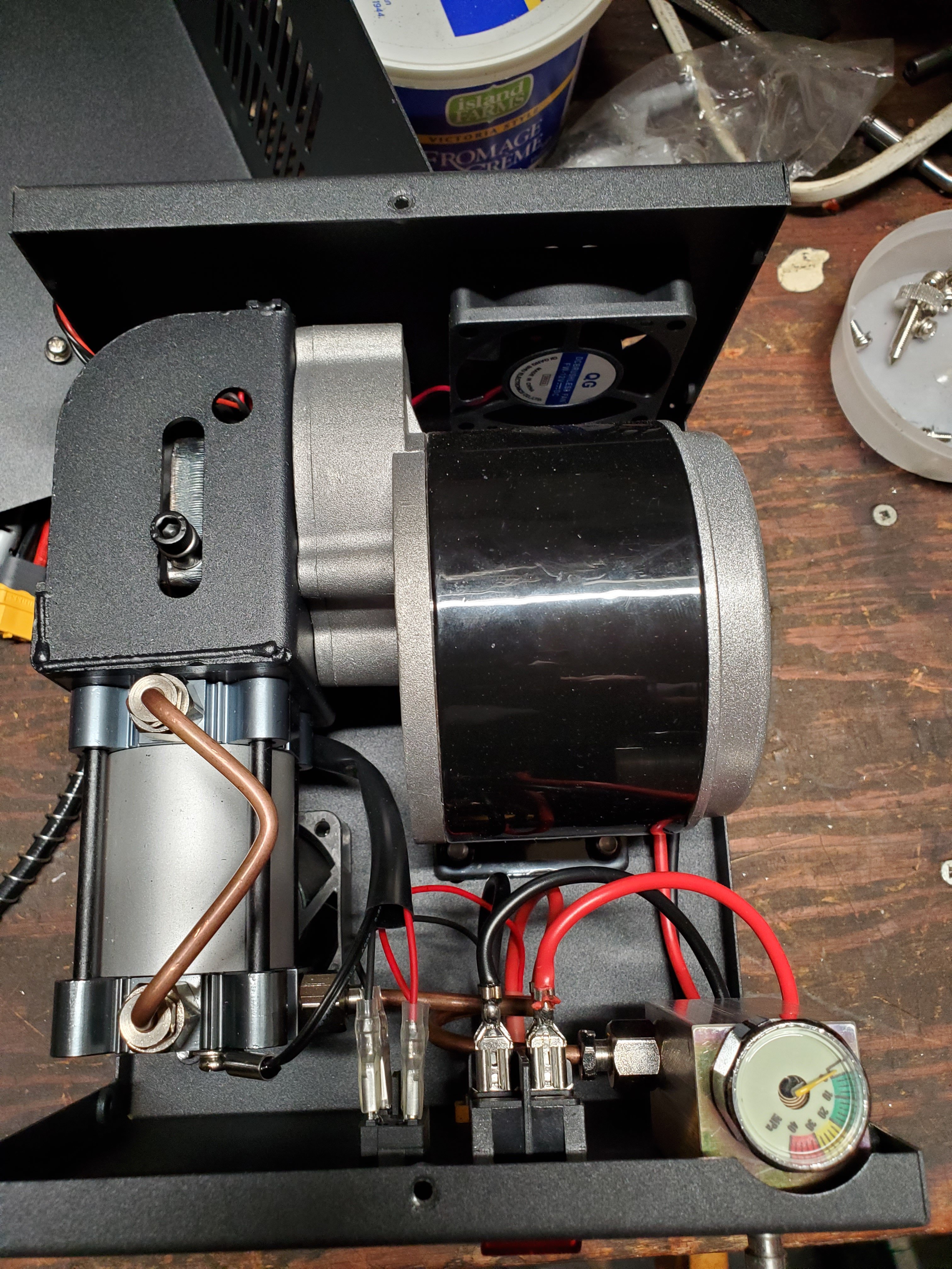

I posted this previously in the tanks, pumps, compressors forum, but haven’t gotten a response. So, I will ask here, does anyone know where I can order piston rings for an Autoins compressor?
It looks like what some term "Tuxing clone".
I have repaired a number of these and own a Nuong version. If that is the case, parts and complete cylinders are readily available. I have ordered from AliExpress and keep a spare on hand for quick turn-around on repairs.
Does the cylinder look like this?

Thanks to all respondents. I was able to find a new cylinder assembly for this unit. It will suffice until I can afford a much better compressor. Fortunately I do have a battery powered pump as a backup. I will look into a GX.
Do you mind posting the link for the cylinder? I need one as well...
