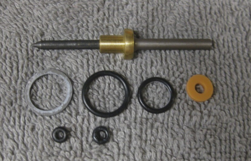

Hello,
I’m trying to rebuild a Racine WI era Sheridan/PMI 1 df paintball marker. It is powered by 12 gram cartridges, and uses many of the same parts as Sheridan traditional air guns.
Is there a source for these parts; new or reproduction? I’m particularly interested in exhaust valve pin/seal assemblies and co2 chamber face seals.
Thank you.

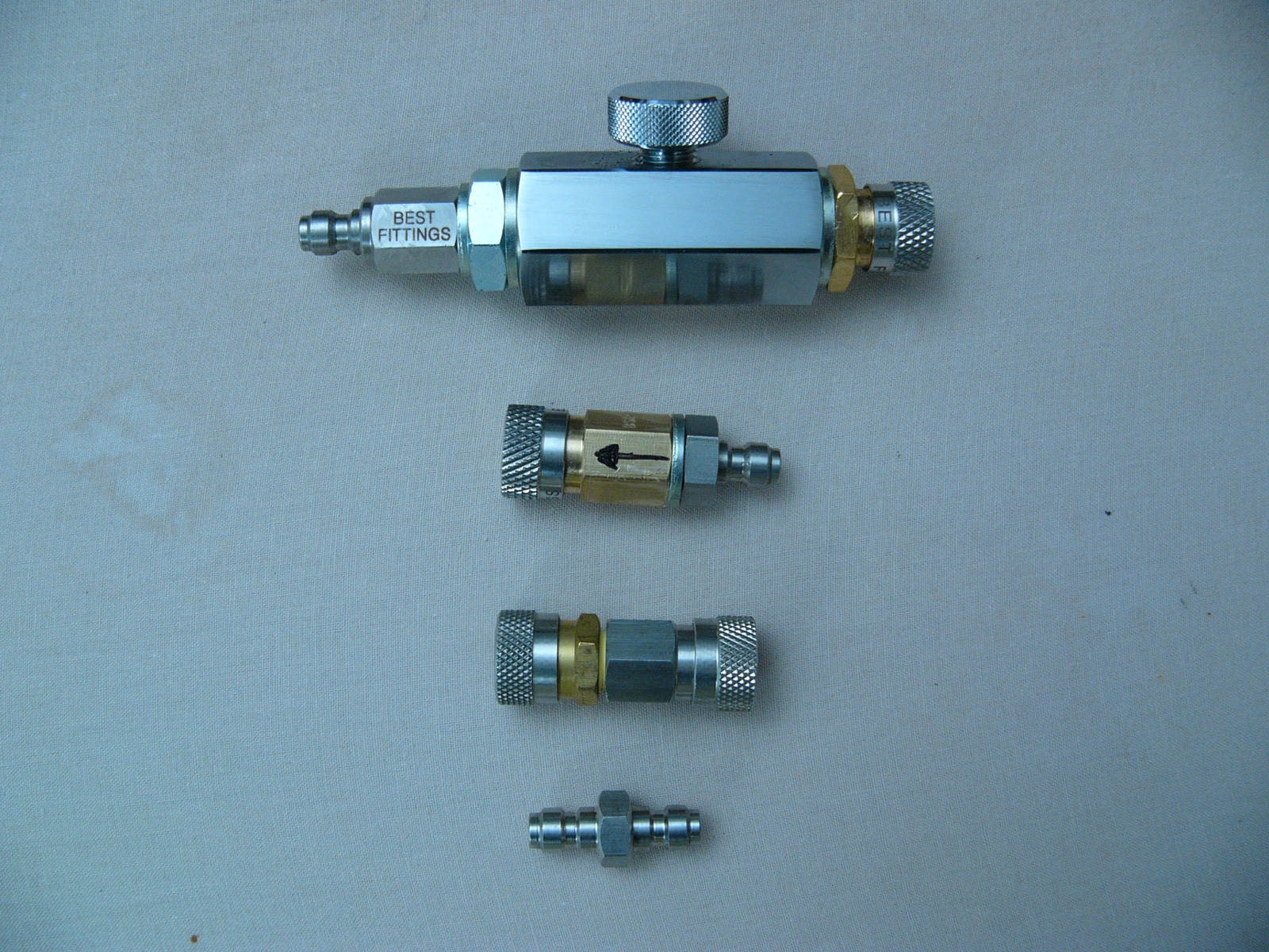

I would like to put a shut off after the moisture filter (in between the filter and the gun ) so i do not have to bleed off the pressure from the compressor / line , and filter to change guns when filling more than one gun . Or is this not a good idea as restarting up the compressor into an already pressurized line would be very hard on the compressor ?
Put a valve and bleed at each end of the hose/filter assembly?
I highly recommend getting a bottle whether it be paintball with a chinesium fill station or a chinesium scba. You don't have to wait, you already have a large store of pre conditioned air.
I've built a regulated manifold that allows two guns to be tethered up to an air source simultaneously, my buddy and I usually shoot all day off 1 enormous bottle I came across, no regulator needed because specifications were in line with our fill pressures.
shut off and bleed valve
I think it is a great idea, as long as you set it up with a one way check in the line before the filter so you can vent the pressure in that line before starting it back up - that will let the compressor start with no load and quickly get to the pressure in the filter.
Then you will need a vent after the filter followed by a valve that allows you to stop the air pressure from leaving the filter, but also a vent after that valve so you can depressurize the line to your guns.
It will take a lot of parts to make that set up, and thus won't be cheap, but it would work great. I have most of what you would need to do that, but not the valve. The picture below shows a line vent I made up from parts I bought from Best Fittings (if I reacall, those totaled about $45 or so) and some other speciallzed fittings that I also bought to let me do pretty much everything I want (I fill off a Shoebox, so my air is dried before it goes into the compressor). So from top to bottom in the picture, a pressure vent, a one way check valve that flows male to female, a female to female connector, and a male to male connector (the last two give me flecibility to use the vent or one way fitting in whatever direction I need).
As I said, it will get pricy as you will need a check vavle before the filter, and then after the filter you will need a vent, a shutoff valve, and another vent. You can either buy the parts to make up exactly what you want as one assebled item after the filter, or with fittings between them for added flexibility.
Hope that helps!
