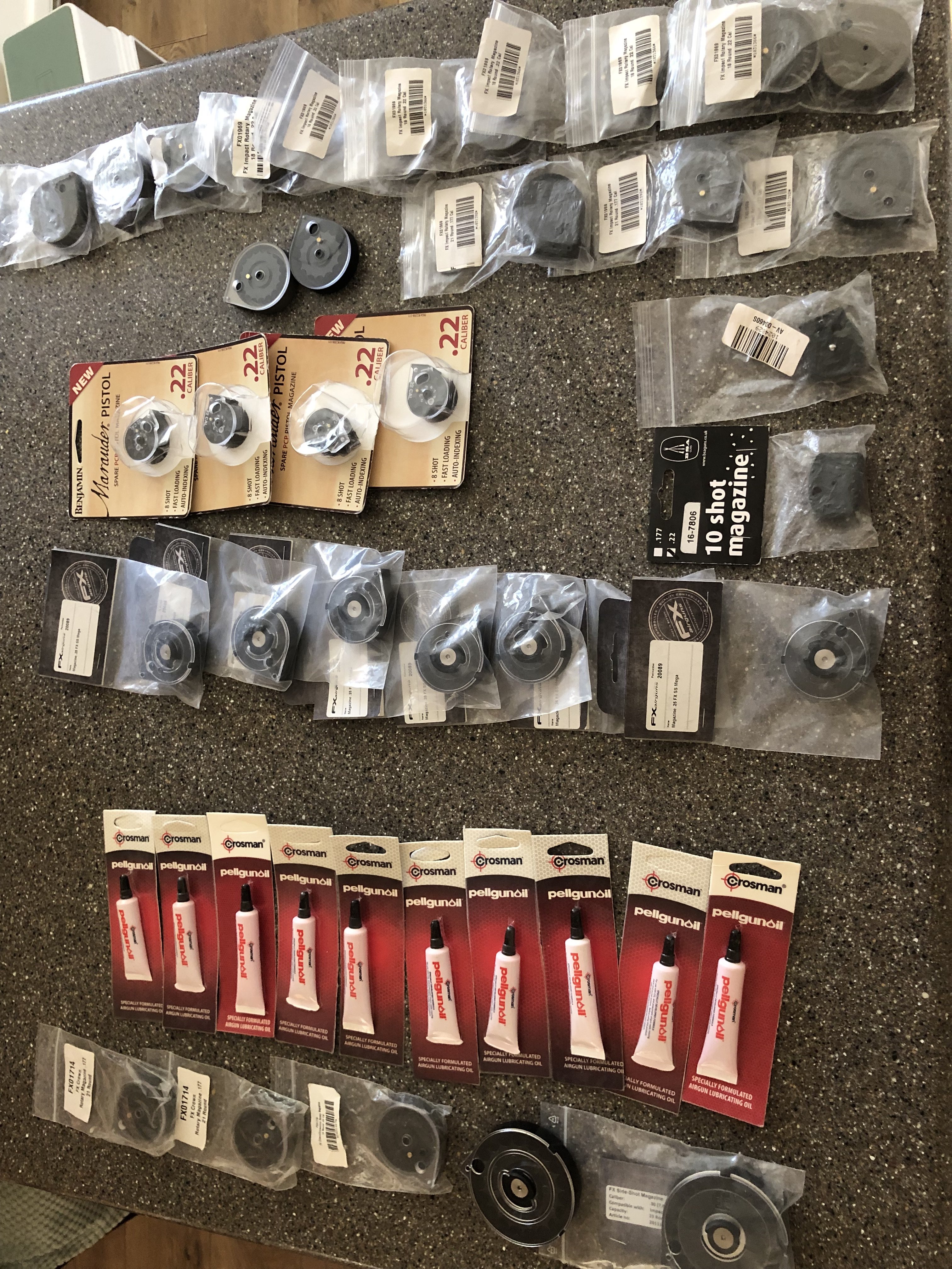

Magazines  SOLD 7x .25 NEW FX Maverick, Crown, Dreamline, Wildcat MKIII magazines.
08/04 5x sold, 2x left. ALL SOLD.
New, unused. ALL .25
This is the 1x pellet mag cover plate version. Fits the FX Maverick, Crown, Dreamline, Wildcat MKIII.
7x available.
1x for $40 shipped. Take 2x or more, and they'll be $30 per magazine shipped.
