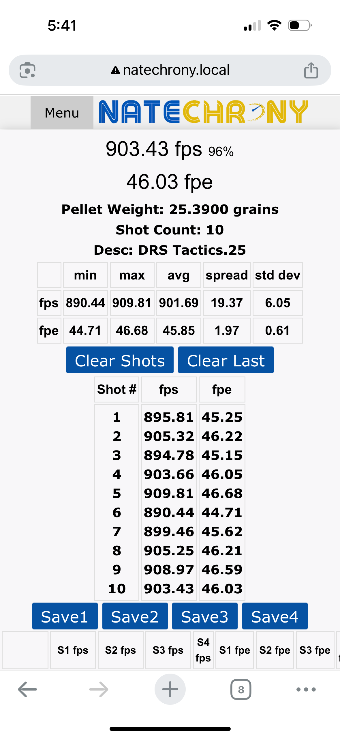

Never heard of the “knee”, as most of the YouTube tuning videos suggest finding the plateau and that’s your balance between pressure and hammer spring. I decided to adjust to the knee on my .25 DRS Tactical, I found the plateau at 934fps at 90bar, adjusted the hammer spring wheel down til I got to an average fps of 901. Sound right? I’d like my spread to be tighter, but shooting paper it was really accurate at 50 meters.
