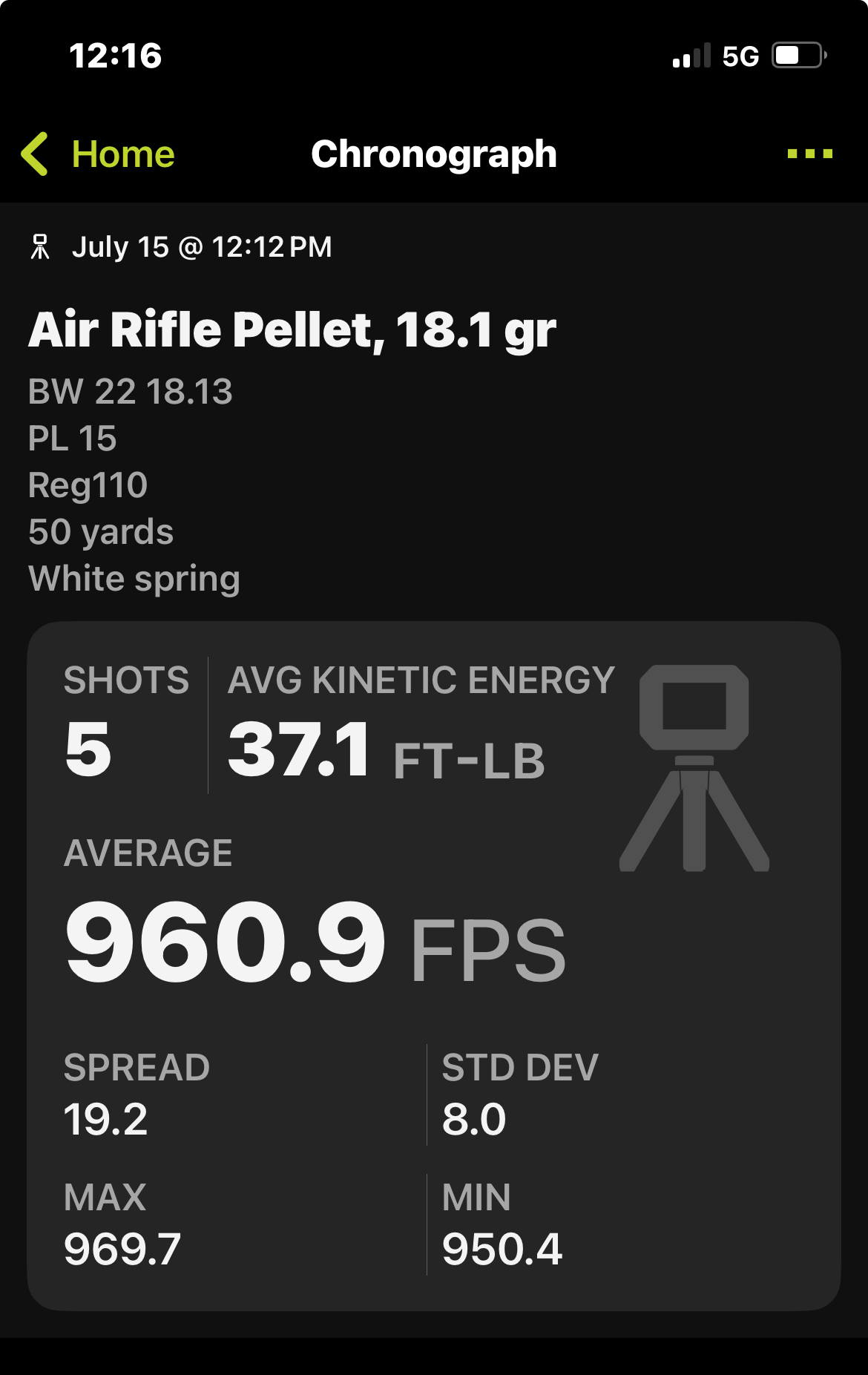

I was having the same problem, I finally got it to shoot good, I have set my reg at 110 bar and white spring at PL 15 with 22 18.13 I have 23” barrel 50 yards
