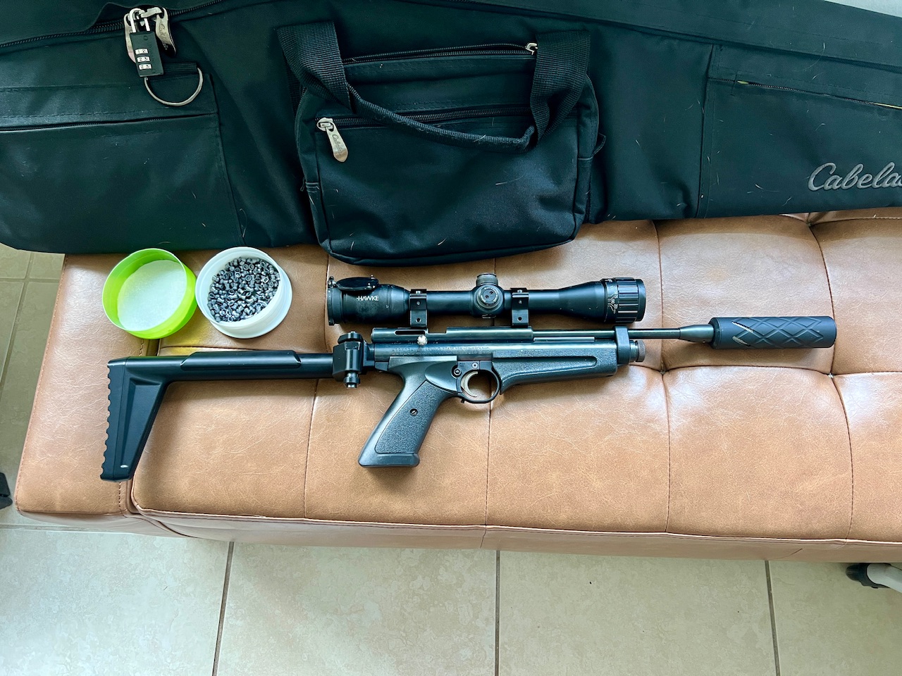

I got my 2240xl with some mods back in service with my Hawke fixed 4x. It’s ready for rodents and agamas. It’s been awhile since i shot CO2. I’d like to run it through a chrony string of a complete cartridge. It looks like a 12 year olds air rifle left out over night. But it is a rifle i loan out to friends with rodent or lizard problems.
I also replaced an oring in my modded dream Notos reg. Testing it overnight
Very nice, looks like a 2250. Love that BR folder, I may get one from Terry.
