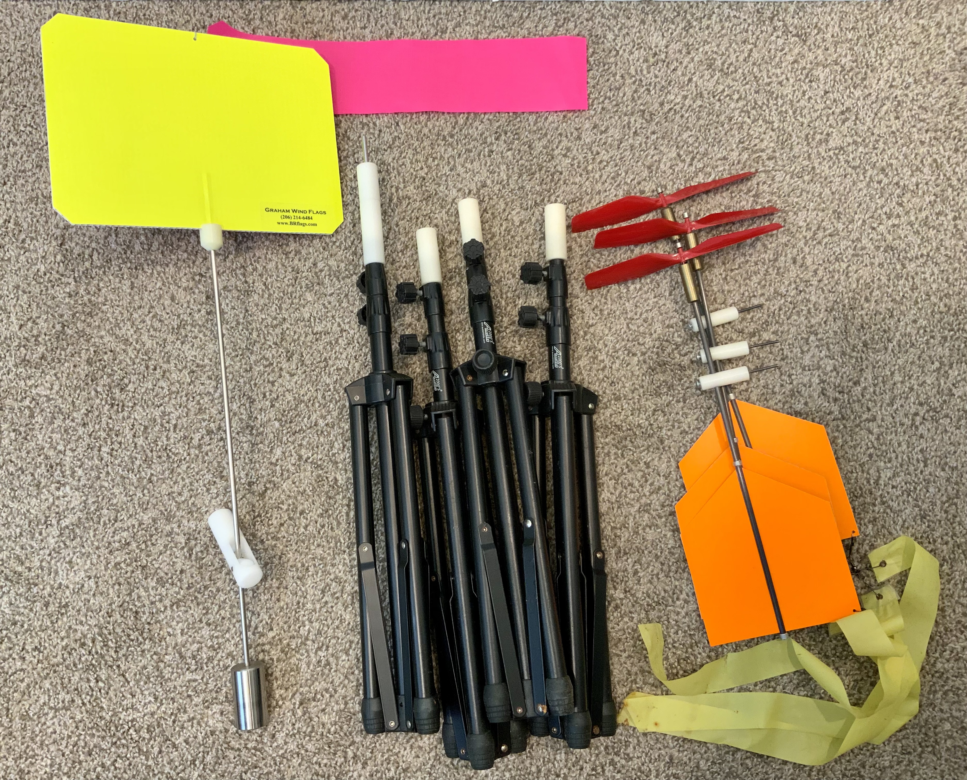

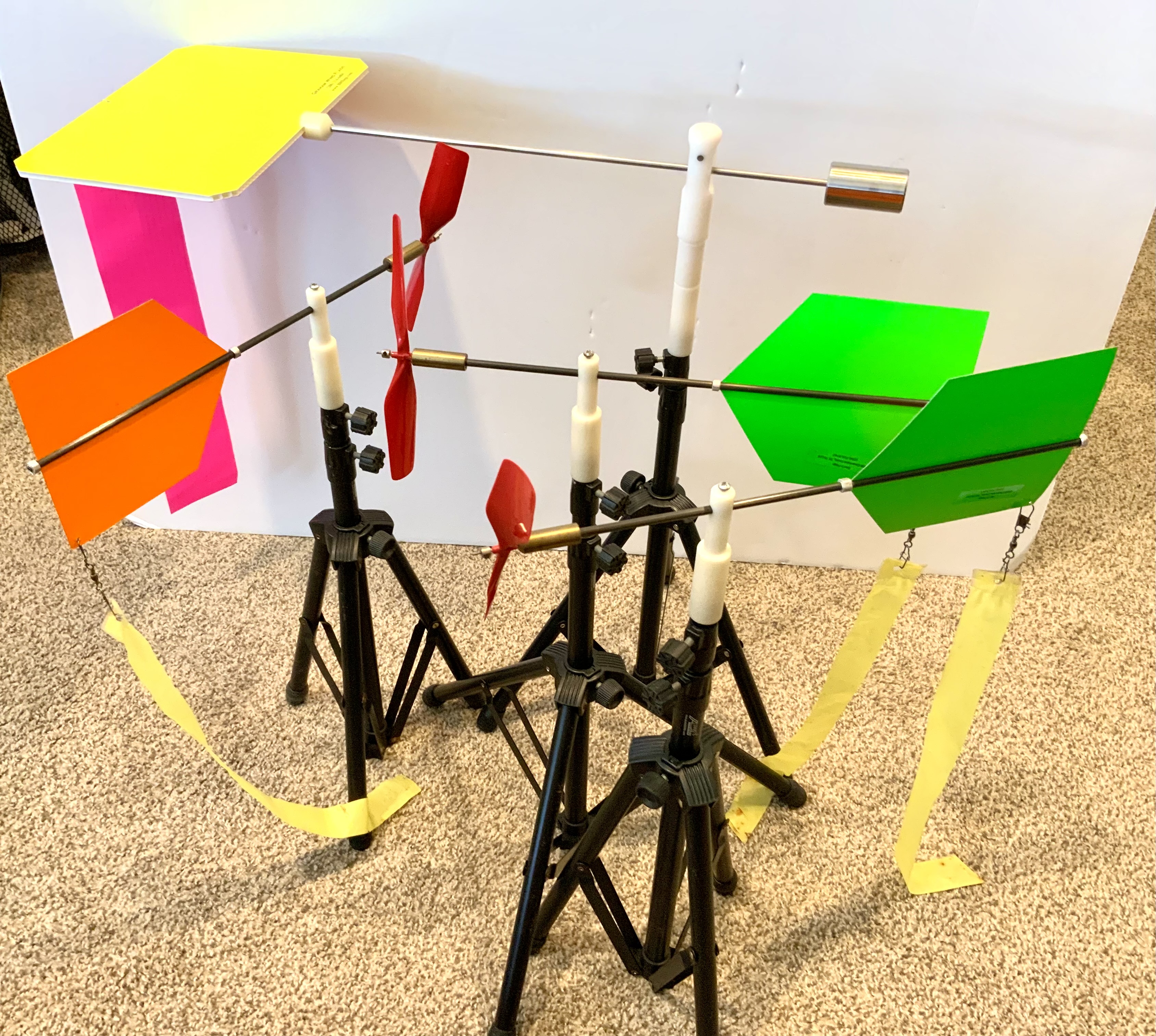

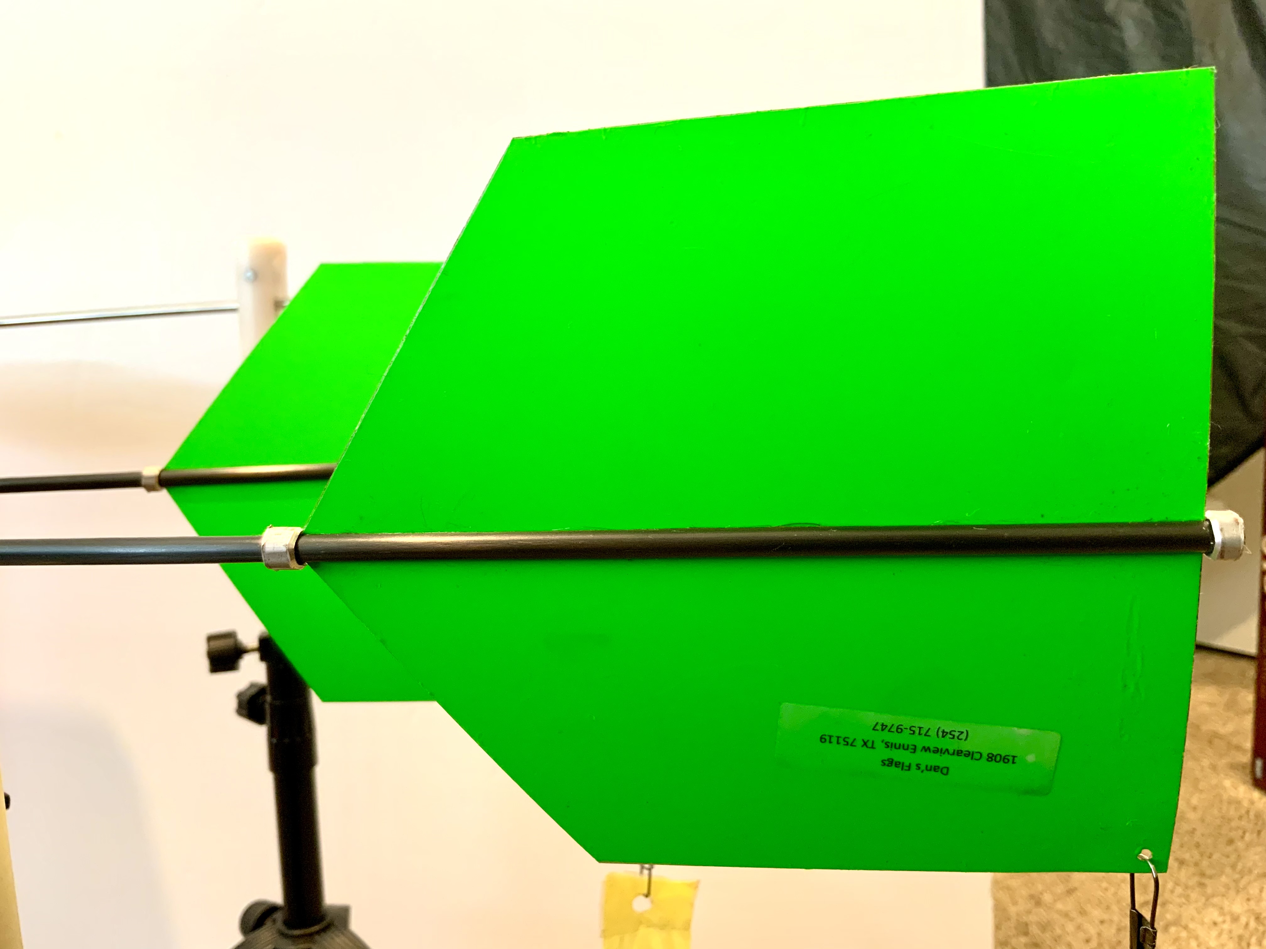

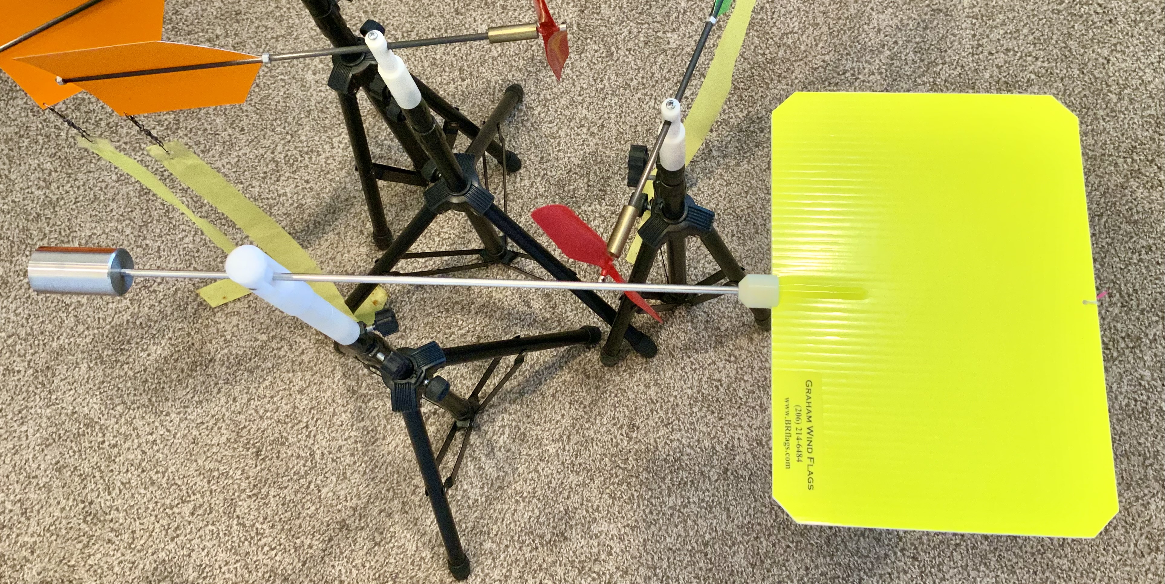

Wind Reading  SOLD Wind Flags
Up for sale are three (3) directional wind flags and one Graham Uppy-Downy flag. The Uppy/Downy flag identifies up drafts and downdraft winds found at ranges with baffles, berms, barriers, trees, gullies or swirling wind. The extended height of the stands with the flags is approximately 48”. All are in very good condition. I’m offering the lot for $85.00 delivered in CONUS. Payment by PayPal + 3.75% or Zelle. PM me with any questions.
