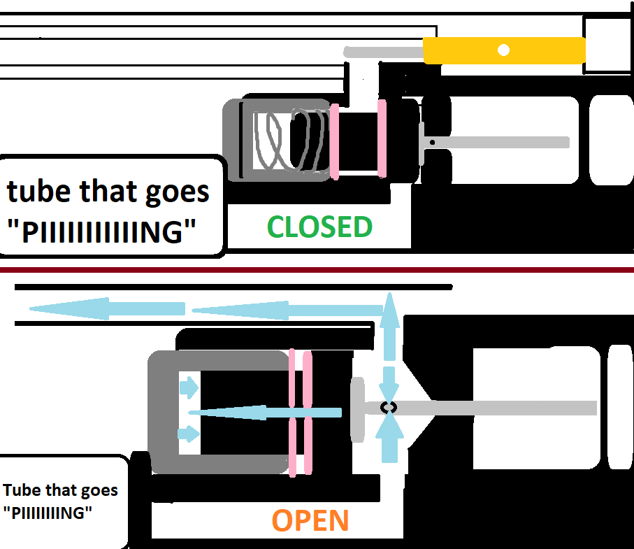

Hello All,
I have a new Air Venturi Avenger 25 Bullpup (2nd Generation). I'm new to the sport and still pretty green regarding the guns themselves.
I'm charging it with a budget compressor (Vevor) but it's working fine. From the first time I just notice as it's pumping, there's a faint chirping noise from the gun itself. A very consistent regular time chirp....chirp.....chirp. pretty much in time with the compressor.
I'm guessing it's normal. There's no sound after filing. No signs of any leaking. Maybe a check valve or regulator equalizing?
Oh well, although there seems to be no issue, it's worth asking the question.
Thanks All ..
