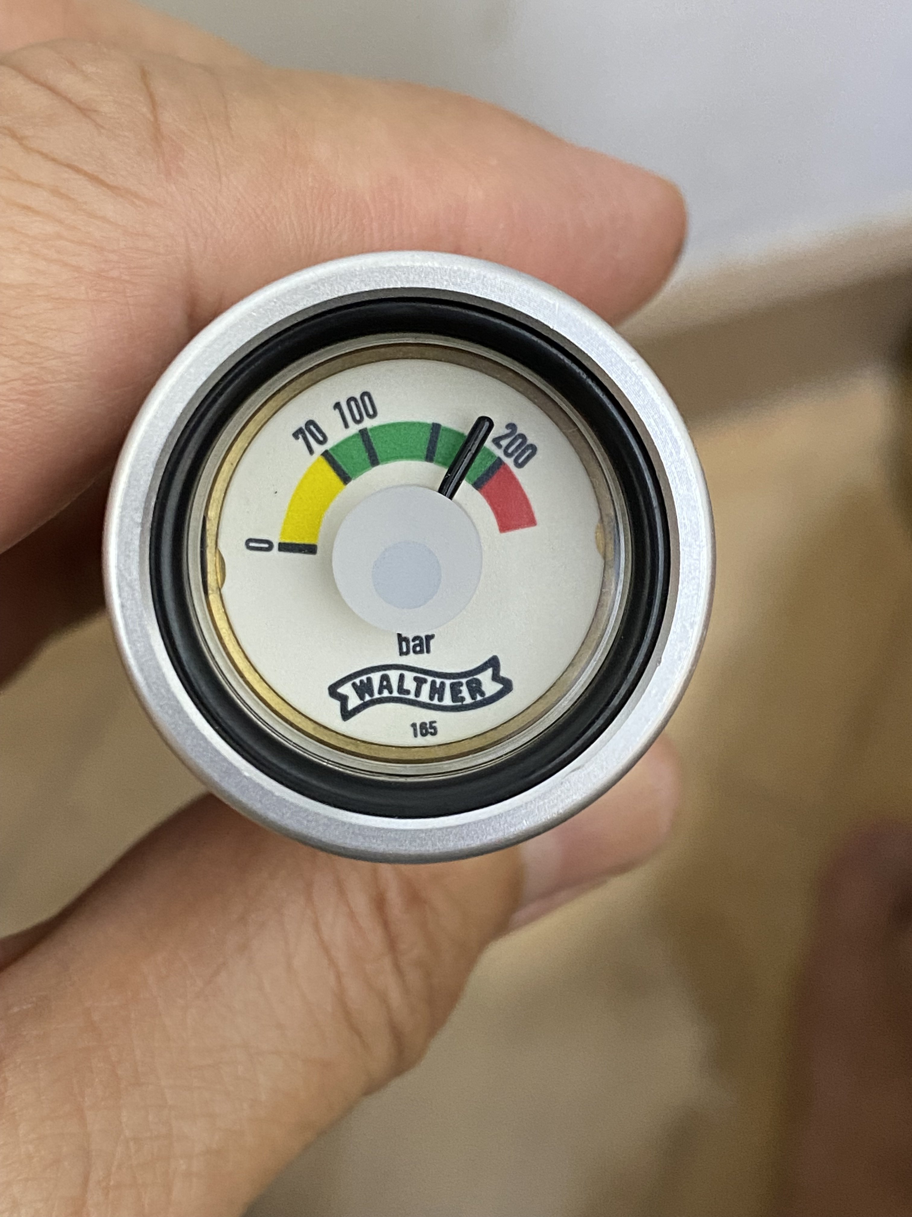

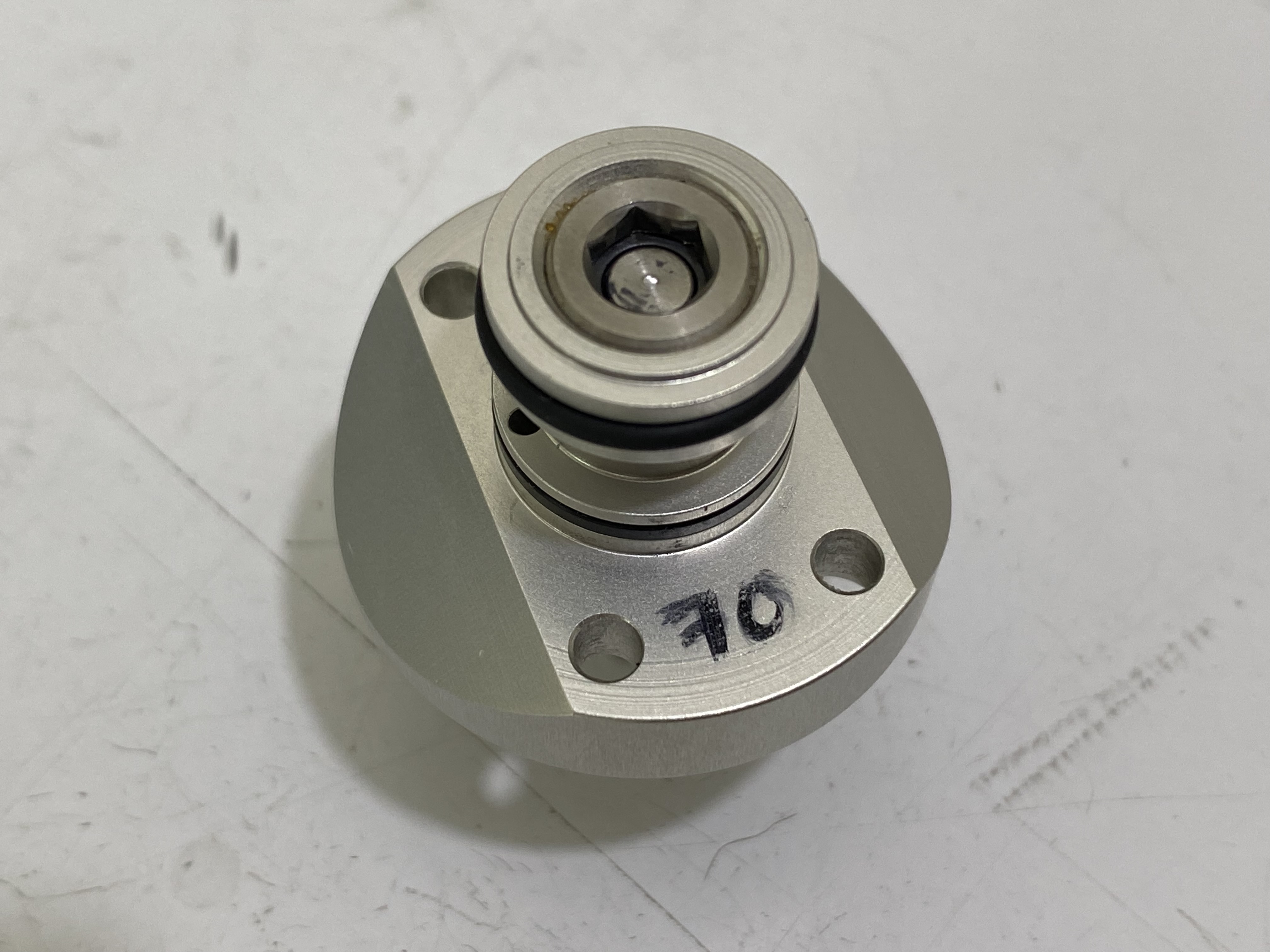

Other  Walther LP400 regulator pressure
This is my LP400 pistol which has undergone a major surgery to have all the O-rings replaced. Unfortunately it's still leaking so there will be more work to do ..... At the inner side of the regulator , there is a hand-written number "70" and the pressure guage marking has the color changed from green to yellow at 70 bars. Can it be safely assumed that the factory setting of the regulator is 70 bars ? Walther is not responding to my email enquiry.
