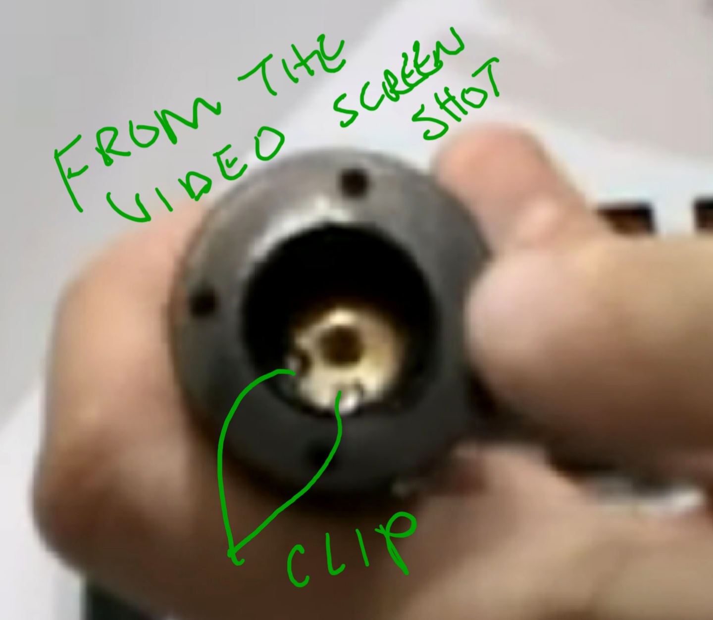

Hi Thomas, I took the gun apart 2 days ago and what you saw and what I saw in the video was the older version of the Artemis PP 750 the snow peak PP 750 is redesigned. I didn't know this but when I screwed out the end cap the regulator does not come out with the end cap it's inside the tube so I have no idea how to adjust it or how to get it out.

Hello @powderblue
I am not a gun smith but from watching that video I would think to not drill the holes to start with. Try to get the 14fpe by adjusting the regulator and hammer spring. If that gets you close, then drill the holes BUT only a very slight over size at a time. Dan went all the way out to start but he was looking for the MAX pressure, you are looking for less than max.
View attachment 20250817_202432.heic
View attachment 20250817_204844.heic
