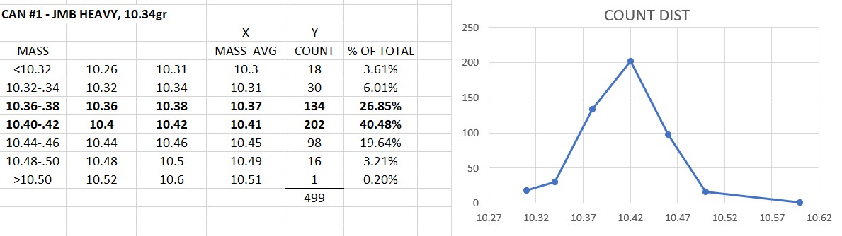

Regarding weighing pellets - The scale matters.....
You guys sort of allude to what I thought from the very first day I starting weighing .177 pellets - what weight pellet was the gun shooting the day it was tested? I am reasonably sure AoA did not first find five, 10.34gr pellets when they set my BRK up to 20ftlbs. They likely grabbed whatever was in the can of 10.34's, loaded the clip, and grouped up shots on a card until they were happy with the results.
What I found after weighing my first 500 pellet can of JMB's is only 6% were at the stated 10.34gr weight. This lead me to surmise that as long as the gun is tuned to say, pellets from 10.32 to 10.42 grains, your shots will likely be more effected by the gun & shooter. So now I just want to learn which pellets go in the plinking bucket and which ones can go to a FT match. I am particular about all the same points made by Geneeus wrt the scale accuracy and repeatability over the course of what turns out to be a couple hours at a time sorting. I feel a scale must read accurately to 0.001 grams to be useful at 0.02 grains resolution. Appreciate your input!

I am really curious about this process. I just started weighing pellets, and to do so, picked up a Tree TSC 123 multi-unit balance. The Tree TSC is accurate to .001 grams with a resolution of 0.02 grains when in "grains" mode. The scale takes a few seconds to zero after a measurements, so even if I could load pellets as fast as I could, the scale cannot zero that quickly without introducing error.
What I would like to know is how you all are setting the ranges for go, no-go pellets?
I started with this: JMB .177 10.34gr, 500 pellet cans. My sort groups are under 10.30gr, 10.32-10.34gr, 10.36-10.38gr, 10.40-10.42gr, 10.44-10.46gr, and 10.48 and up. After my first full can I can tell you that only 6% were in the 10.32-10.34gr range, 27% were 10.36-10.38, and almost 41% were in 10.40-10.42gr. (notable mention: 10.44-10.46gr, 20%). My problem with the sorter is more that the strain gauge must be a capable of measuring from 0 to 100 grains or so, and do so with a very rapid measure and re-zero cycle. Can you get this system to do that? Have you checked pellets after sorting on a balance to see how well it's weighing?
