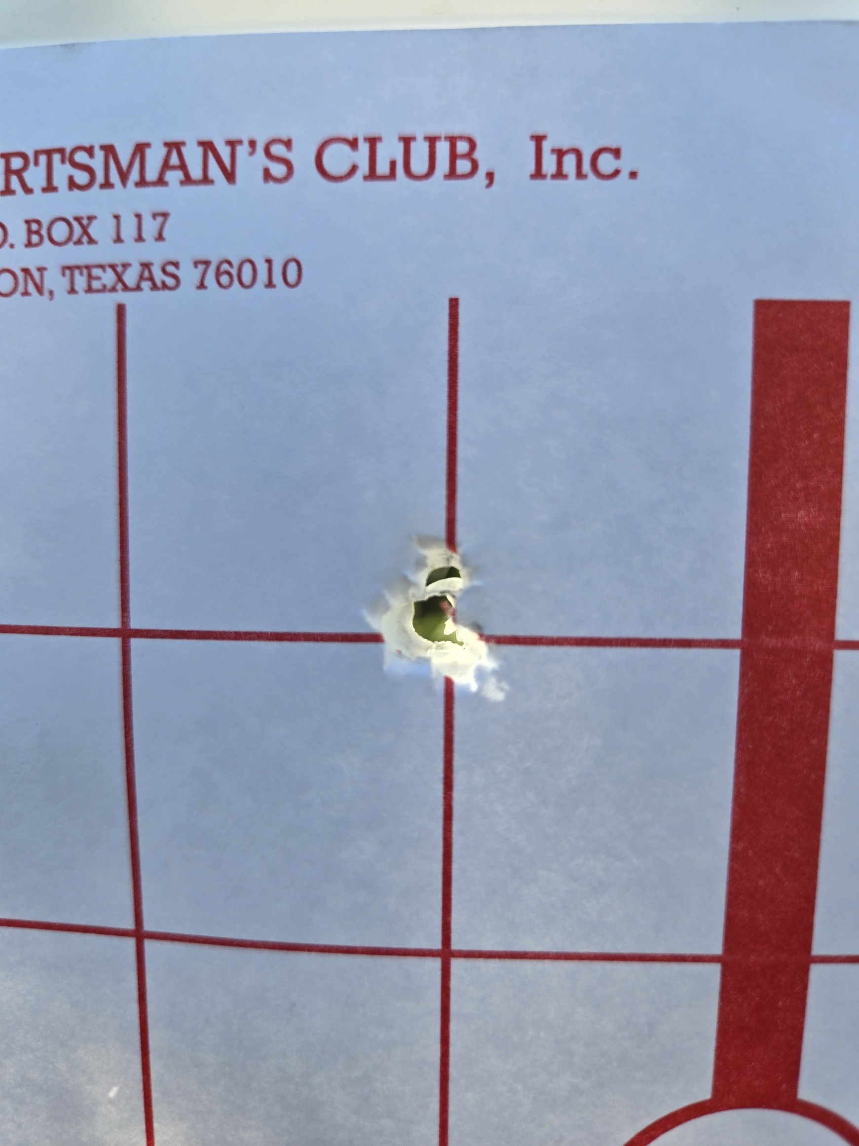

And another 5x5 at 100 yds with the Taipan vetran tactical 2 700mm in 25 caliber shooting JSB KO slugs 33.49 gr at 953 fps. Average of all 5 groups was 1.23 inches ctc
And with the kalibergun cricket tactical 2 60 in 22 caliber shooting H&N 217 21 gr slugs doing 927 fps. Average of all 5 groups was 1.04 inches ctc.
So today the Kalibergun beat out the Taipan
View attachment 594772View attachment 594773View attachment 594775View attachment 594776
