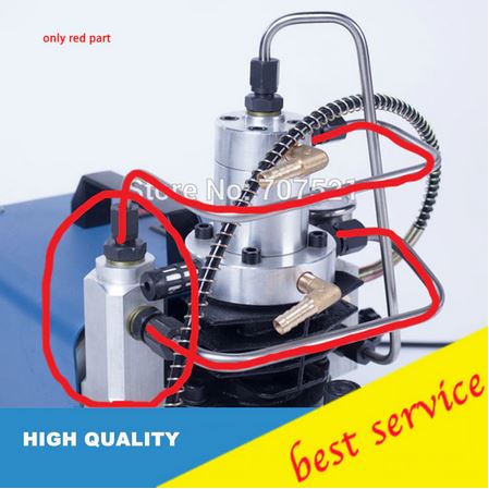

Hey guys, I have Yong Heng pump (simple version) just 2 weeks. I'm very impressed how fast does fill my cricket standard. I think it took 1min and 26sec from 110-250bar. But I have one question. If I would buy these parts from:
https://www.aliexpress.com/item/32850995186.html?spm=a2g0o.cart.0.0.78213c00VGppin&mp=1
Does became from my pump HARDCOVER version?

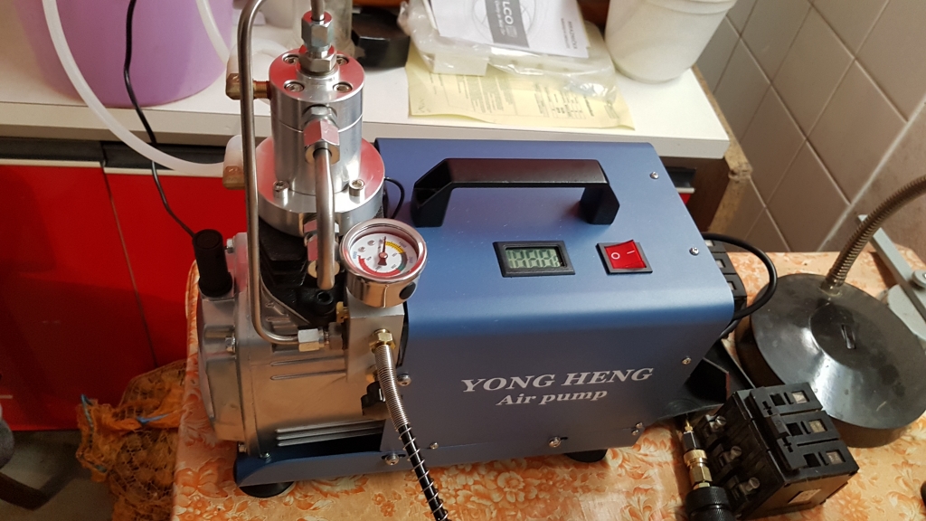

My pump is here:

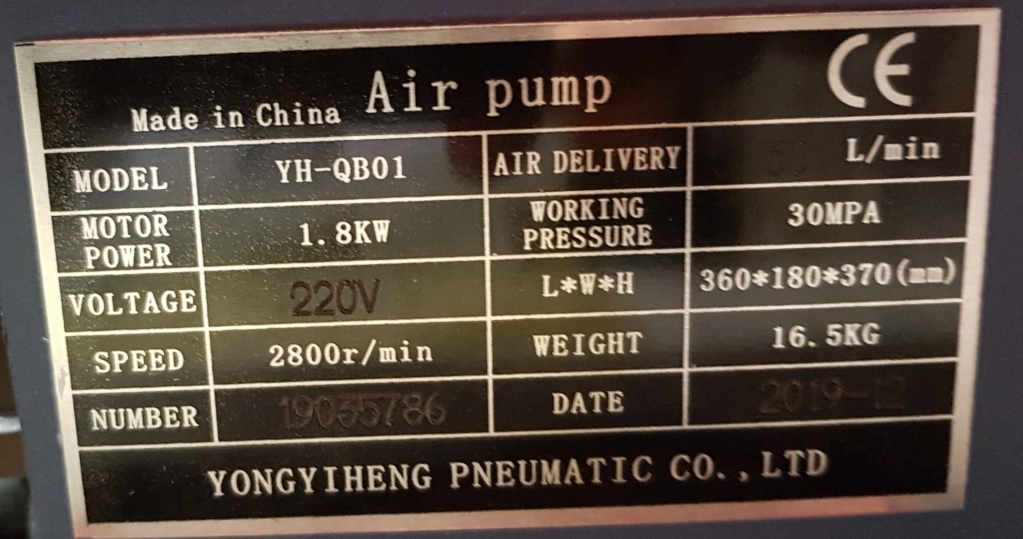

and label show date 2019/12 relatively new... So probably with new piston?
What are benefits of this additional parts?
The reason I bought SIMPLE version instead HARDCOVER is I found very good price $215 shipped from Poland store without taxes and duties. They were not any possibilities others were gone - sold out :(
Does have effect for quicker filling or better water separation? I think I'm able to add these parts to the pump...

All the parts are retro-fittable. The parts in question are supposed to separate moisture between the low and high stage. I think that they do a reasonable job. IMO the basic version should be OK as long as you include a desiccant filter between the pump and bottle. Buying the model that you require would have been a better choice than buying a cheaper version and updating with spare parts. So the answer to your question is yes it's possible but is it necessary? Probably not.

I think you are correct that adding the parts will change it to the Hardcover version and that it is a great idea. I have the YH with the water separator and it does separate a good amount of water from the compressed air. Yes, you can use a filter to do that but it will cost more as the filters will need to be replaced far more often than if you had the YH unit with the separator installed. I have the small YH filter and a gold filter with the three part media inside. I purge the YH unit every five or so minutes of run time and change the small YH filter out after every 20 minutes of runtime and it is damp. I set it aside and let it dry and use it on my next filter change. I have run my YH for a year and the large filter is still not in need of a change.
