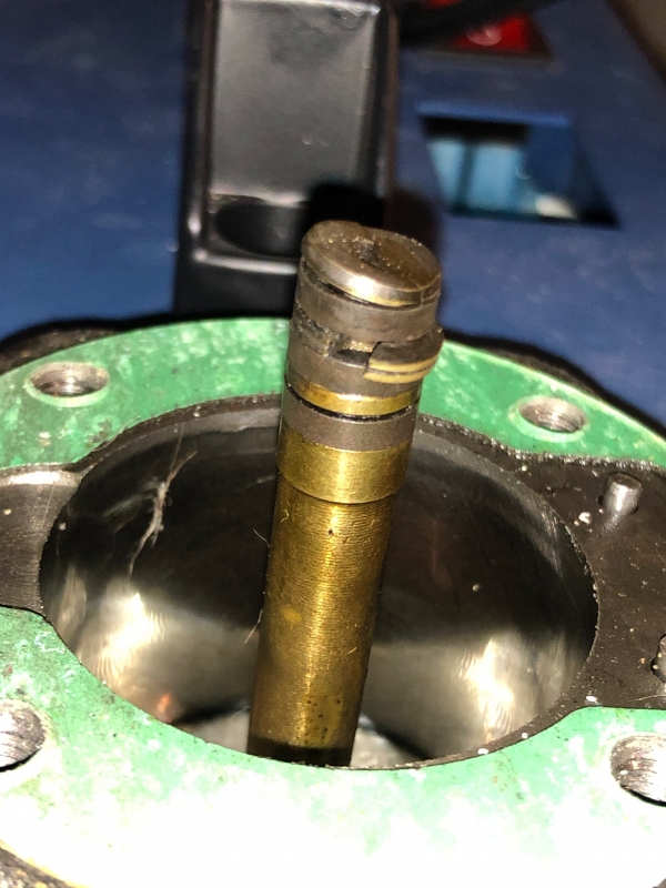

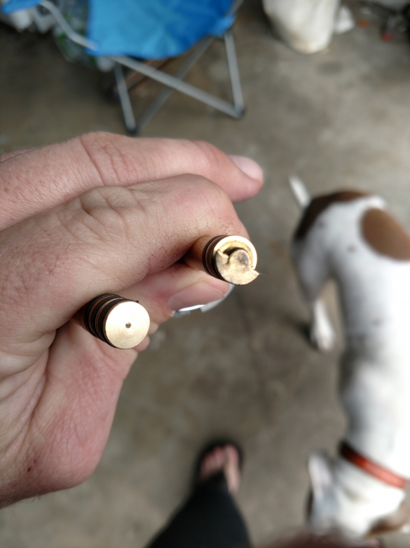

The following photos are from these threads showing how the piston broke :

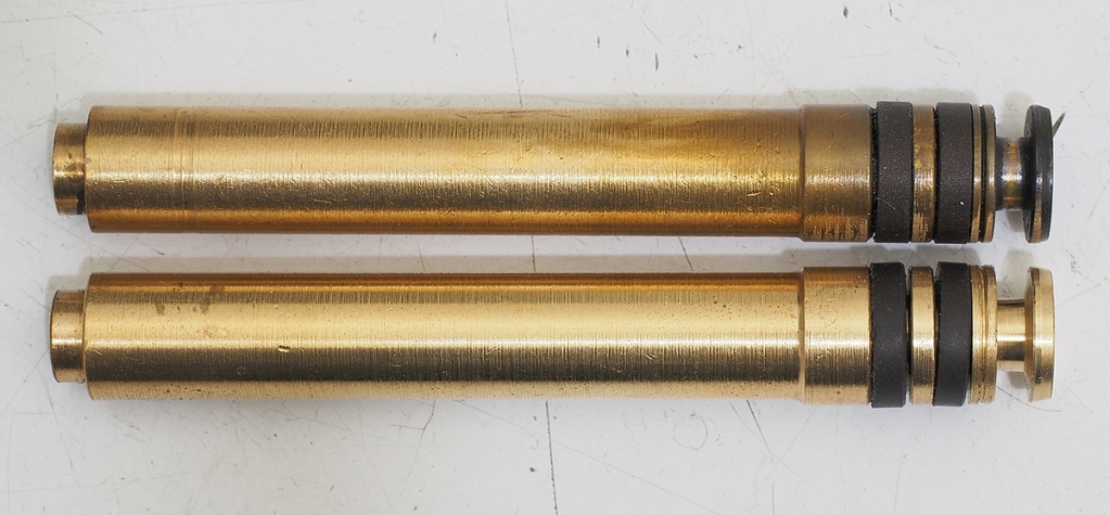

OK, finally got time to take out the old piston from my Yong Heng and do a side-by-side comparison. With the rings installed, there is no visible difference. The upper one in the photo is the old version, the new version is beneath it :

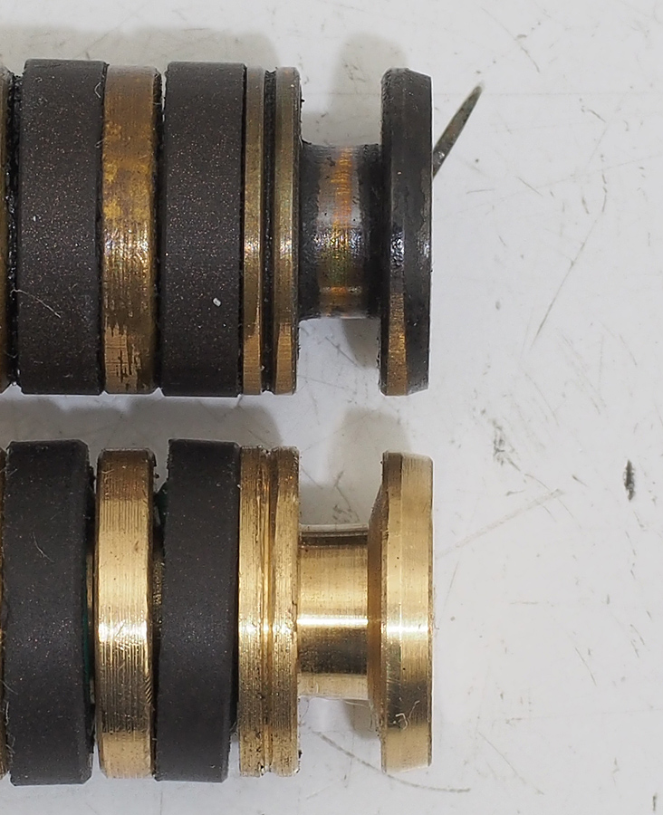

However, after removing the top ring, a major difference can be seen at the root of the top disc. There is a fillet making the root 25 ~ 30% thicker. They told me that the brass used in the new version is of better quality as well. Hopefully this will solve the problem for good.

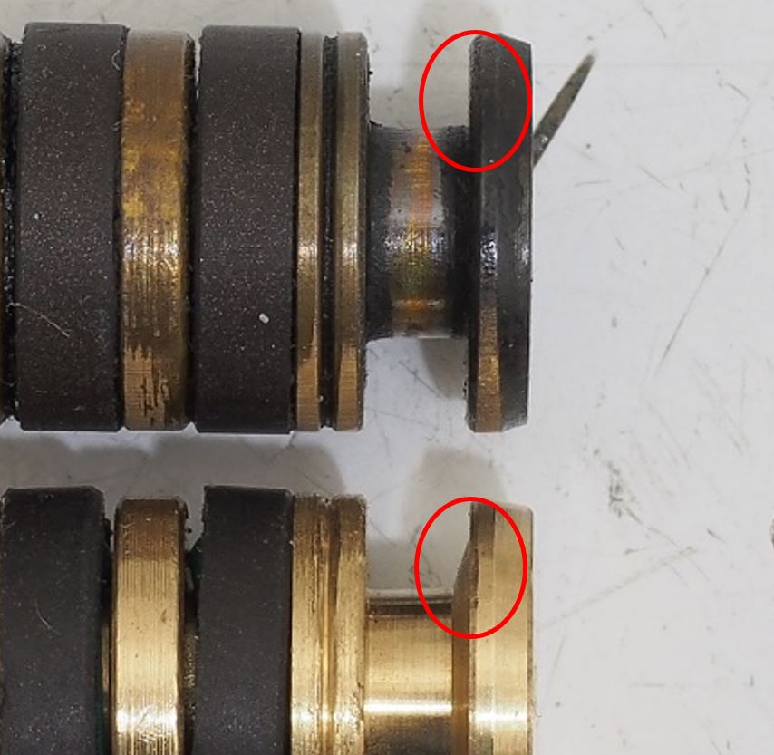

They both look the same to me. You said big difference. I don't see it. Can you measure it so we can actually see the big difference you are talking about?
I said ".... There is a fillet making the root 25 ~ 30% thicker ..." . I will leave it to you to judge whether this is big or not. If my salary is increased by this amount, I would say it's big :). Anyway, the Yong Heng people told me that they had received no further reports about the 2nd stage piston breaking after the new version was out.
Here is the difference in case you have missed it . Adding fillets at corners is a very common way to reduce stress concentration and enhance the strength of mechanical parts.
