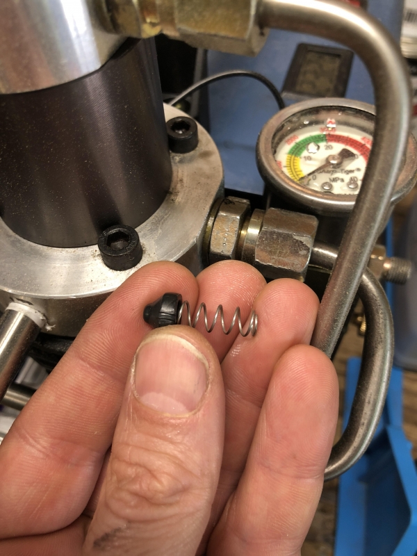

It’s sandwiched between the fitting you removed. Prfssrlee has a better more detailed explanation above. But I would recommend the Royal Purple Synthetic Compressor oil. Also, sometimes the check valves stick or gum up and don’t seal completely. Each cylinder has one on inlet and outlet. It’s very simple looking, small disc with spring.

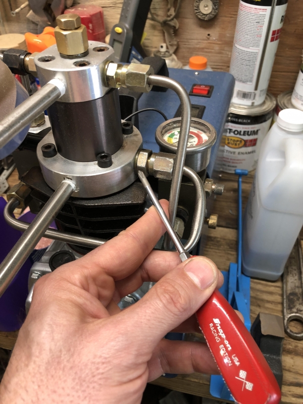

If you are dieseling your hydraulic fluid, then another good possibility is that some carbon has gotten into one of the check valves and is preventing it from sealing cleanly, as Centercut suggests. Pull it out and wipe it clean. For grins, tomorrow just take off the tube coming out of the top of the 2nd stage and look down there - you'll be looking at the top of a flap valve - see if you have any carbon deposit on it. On mine when I first took that fitting off, the carbon buildup had even worked its way up into the threads. If you've burned any oil, you can smell it too when you remove that fitting.

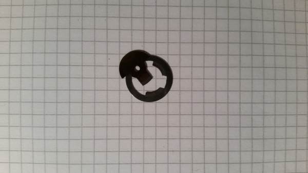

Broken flap valve in the 2-nd stage or build up of carbon in the two flap valves in the head of 2-nd stage is the issue ... Now Imsearching These flap valves , but Im not able to find it :-(
In the other thread that you posted this, I put a link to an Aliexpress store that was willing to pull off some specific parts to a YH and sell them. I sent a picture with redlines on it, and they just posted that picture, untouched, and sold me the parts. Here is another store I found that looks like they might do the same, as they have several single pieces and parts for YH compressors for sale that I haven't seen elsewhere (like the capacitor for the motor, the front cover for the crankcase, the oil breather, etc). You also might try them as it looks like they part out YH compressors for sale. The store name is Lj High Pressure Co. Here's the aliexpress link: https://www.aliexpress.com/store/2305020?spm=2114.10010108.100005.2.364d2be42xrri2

The 1st stage is the black cylinder with heat fins on it. The air exits out the steel tube coming out the side of the aluminum disc sitting on top of the black cylinder. It goes in the top of the smaller diameter aluminum cylinder, which is the 2nd stage. Also, the gasket between the 1st and 2nd stage is fairly robust - if you want to inspect your 2nd stage piston, just take off the steel tubes then remove the 4 socket head screws that hold the 2nd stage cylinder down to the 1st stage cylinder and life straight up to expose the 2nd stage piston and its semi-metallic rings. But that won't be the cause of an air leak.
