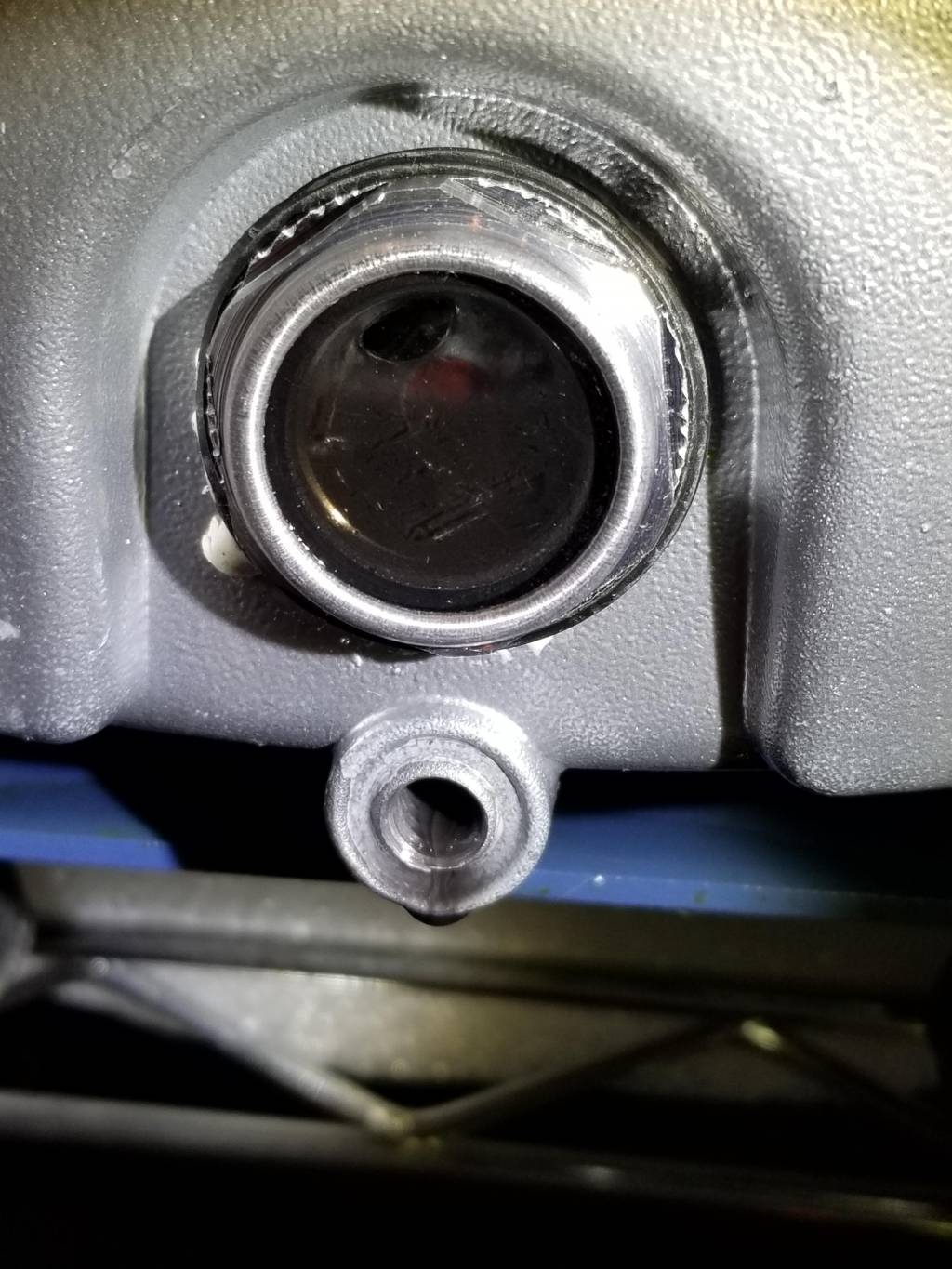

I started to change the oil in my Yong Heng today. I am switching from Royal Purple to Husky full synthetic oil. After draining the RP oil and flushing out the old residual oil with the new Husky oil - (Husky full synthetic is clear) - I noticed that the oil level sight window has a dirty oil film on it. Flushing with the new oil did not remove the film.
I would like to clean it. Has anyone removed the sight window? Is it threaded into the casing cap or is there a retaining nut on the inside? I could take the case end cap off but have read that the sealing gasket is a pain to get back in place.
I wouldn't get my knackers in a knot. A lot of modern oils have additives that make them cling to surfaces to aid lubrication for cold starts. If you let it sit for a while it will probably clear enough to be able to see through. It certainly doesn't require pulling apart for something so minor. It could be just the rubber baffle-gasket trapping a little oil between it and the window.
The cover gasket for the YH blocks most access for oil to easily move to the window due to what I see as "excess" material left on the gasket. It doesn't seal anything but blocks flow to the window. When I first got mine, I removed the cover to clean the inside and removed that section gasket that seals nothing but blocks oil moving to the window. It has worked fine that way for over 2 years now.

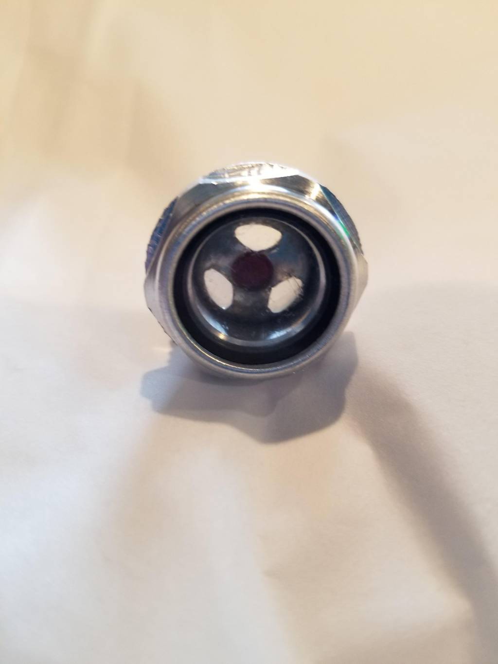

I let the compressor sit and the dirty film did not drain away. I decided to give the sight widow a test turn and it came right out. The sight window threads into the cover plate and is sealed by a rubber gasket and some thread compound. I filled it with some liquid dish soap, let it sit, then rinsed it out. Came out perfectly clean.
No squinting to see the oil level now and easy to tell if the oil is getting dirty. No pulling apart needed. It might be a minor thing but I'm going to do it every oil change.
