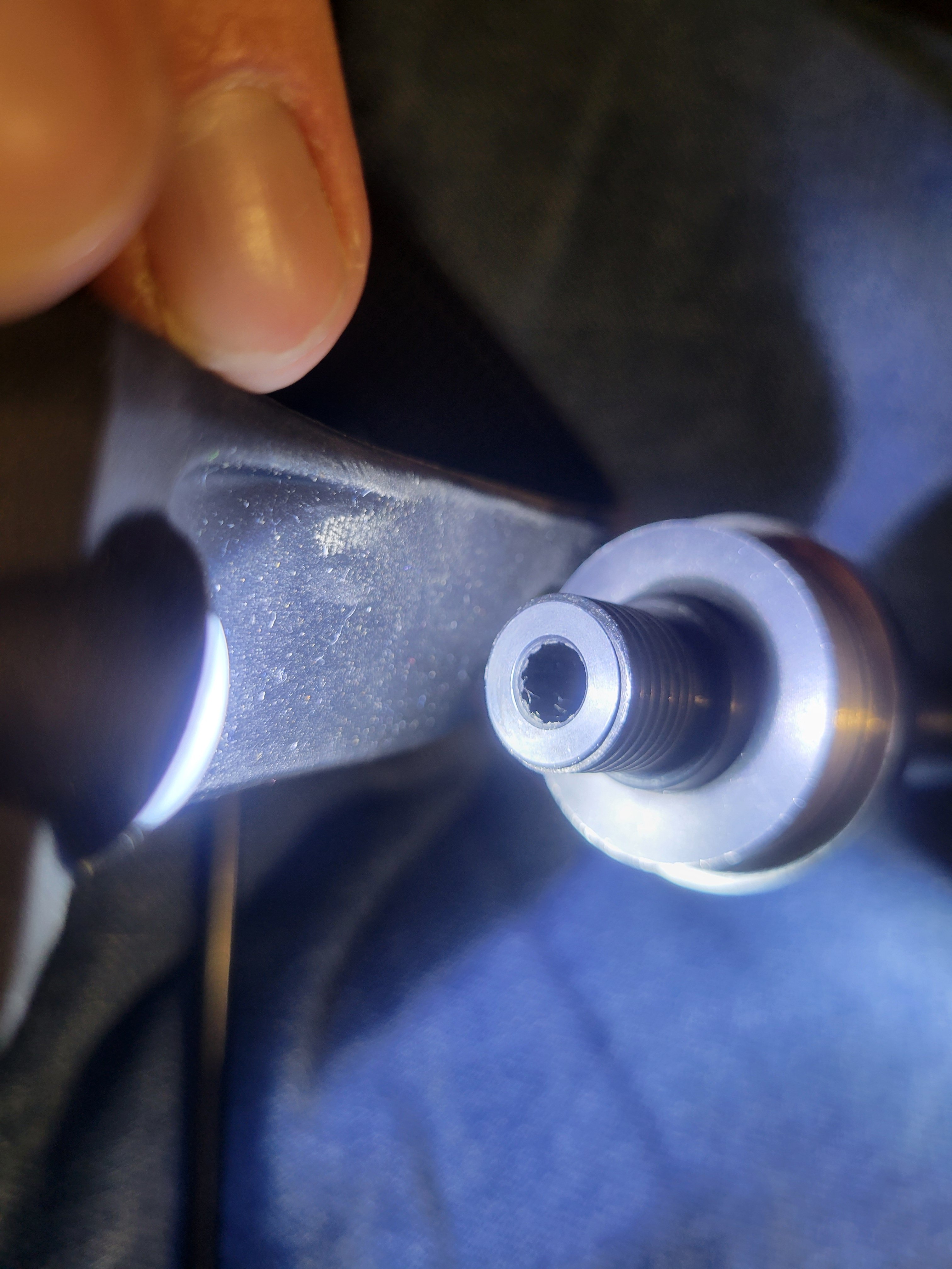

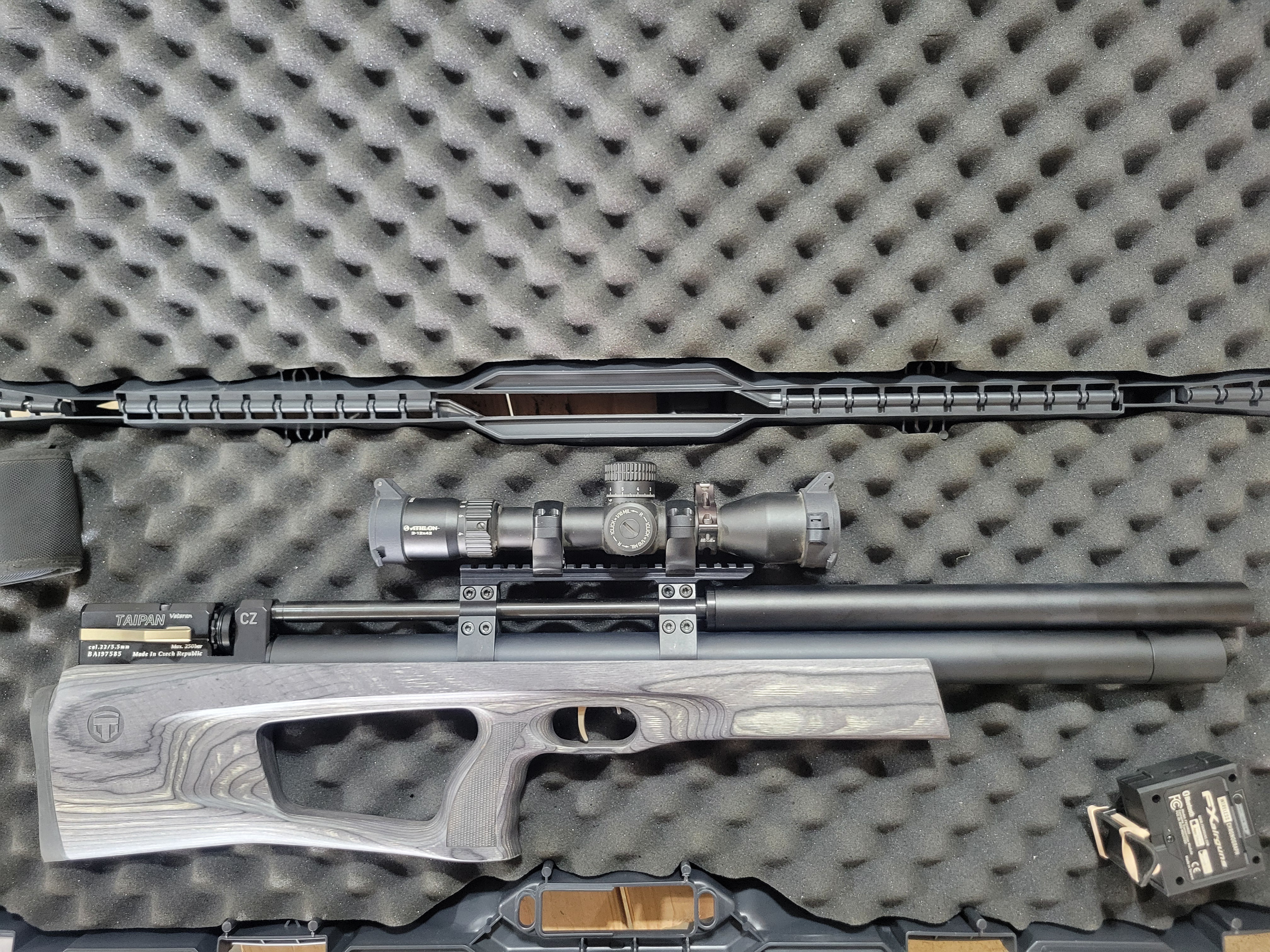

Picked up this used Taipan Veteran Long .22 for a good price a week back.

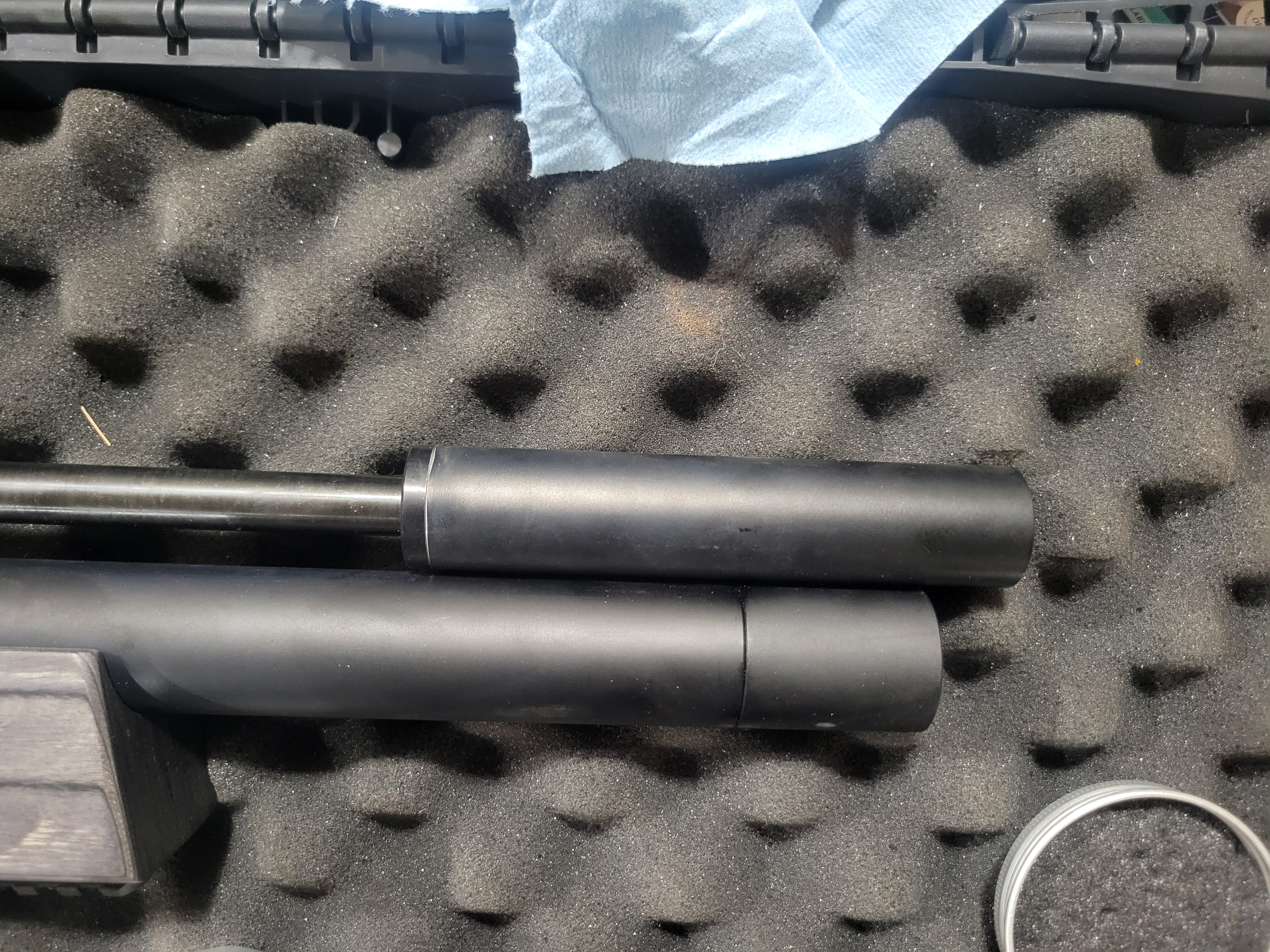

Had some issues with accuracy. First I noticed there was clipping, turns out the shroud was bent. Cut the shroud off and modified it to work as an LDC, no more clipping.
Thought cool problem solved. Nope still terrible accuracy and looks like spiraling. Pulled barrel and pushed a pellet through and wow terrible burrs at the crown.

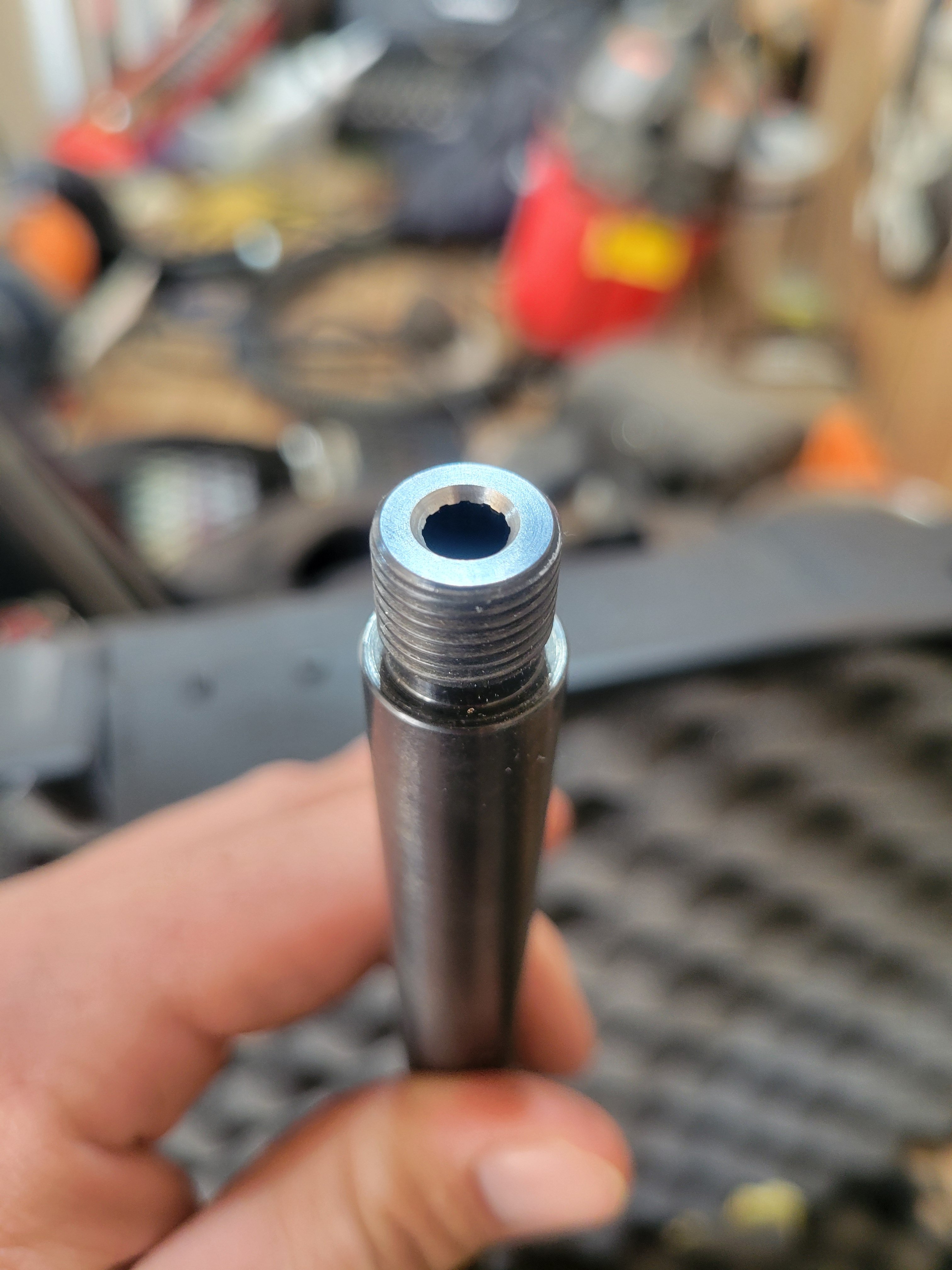

Got convinced to try out recrowning it myself instead of sending it out. Turns out it was well worth the effort and trying it!

After accuracy

that crown sure turned out nice, how did you fix it?

Nice job on the crown. Like the look with out the shroud, might do that to the Mutant.

Amazing work Dillon! I'm surprised you cleaned that up that nice with just the crowning trick. I for sure thought you'd need to use some small files to cut those burrs out of there. They looked so folded back
Thanks man! Trust me I was shocked also. It took me at least 15-20min of it actually on the barrel with at least 10 times changing it the polish. I did expect to try a pick or small file of some sort to try to do it but just kept at it and lucked put lol
