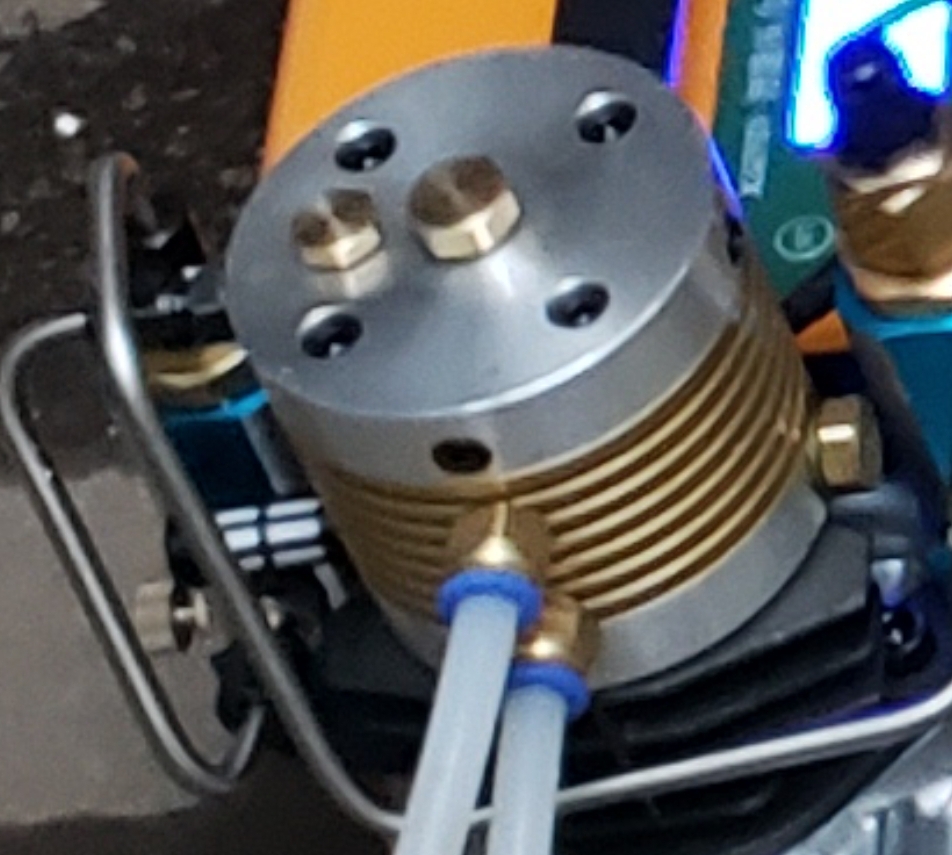

Here is a pic where you can see the intake filter in white

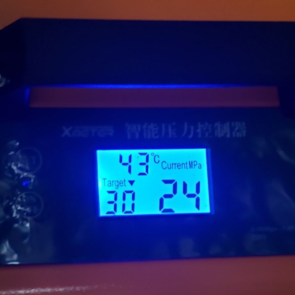

Digital display
All the noise come sfrom them using a sintered bronze intake filter. You can replace the filter with any other using 1/4 bsp or npt thread. Or use a hose barb to relocate the filter.
It's normal to feel air go both ways through the filter.
Thanks for the info, the filter on your compressor looks quite ordinary. How does it help to cut down the noise level ?
