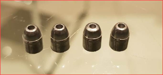

Take it for what it is worth. I bought the 30 cal die and have been making some but i think i really need to wait for the FX impact 30 cal slug liner. They measure right at 30 cal and while they fit in the pellet liner they feel tight. Little scared to pull the trigger since my MK 2 is like a month old.....LOL. He has a video out there to if you look up the company.
I ordered the .25 version they have as well which hasn't arrived yet with a .25 slug liner on the way. :) Will see shortly. They call out the 22 on his site, so i assume that is tested.
(Oh, customer service was freaking awesome though. My bottom part was hanging just a bit and he walked me through what to do but said dont worry was sending a replacement backup.)
On a side note i have a cutter like the on his site he points to but it wont fit the 30 cal lead wire. I figured out a few work around. He also sends some cutters as well. Still kind of new at this. I kept trying to nails exact weights consistently but i have started allowing like a .3% deviation just because it saves me a lot of work. Hoping the 25 wire fits through the hole and makes cutting consistent pieces easier. (I think it will just eyeballing the 30 cal lead) I push it on a 2 ton arbor press and that makes it very easy and slugs are beautiful. He recommends a .5 to 1 ton press, but obviously i have to overkill everything. Explains the FX Impact MKII, 4 barrels, multiple silencers & shrouds(Huggett and Donny FL), etc.

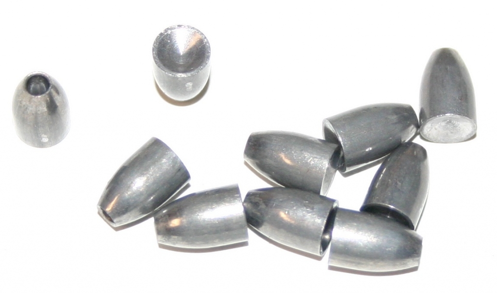

I have on order from Corbin (should be any day now), 2 sets of swaging dies for my competition Steyr, TM1000, and other guns. I'm getting 2 dies, both in .1755, which has been matched to my barrels. One will be 1/2 ogive, and the other will be 3/4 ogive. Both will have the capability of being a solid point, or a hollow point. With the hollowpoint, I'll be able to change the depth of the hollow cavity, thus being able to change the center of gravity for different weight pellets. I'll be able to make pellets from 8 grains on up with both designs.

I use Corbin Dies for .25 cal. slugs. I shared a video here on AGN shooting .25 cal. slugs at 173 yards, that still blows a can of water to shreds.
A 75 FPE .25 cal. gun shooting a "properly designed" 37gr. - 39gr. HP slug will destroy those Ground Squirrels out past 200 yards. DRT. with my slug gun.
I would recommend using the Corbin Press instead of a reloading press. Superior leverage for swaging. Only need to buy it once.
I would also slug the barrel of your gun that's on order, (once received) and send them to Dave at Corbins. If you go that way.

Cliff - If you choose Corbin, here's something that no one seems to talk much about slugs. Seat depth.
Once you have a press and dies, there's so many different bases and HP configurations to experiment with.
Took 3 different HP pin designs and a of experimenting before I got the "perfect one" in .25 cal.
I have 5 different bases and that gives me a lot of different options. Very important! In my opinion.
Slugs need to be set to just the right depth inside the barrel. Not deep enough can be very accurate with crazy flyers.
Too deep. I mean if you feel resistance closing the bolt because it is forcing the slug past it's ideal depth. Terrible accuracy.
I've personally never had anything shoot accurately that was a "force fit" when closing the bolt in my guns. Even pellets.
My 2 slug only guns bolts close with almost no feel of the slug.
PCP's don't have an adjustable bolt for depth.
So the different bases can give you more options for the length / weight to get the right fit.
I just thought this might be some info. to think about as you decide what you want.

BINGO ! -  I think that it's far more important than most of us are aware. Someone just posted Bullet Jump here recently. They were thinking the same thing.
A feel that a lot of people getting poor groups out of certain slugs they try may have this small non-adjustable issue working against them.
I was considering making an adjustable bolt for my Cricket .25 built, so I could dial in the right slug OAL to bolt leade in relationship.
Instead I chose to make slugs 1/10th of a grain at a time, until I got the groups @ 42 yards I was looking for.
My barrel had a leade in cut for a 37gr. Rat Sniper slug I had at the time.
Surprise, the 38.1gr. slug I make is the most accurate and the same OAL and ogive as the R.S. slug.
All barrels are different. It seems to be very important with slugs in my barrels.
A cupped base slug isn't necessary, by the way. Lots of flat base slugs out there.
I have a very slight cup base slug. Mostly for the pin style of bolt probe to center the slug into the bore straight.
