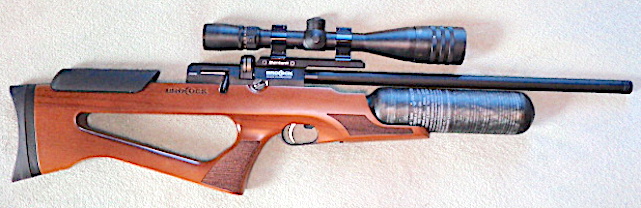

I have this Slingshot-system .22 Brocock Bantam HiLite Beech-
Having had too many problems with too many regulated PCPs, the Slingshot system was largely why I chose the Bantam I did. That it has exceeded all my hopes and expectations is why it is my go-to gun, and is shot more than any my others.
