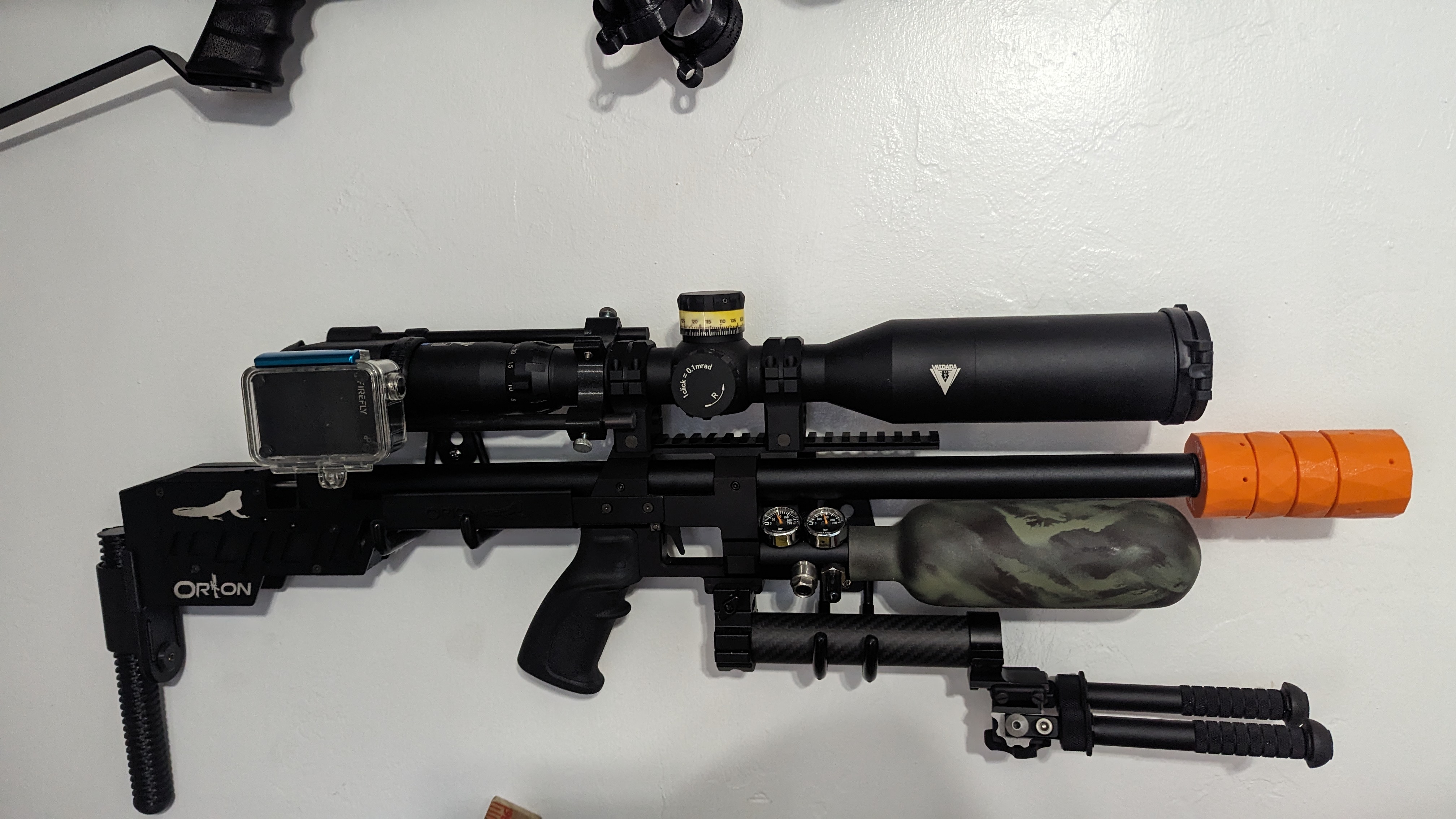

This is the bottle I'm using

The 0.3L bottle
You can just order 1 bottle from them
