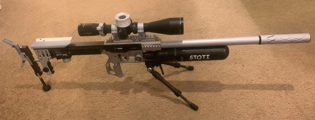

Set up for a lefty! I hear what you're saying Fuss, about the cocking lever. I love being a lefty and having a right hand cocking lever. Just makes sense to cock with your non-trigger finger hand! The adjustable LH cheek rest is great too. Keeps my cheek/jaw off the large magazine and gives proper eye alignment!
MKII 33.95 JSB's like a laser beam @ 930fps
Still waiting for my 700mm slug liner.

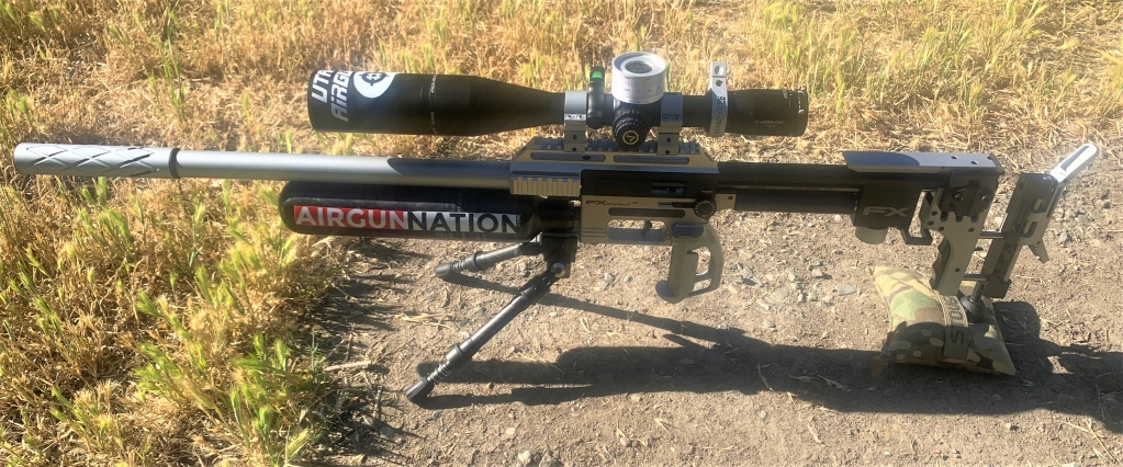

Here's the other side to show my AGN and UA pride!
TSP and FUSS--- if you buy the Kraford and Lypt stock, you won't need the metal bag rider that you are asking about, but of course that's up to you. The rear mono pod leg on the stock has a ball that rests on the rear bag, I just use my hand to squeeze the bag for small vertical adjustments. It works great. Kraford and Lypt is also going to make a bag rider of some sort to replace the ball in the future. When? I don't know. They're pretty busy right now...stocks, cheek rests, trigger guards, etc...

Best looking and most functional looking Impact I've seen!
Thank you! I loved my Crown and I love shooting my boy's Brocock and Streamline but this gun is a whole different level. I was going to have Ernest power it up a bit. but at 930fps with the 33.95 MKII's and my reg. set to 140BAR, I've got plenty of power to shoot effectively out to 200yds. When testing it, I had the reg. set to 150BAR and everything maxed out, I could get 980-990FPS with the 33.95's. That's smokin' for a stock gun! We'll see what slugs shoot best. I'm hoping the 32.8gr VK slugs shoot well like they did with my 600mm slug liner. If so, I'll have more than enough power for my needs.
