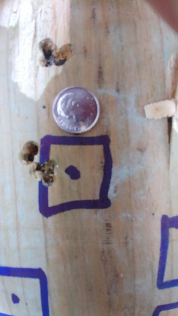

I guess every gun/barrel is different, my Bobcat Mk2 shoots JSB Kings "lights out" on high or low power, 925/660 fps, low power groups just dead low a few inches, I never changed factory settings and I never will, The best freehand group I ever shot in my life (sitting) was shot with my Bobcat Mk2 .25 on low power. The groups pictured is high/low power from sitting position at 48yds. Group on bottom is high power, (more than 5 shots) top group is on low power 5 shots. The distance between these group is NOT the POI difference, left is up, I didn't plan to post these groups, 15 clicks is about the difference but no L/R shift, call it four inches..
