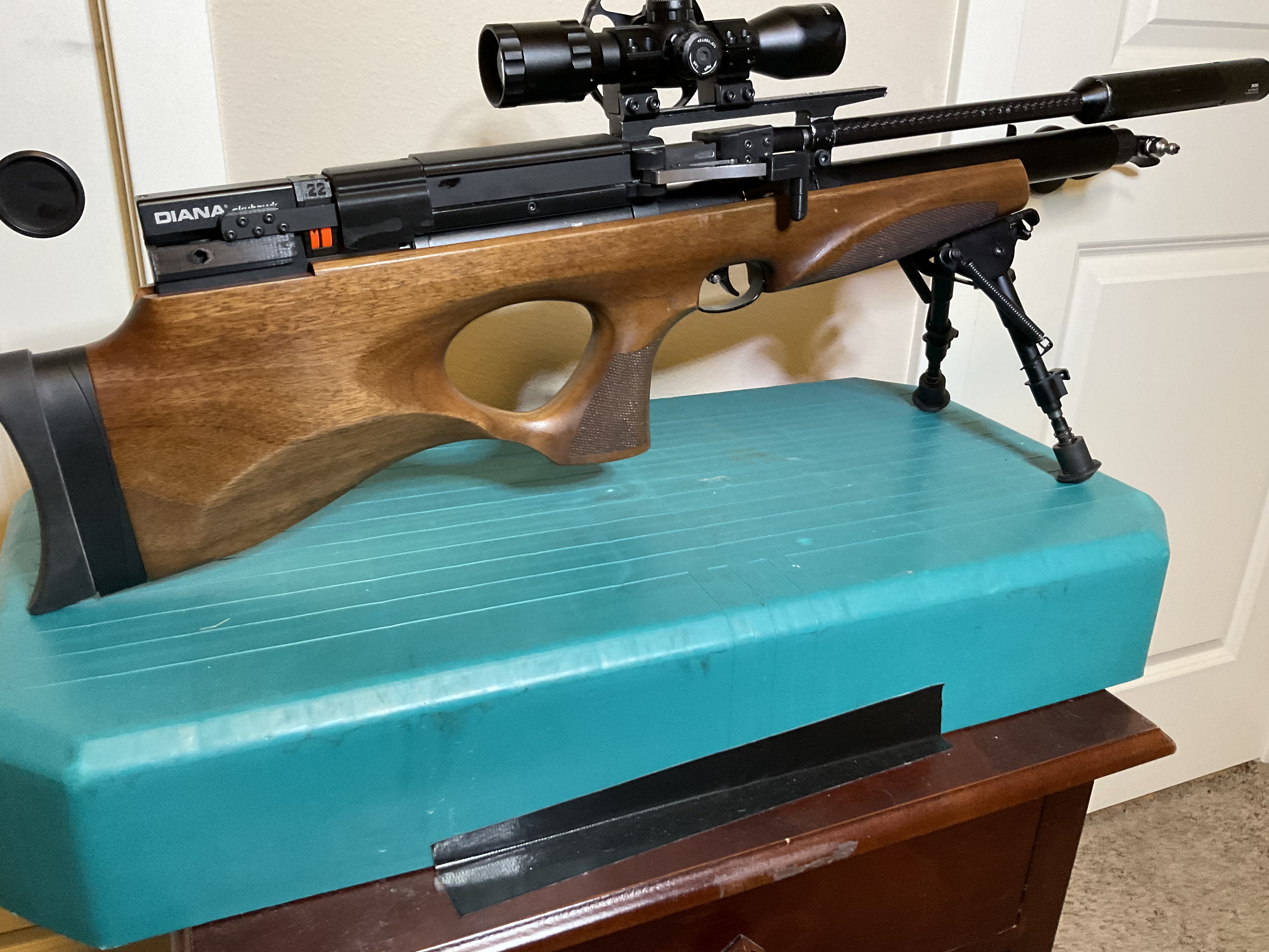

Now that I can get parts and I have installed John Bowmans side lever, I am “reloving” my Skyhawk.
My 22 is extremely accurate, but it has a replacement barrel. The first had a tight spot in front of the lead that was a deathnell. The new barrel now is a 20” LWpc.
Reengeneting the fill assembly simplified life greatly also, no more sweating about removing the fill assembly to replace that oring on that Ill designed assembly.
