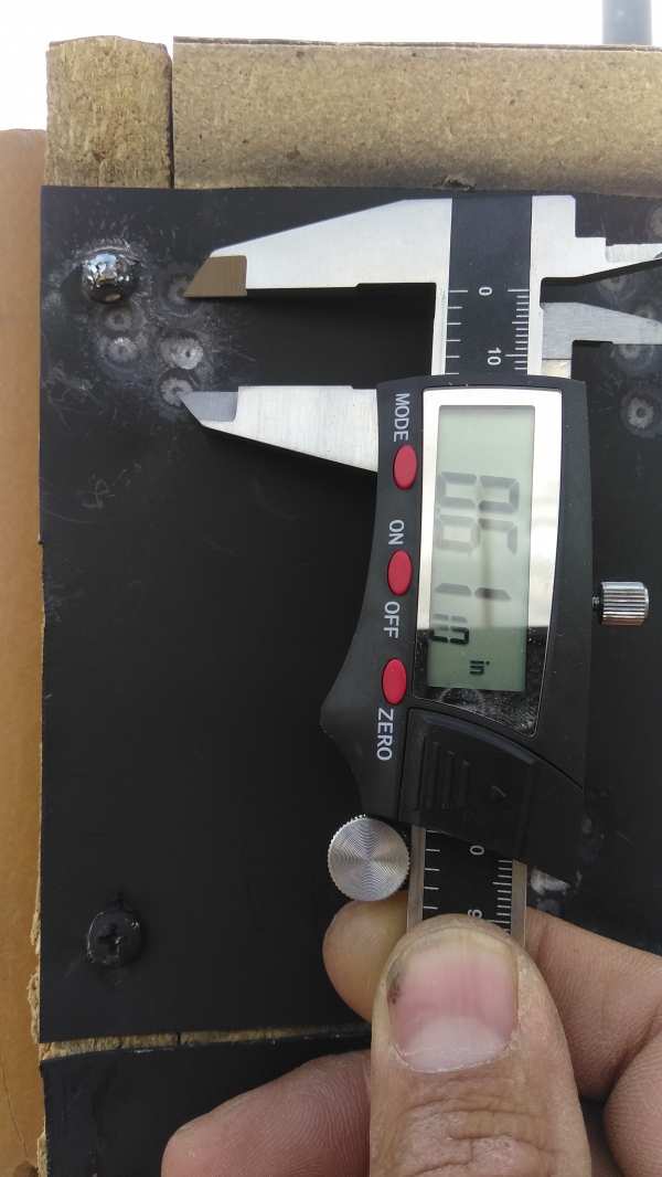

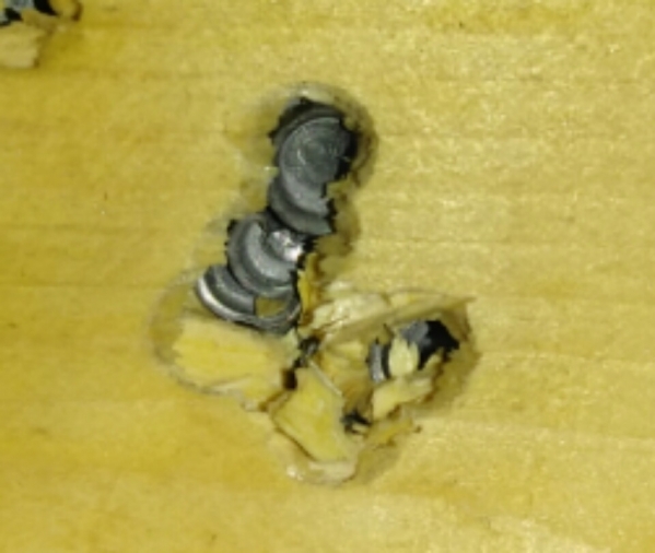

Just an update on my Terrus, just installed a new spring an piston seal from vortek, and.... What a difference, I also did some work on the pistin, and now I know how it feels shooting a accurate rifle, getting thight groups.
