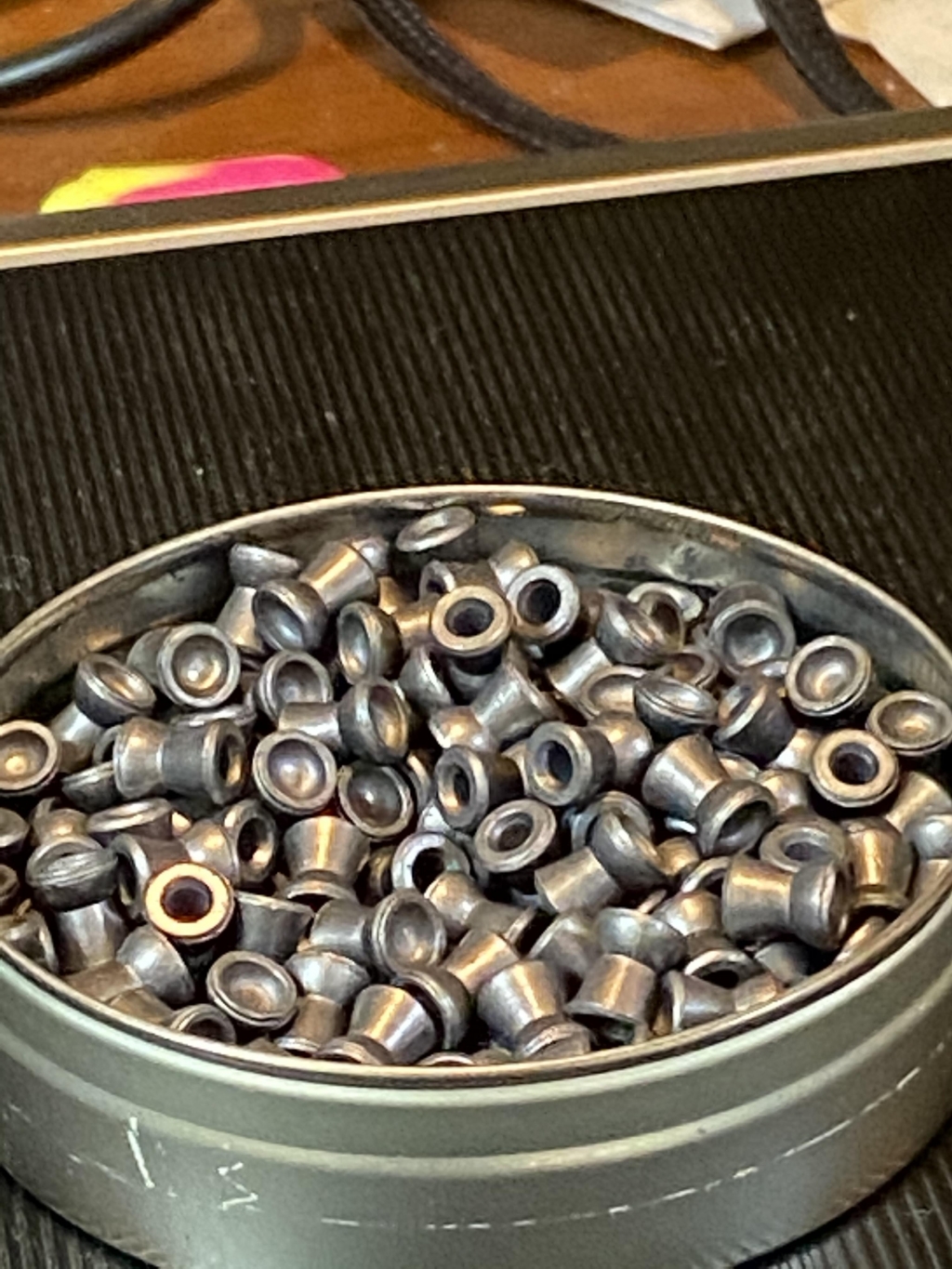

Vortek is an top notch Airgun tuner Company That’s been manufacturing their own products for a long time And I’ve been using the products for at least 27 years Maybe even more . The very first product I bought from Vortec Was a two piece moderator then short time later got the Vortec gas ram Break barrel patriot/Kodiak . Once a shot a PCP It was over for the break barrel on with AR6 hunting master with a custom long barrel and the power to break the sound barrier. Pellets don’t fly the best at that speed but at 30Yards or less most of my Shots and the lamprey what is my top choice

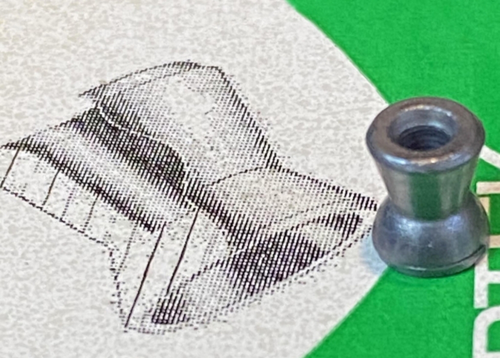

Flying Ashtray – The Vortek Lamprey Super Hollow Head
This must be a remarkable pellet. Read on:

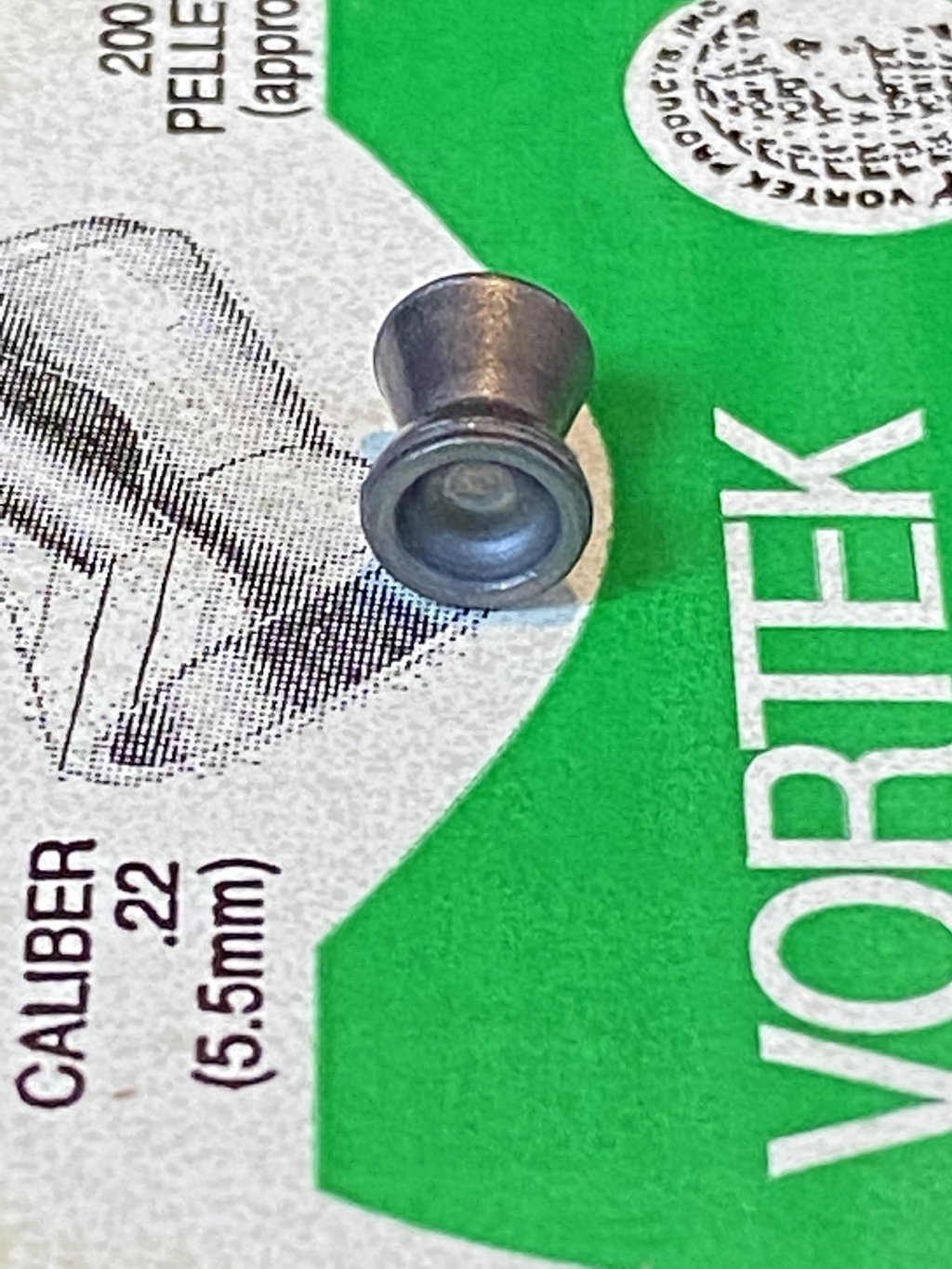

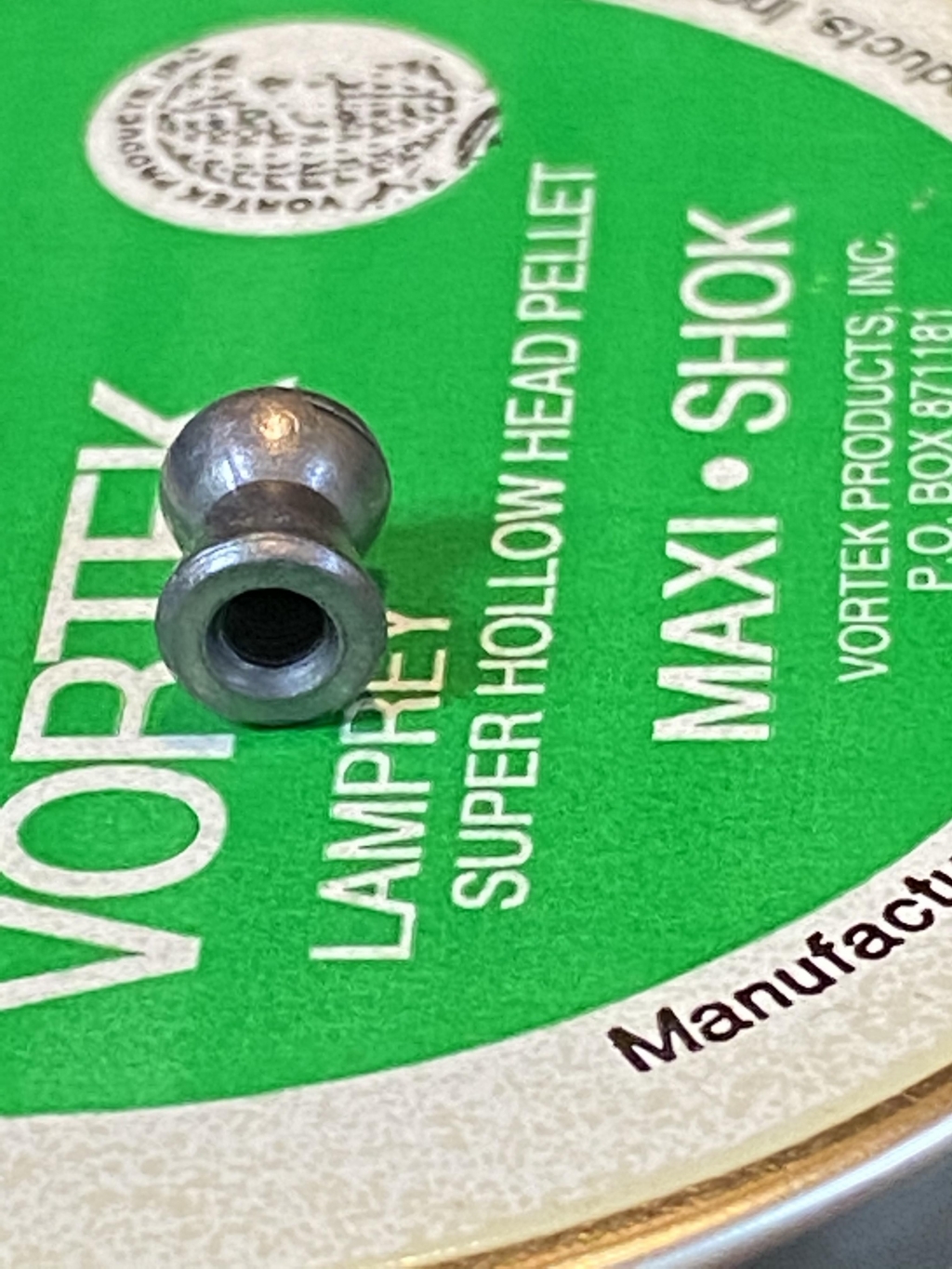

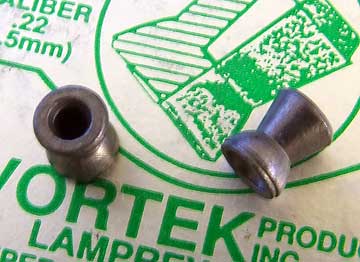

It is “a wide-open hollowpoint that hits its target in an attitude that’s ready to expand dramatically. There used to be a pellet made that way, and very curiously, it resembled a diabolo pellet loaded backwards – hence the title of today’s post. I’m referring to the Vortek Lamprey.
The Lamprey has a huge mouth (Vortek called it a hollow head pellet), like its namesake, and a tiny shallow skirt. It seems wrong to load it the right way – as though the maker somehow reversed the directions.
Yet, it’s reasonably accurate and is one of the few hollowpoint pellets that performs well at slower speed.
The walls of the hollowpoint are thick, but this is a pure lead pellet, so it mushrooms well and holds together even better.”
